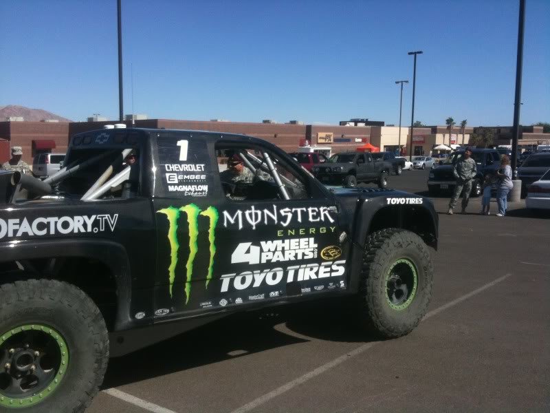

    This is the fastest truck on earth, and on 39's it's lower than my taco in the background on 33's. IMG_0052_a5ef6f154a883a6d7a41d40784a159c37d22d560.jpg
    There is nothing wrong with a 3" lift done right with coilovers and deavers, and any 6" will be fine for most street/show guys just keep in mind it will be more expensive in the long run for maintenance and you won't get as much resale out of a 6" lifted truck.

    SICK! Ft. Irwin?

    Yeah he stopped by and took some soldiers for a ride around the tank test track. Didn't get much vid, I was driving most of the time.
