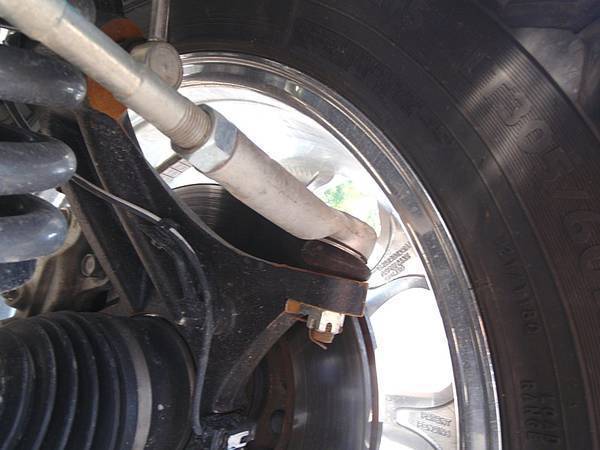

  12. Apr 29, 2009 at 10:59 AM
    SuperD
    SuperD Mall Cruiser Pilot
    Dec 26, 2008
    #11923
    153
    Texas
    '09 White TRD Sport DC LB 4x4
    ProComp 6" Stage II, 18x9 Moto Metal 955's, Cooper Discoverer STT 305/60R18, K&N FIPK, Go-Rhino Stainless side steps, Redline Elite hood struts, Magnaflow muffler, Delta Alum. Toolbox, Husky Liners F/R, Window tint
    The problem lies in the fact that they made changes to the spindle for the '09 to accommodate the VSC. I asked ProComp about running 17's w/spacers and they told me it would be iffy. Of course this was after I had already ordered 17's, because this info was not available on the internet, and I was scrambling to find some way out of my delima without having to reorder everything.
    So, my advice is to order 18" wheels if they decide to go with this kit for the '09. If they want to risk going the 17 w/spacer route, best of luck.
