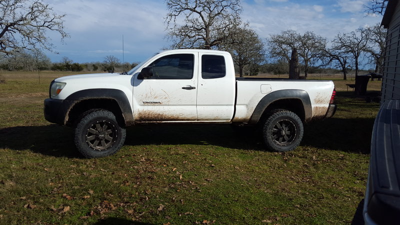

    Im running 4" lift with 35's!

    Note: I do rub when I turn tight so 6" with 35's would have probably been more ideal.

    There are plenty of guys running 35s with around 2 inches of lift. You could do it without any lift, but back on topic...
    A friend runs 35s with a 6" DB lift. He still had to :sawzall: the cab mount and some other stuff to stop the horrendous rubbing.

    Yeah I have to cut on my 4" so doesn't surprise me you'd have to cut on 6" also.
