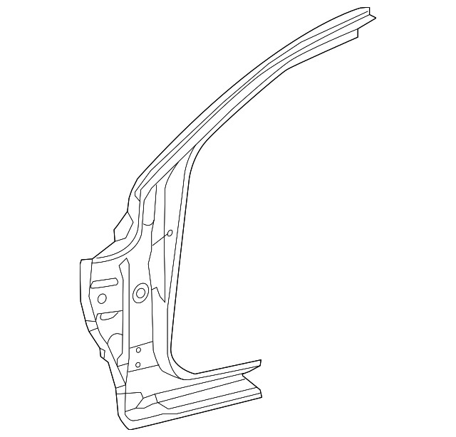

    Looks to be a pretty big piece encompassing the A-pillar, door hinge frame, and portion of the doorsill. By the time you drill out all the spot welds from a salvage yard truck, the part will probably be like swiss cheese: https://toyotaparts.mcgeorgetoyota.com/oem-parts/toyota-hinge-pillar-6113104061
    And sure enough "Country of origin JAPAN"
    Can't see how this part could be irreparably damaged from the collision though. Dented door sill should just be pulled out on a rack and smoothed out with bondo. Replacing that whole pillar is very invasive.

    It's the type of steel. They are using more and more high strength steel in vehicles for crashworthyness. HSS cannot be bent back into shape, and must be replaced to retain the structural integrity. Mfg design in sectioning points where body shops can cut the old, and put in new.

    Good explanation there on HSS. The difference is mostly down to carbon content - when you increase carbon content you increase strength, typically at the expense of malleability.

    Interesting information! 980 MPa = 142 ksi, getting up there in steel heat treatment. SAE grade 8 bolts are 150 ksi for reference. I'd still do it if it were my truck (I have sliders), but yeah a shop going by the book would have to replace that section.

    The stamping lines making this part are probably working overtime to feed Toyota's OEM production, so not much gets diverted to spares.
