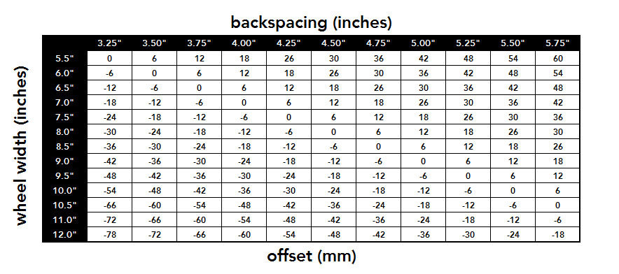

    I think, if I am reading the back spacing chart correctly, the 17x9 would stick out 3/4" more than the 17x8?

    This might be helpful
