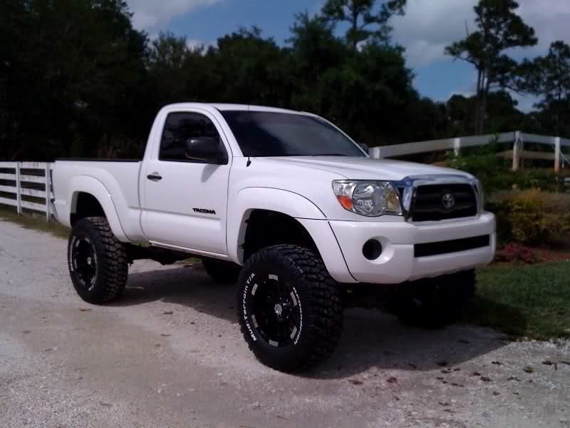

    Suspension: -Bilistien 5100's all around -Add a leaf -Firestone ride rite air bags Performance: -K&N cold air -Borla cat back Stereo: -Pioneer AVH-X2500BT head unit -Kenwood 1400 shallow mount 12'' sub in custom box -Alpine 1100 amp -Alpine 400 4 channel -4 energy component 6.5's Wheels/tires: -17x9 with 4.5 backspacing XD hoss rims with 33'' bfTreadwright gaurd dogs and spidertrax spacers Looks: -Satoshi grille made by myself -Hood, front bumper, grille, roof, tailgate and rear bumper plasti-dipped. -BHLM -eyelids -matted out tailights -Tacoma bed mat Small mods : -Trailer 7 pin replaced and moved into bumper beside licence plate -Removed mud flaps -Repainted frame/lower a-arms, skid and rear diff/housing with por15 -Led bulbs -Interior lights replaced with blue led's -Beep on lock added
    I have a 6 inch lift and am selling the truck and rebuilding one with a 3 inch.
    6 = too much wear and tear. if its your dd stick with a 3''

    that regular cab looks the part for sure! but to run a 6 inch on our 4 cylinders you must regear that chick is running 35's on the stock 4.11 gears:eek: that thing must get 10 mpg and be slow as molasses lolz
