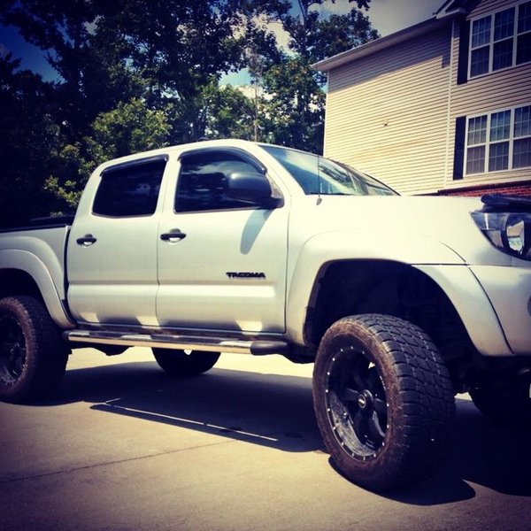

    Looks good! Happy with the ride?

    Yea rides good to me

    What size terra grapplers are those it's hard to tell in pics looks good I'm thinking of getting a set of Terra's for mine these damn coopers are so heavy I'm runnin the 325

    I was looking at this too because i don't do crazy off-roading just camping etc.. as your daily driver did you notice a big difference in the turning radius or how the truck rides compared to stock, especially with the blocks? I was gonna go with a 3" billstein coilover lift but i'm re-considering now.
    Last questions, did you get any new vibes by lifting it and did you put in the diff drop kit + new UCA's?

    I just used what the kit came with , no extra ordered parts for lift, rides good to me, having 20" rims I feel more of the bumps and all but with my 17" rims I had before it rode same , also turning radias has been fine , I took off mud flaps, will have to trine a lil but not much and it's a spot u don't see much anyway but only rubs if turn sharp down hill ect, also I have 305/55/20 terra grapplers , I have had say before and hated them and they didnt last long ,

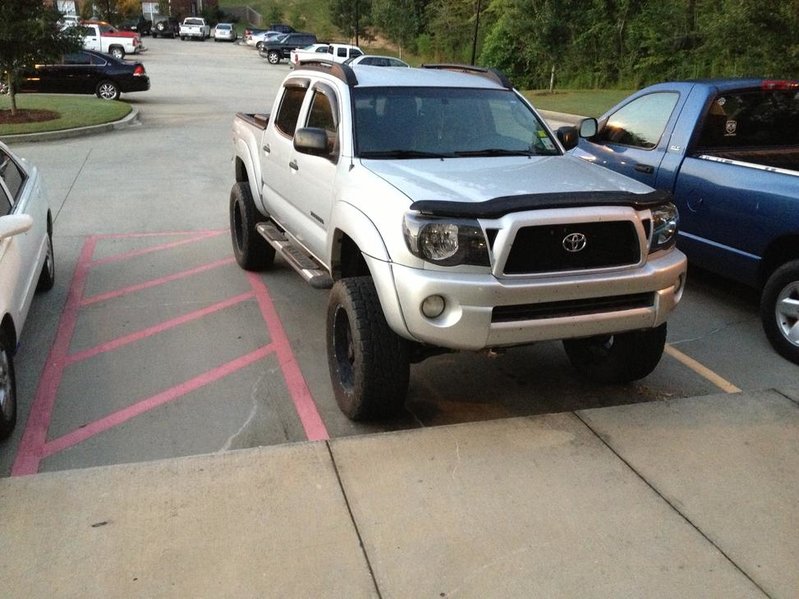

    Another veiw

    Another one
