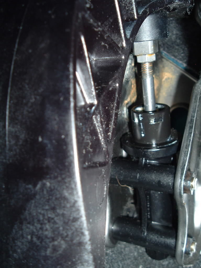

    there is a quick fix for the squeaky clutch pedal.

    I've had no issues other than the squeak that I've just gotten used to at this point. I tried WD-40 on the clutch pedal and it worked for a while but the squeak came back.
