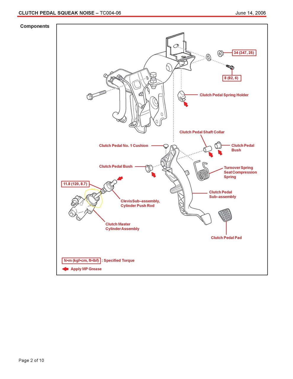

    Mine also had this so i greased the pushrod yesterday and now its as quiet as a church mouse. Its underneath the pedal and its a silver rod that goes into the floor of the truck. The silence is wonderful now. You may give this a try

    Attached is a picture of the area circled in yellow where I liberally greased the pushrod, and then proceeded to push the clutch in and out multiple times (with the truck off). Then I would apply more grease. I got in and out of the truck probably ten times to get more grease after pushing it in and out ten times or so. It was really dry to say the least, and it fixed my pedal problem. Mine was getting really annoying though where it would make a bad creak when pushing in and releasing the clutch. I finally gave in and did something about it. BTW, just for reference, my 6spd only has 37k miles on it. It didn't do it when I first purchased the truck at 24k miles, but over the last 13k, its gotten progressively worse. Hoping this can help someone out that is going crazy from the clutch pedal creak. Also, I used Super Lube grease like total chaos upper control arm poly bushings call for in case anyone is wondering. It's a clear looking grease

    I have been using lithium grease spray on various areas and the squeak will go away for a about a month and then come back. I think I will try this. Thanks for the info.

    I did this to mine last week and it's nice and quiet now. Time will tell how long it lasts. I also hosed down the pivot point of the clutch pedal up under the dash with some lubricating oil. Other than some unusual contortion, it wasn't too bad to do. I also turned the push rod about a quarter of a turn. I read on another post here to do that.
