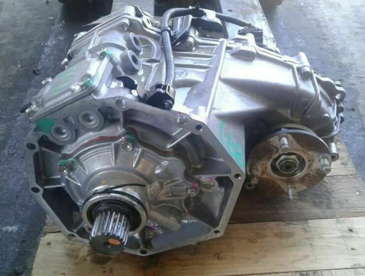

    I'll be diving into my transmission very soon to address a few issues and to possibly switch out the necessary components to get the FJcruisers' .799 OD.

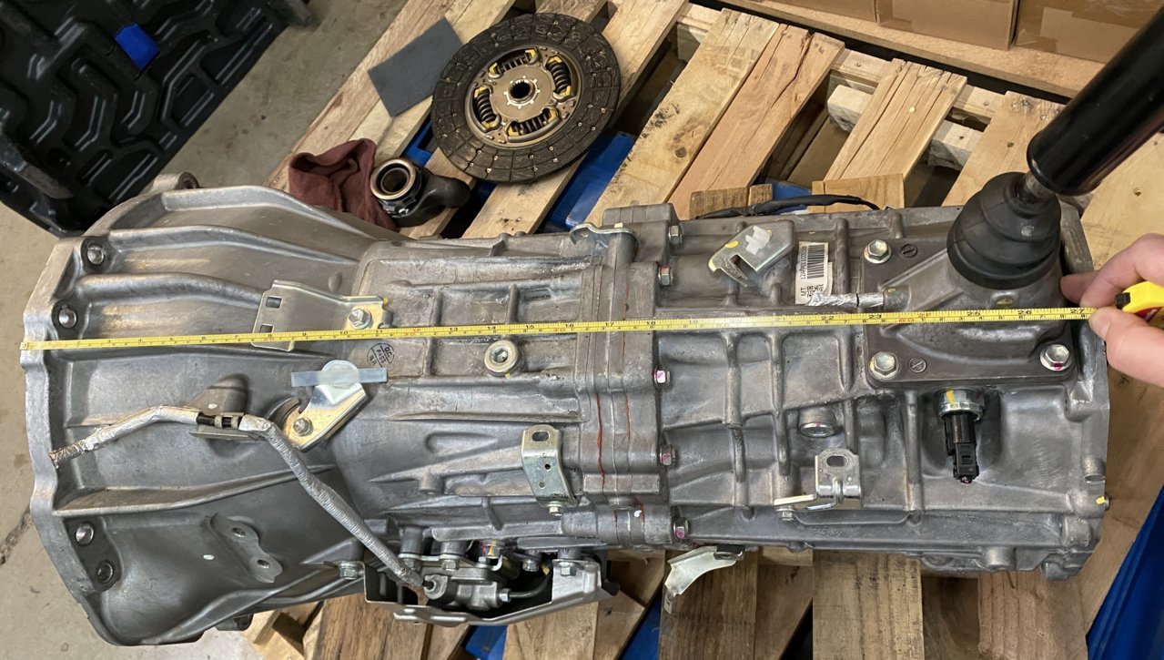

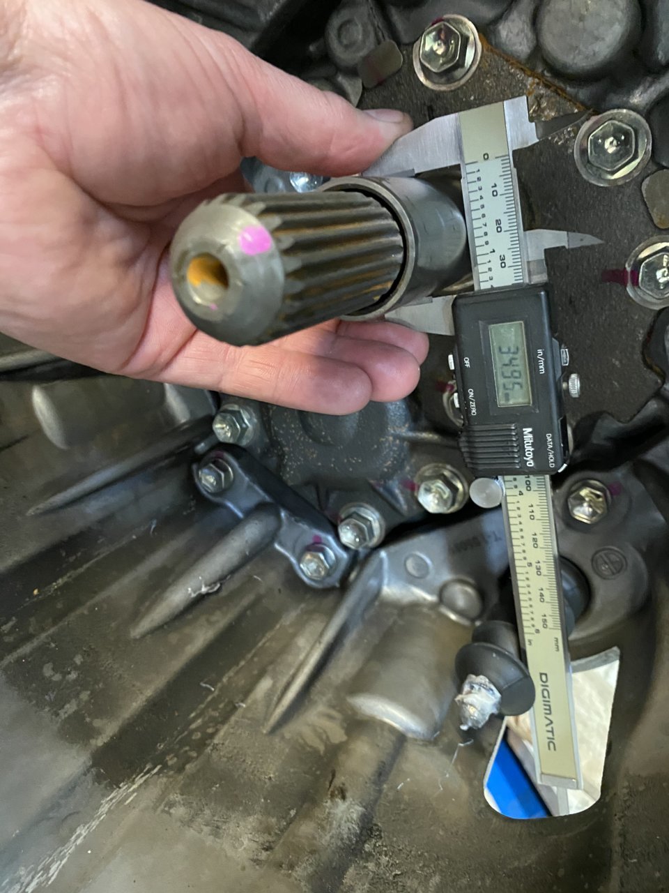

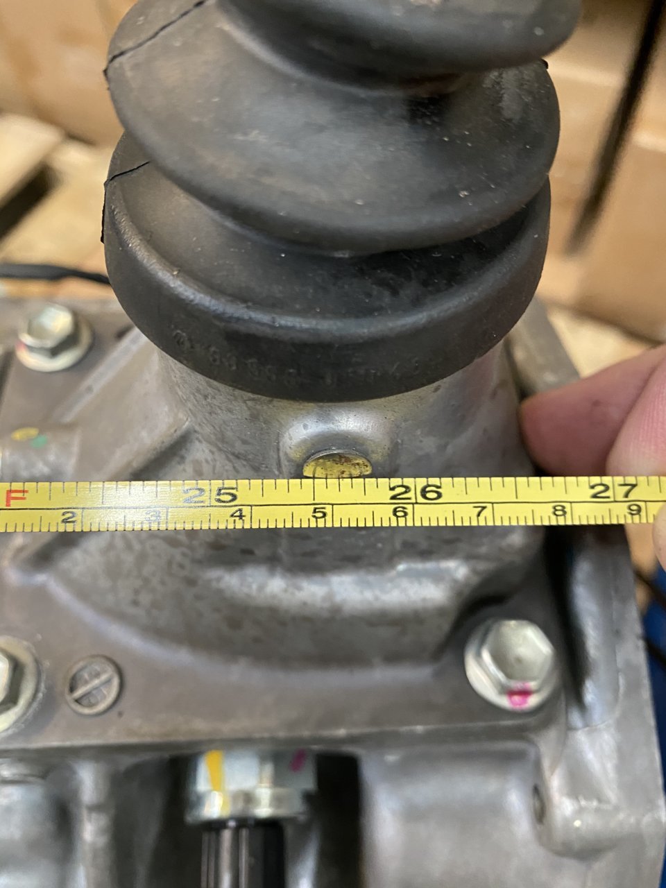

    These are just some rudimentary measurements of the RC62F

    So, at this point, I’m still open to all ideas. I’ve heard of T56 swaps. But I’m not positive that I can retain my 4wd with that setup. Maybe @Torspd can chime in here.
    I’m also very much liking the RC62F ratios. I’ve always felt this truck needs “another gear” beyond sixth. And I am constantly finding myself skipping gears during normal driving.

    Edit: So, it does in fact appear that this trans is compatible with the 2nd gen transfer case. Win.
    I’m also pretty dang sure that it’ll bolt directly to the engine no problem. Being that they’re the same RWD GR engine family. Does anyone have any insight on this transmission going into a 2nd gen?

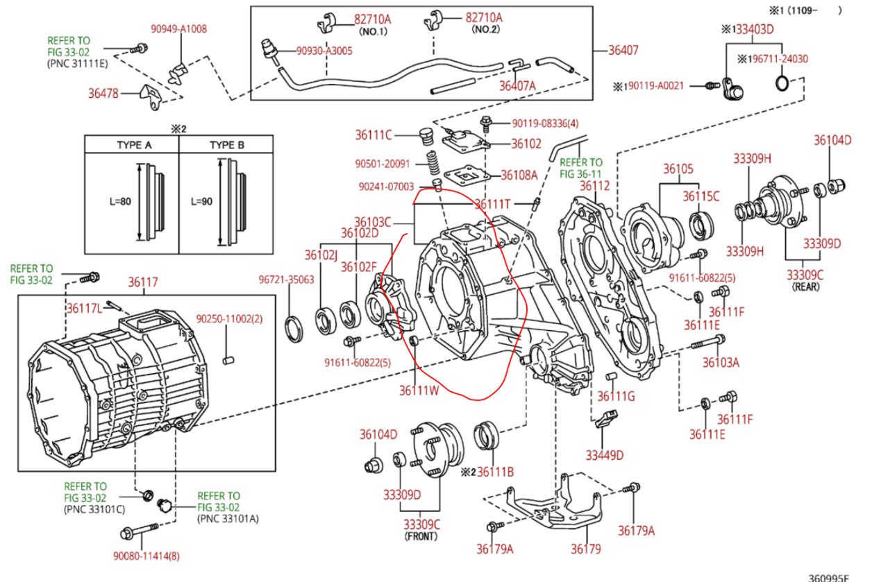

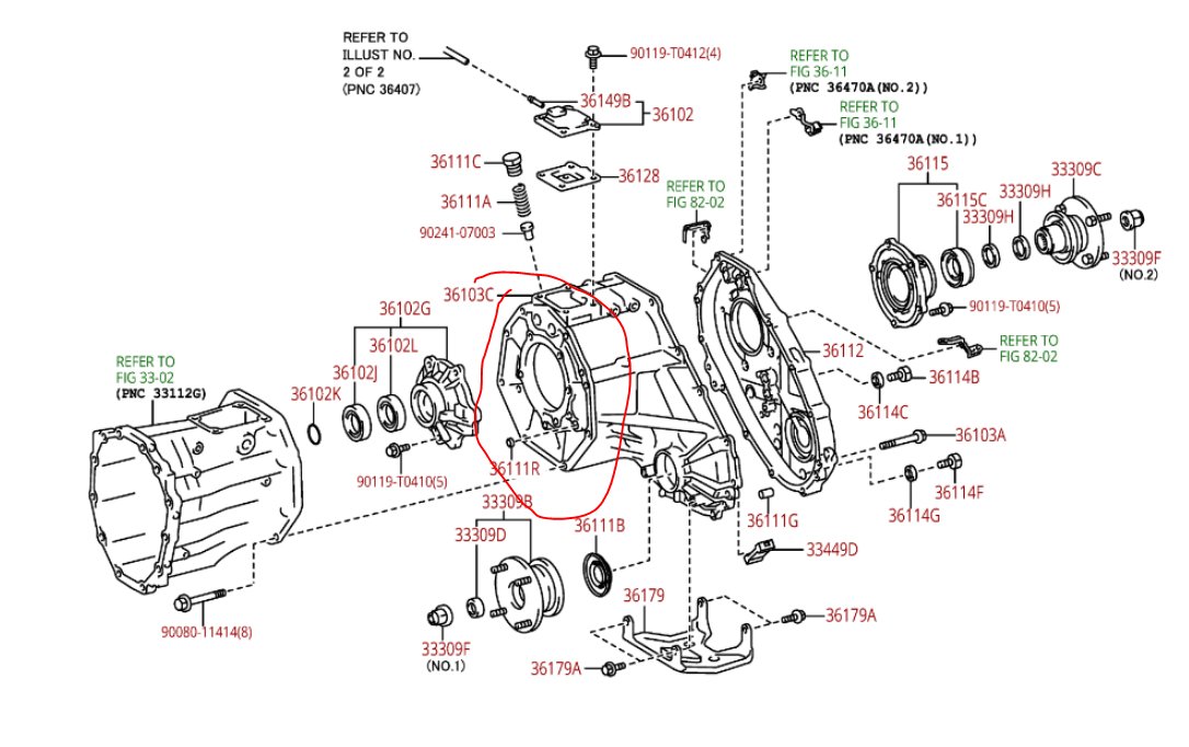

    I could be wrong here. But, by the looks of things, the transfer case may just swap!
    3rd gen
    2nd gen
    If that is truly the case, then I'm seriously thinking of ditching this tranny completely in lieu of the RC62F.

    it should. pretty sure people have put a fj case into a 3rd gen
