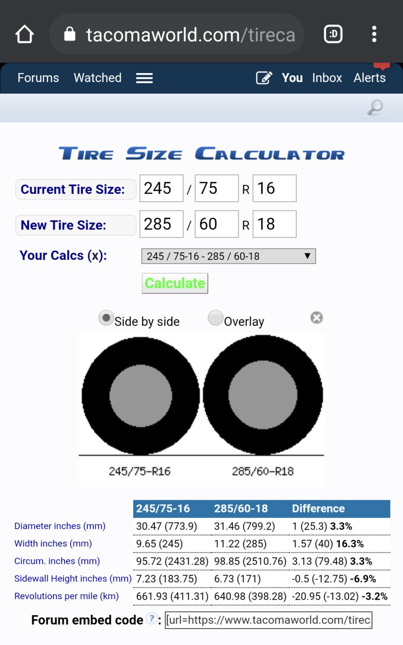

    That's a wide 31"
    https://www.tacomaworld.com/tirecalc
    The tire calc is actually how I found TW long before I had a Taco, I had a little B.S. Auto-X car.

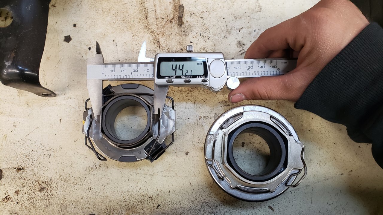

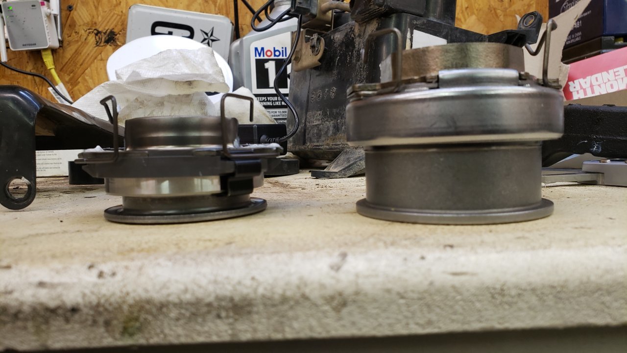

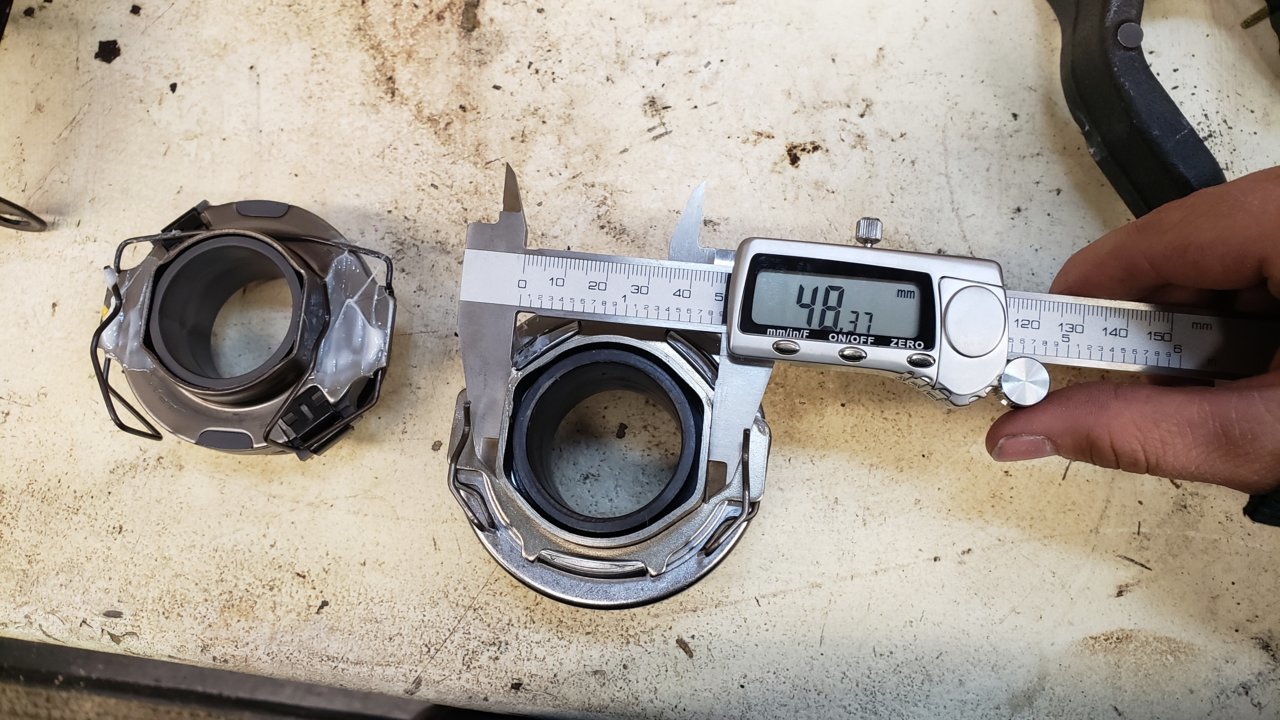

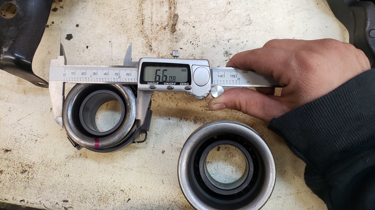

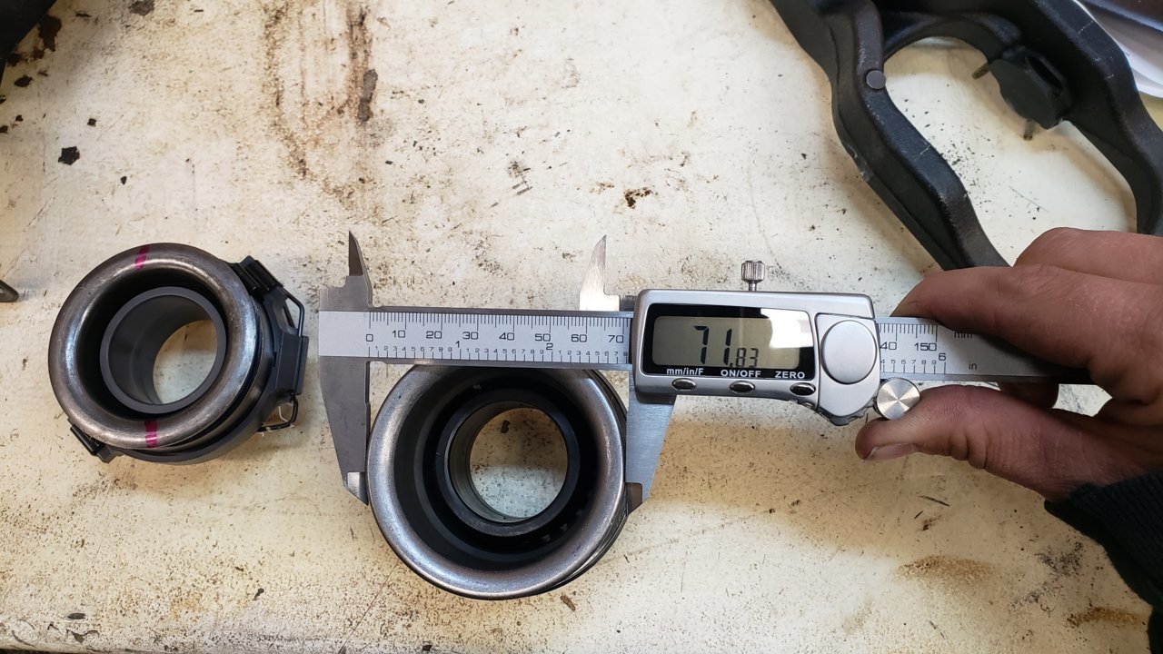

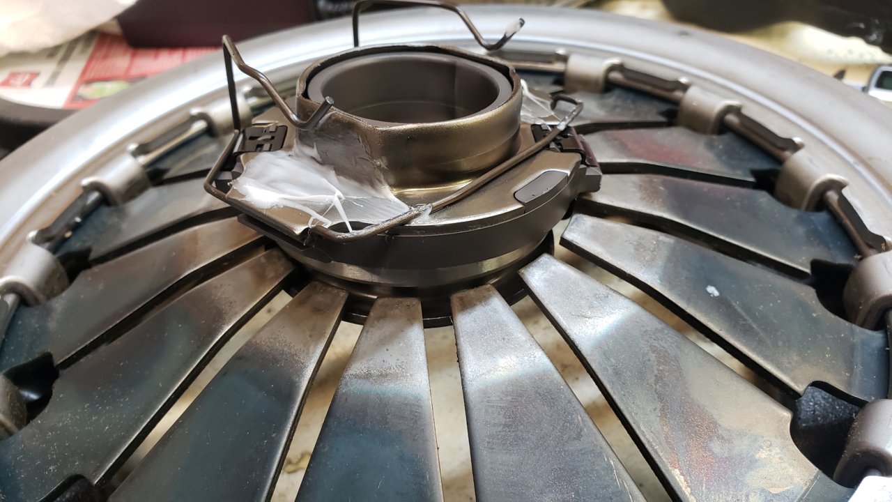

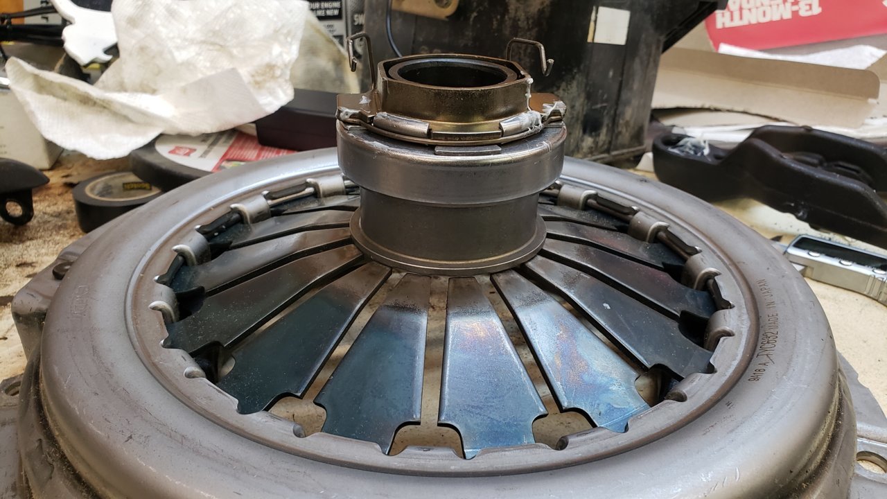

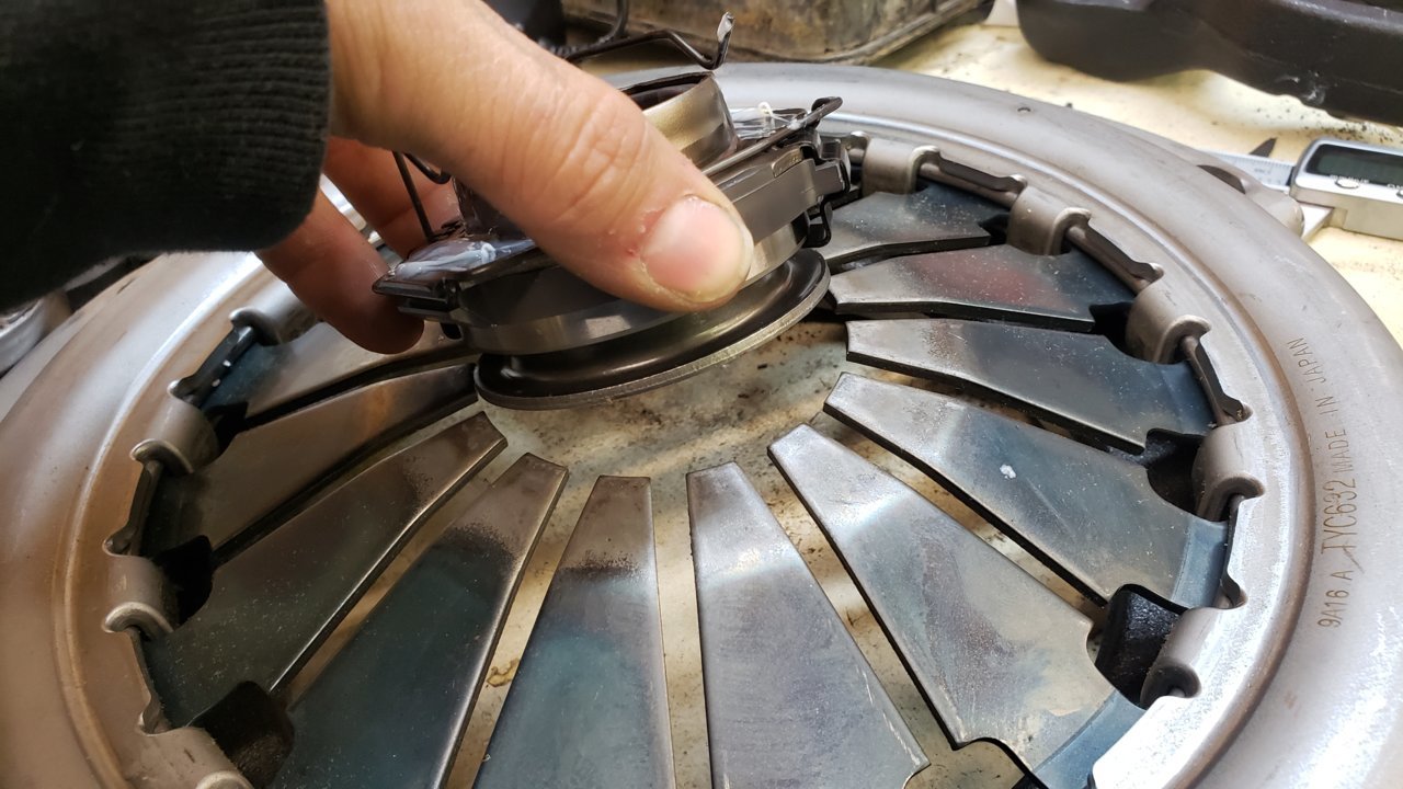

    So I don't think it has been clearly addressed yet as to what combination of clutch parts is needed to achieve a traditional style clutch with this swap. I have my rc62f now with the throwout bearing and fork, as well as a 2nd gen clutch kit for the 1GR-FE. The rc62f throwout bearing does not engage on the 1gr pressure plate, it is too small and does not touch any of the fingers(see picture). The ra60f throwout bearing obviously does work on the pressure plate, but will not slide on the fork for the rc62f. They are also different in the depth of the "spacer" on the bearing. I took pictures and measurements to help add to the general information on this swap, but does anyone know the right combination to get it to work? Is a 3rd gen pressure plate the answer? will it bolt to the flywheel?
    rc62f where it goes on the fork
    ra60f where it goes on the fork
    difference in bearing height
    rc62f pressure plate side
    ra60f pressure plate side
    ra60f bearing on 1GR pressure plate
    rc62f bearing on 1GR pressure plate

    @ster56 You will need the Third gen pressure plate with the third gen release bearing. It will work with the second gen flywheel and friction disk. That is what I have on my set up. I thought that was discussed in here when I went through the same thing?
