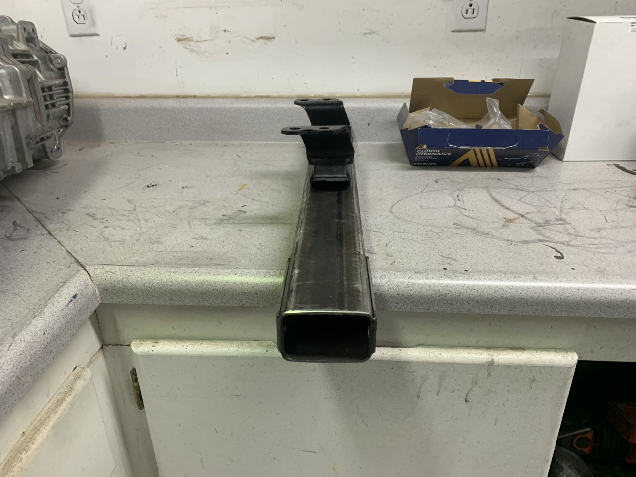

    Would have been nice to know about using the auto trans mount when i did my conversions years ago. That really is a nice gem of info.

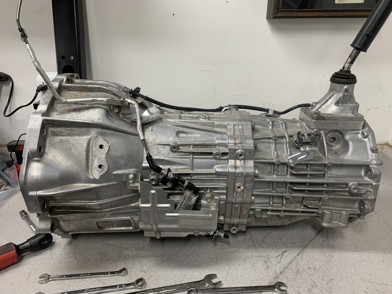

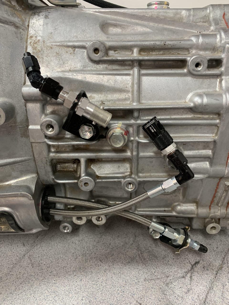

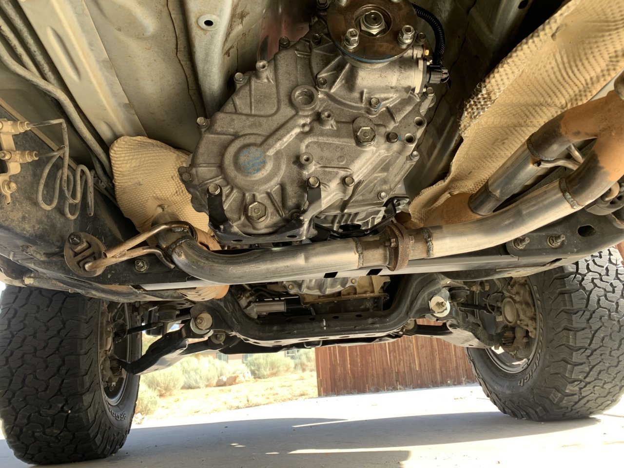

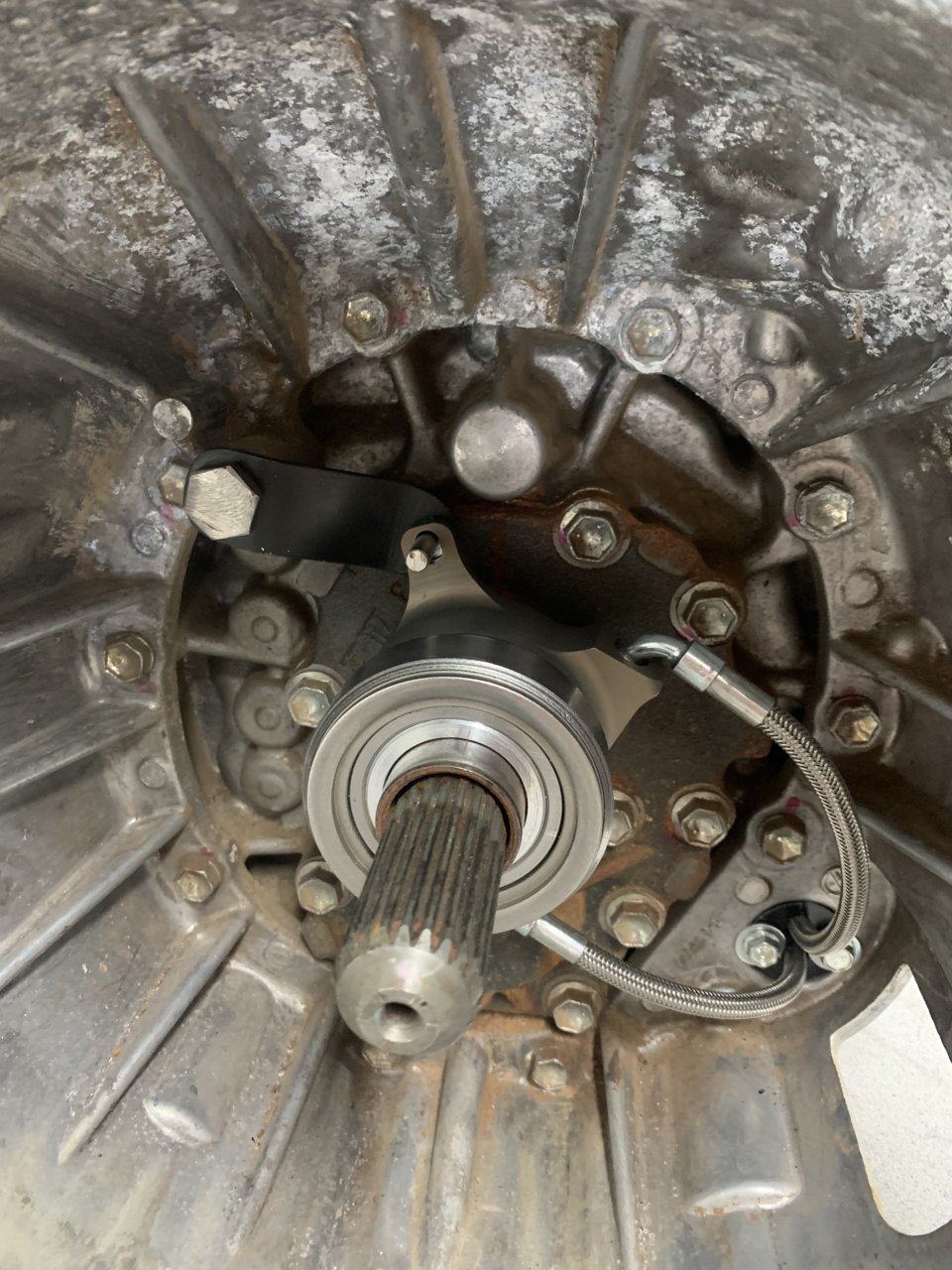

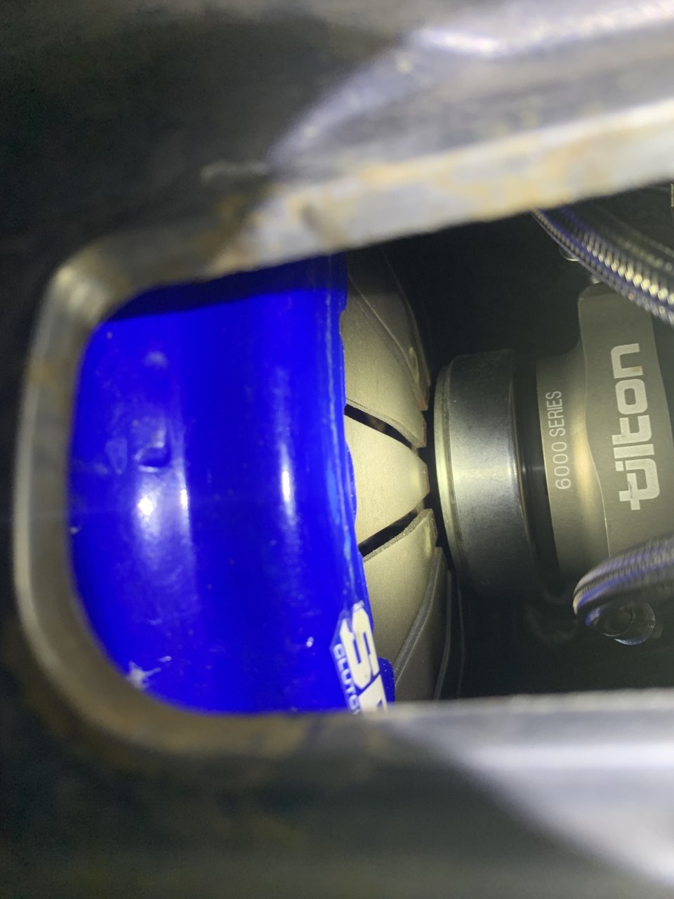

    What fittings did you use for your Tilton t/o bearing on the side of the case? Looks like a clean install.

    when you ask what fittings I used are you asking the manufacturer, size, or type?

    I guess all... they look like some nice quick disconnect fittings.

    The quick disconnect fitting is made by Aero Flow. It is a AN -3 male x AN -3 male bulkhead fitting.
    The other fittings are Earls AN -3 fitting of various types.

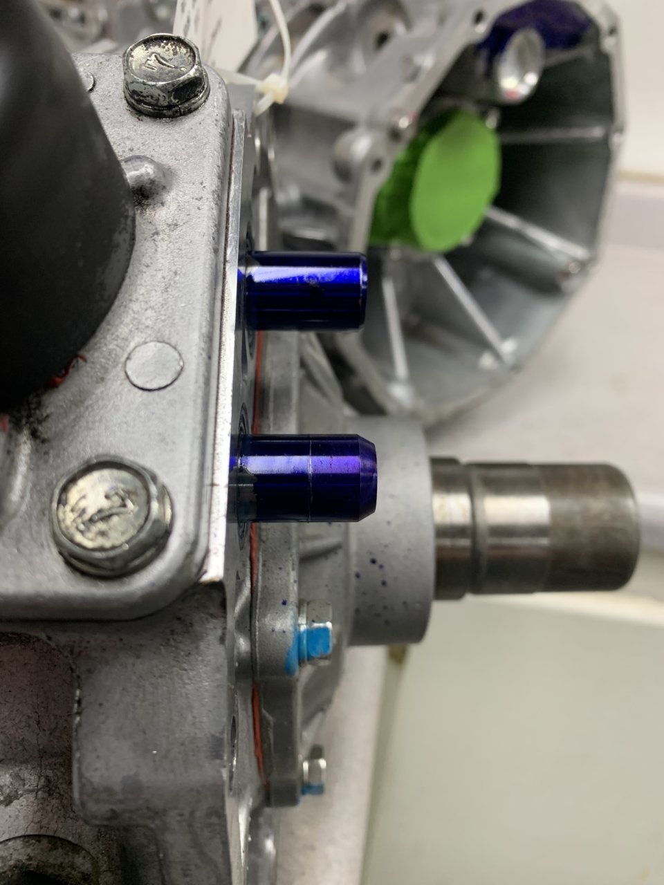

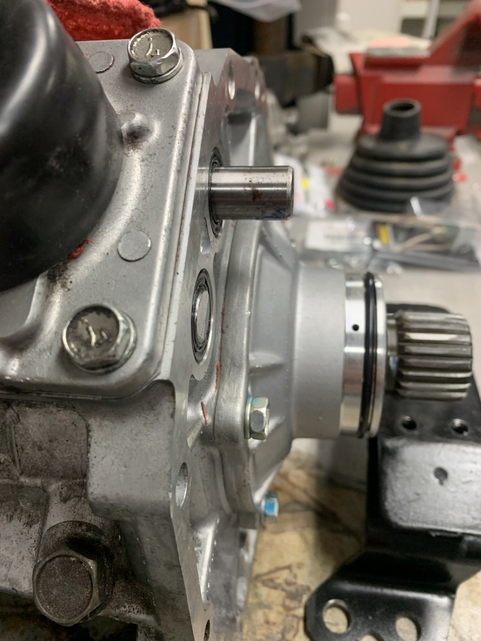

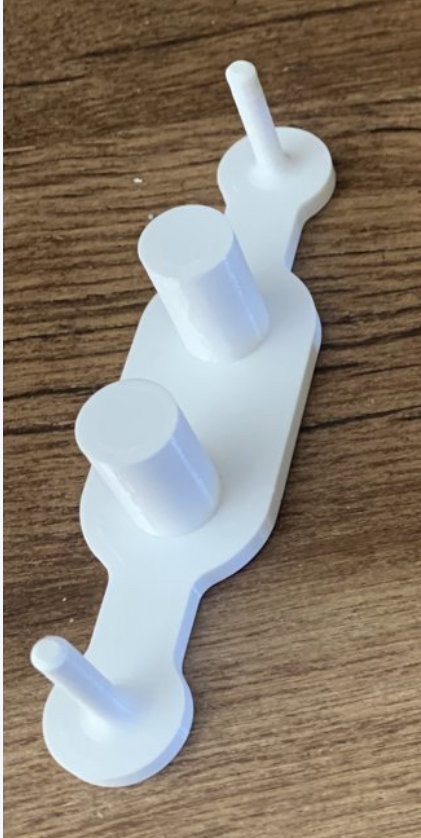

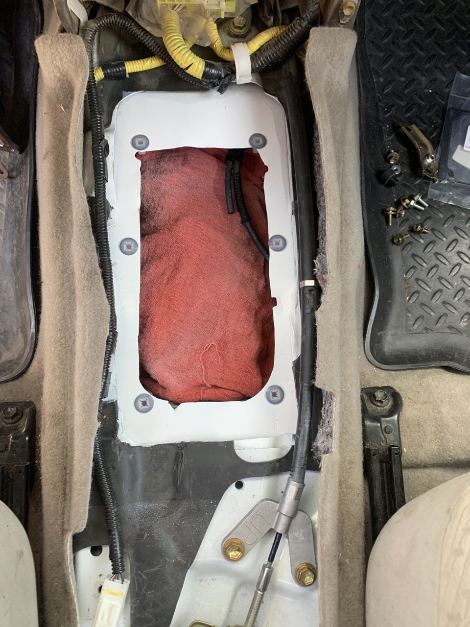

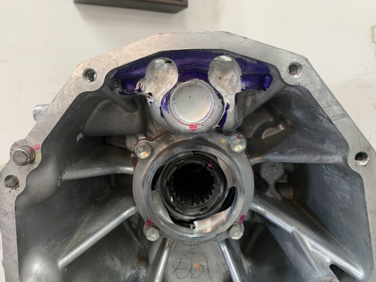

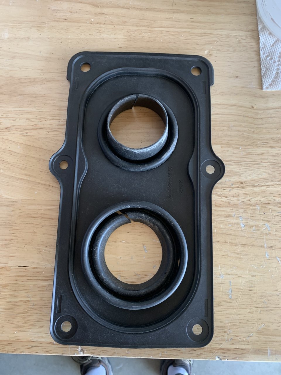

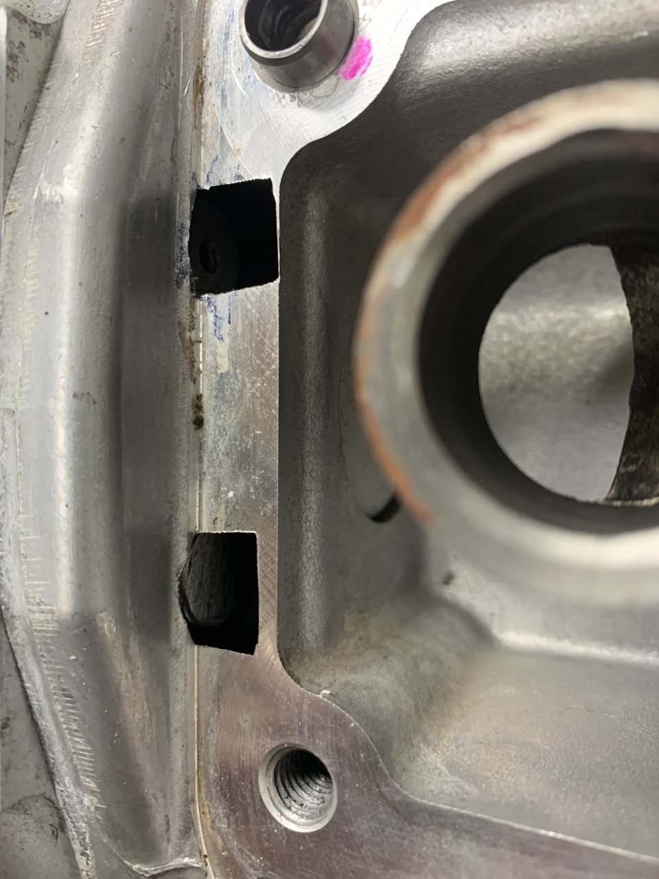

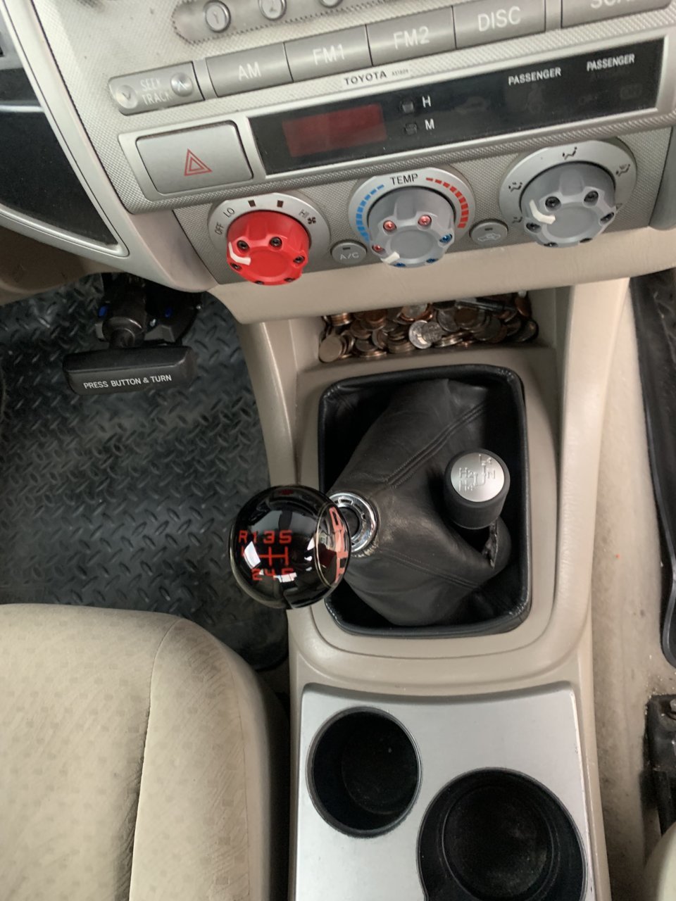

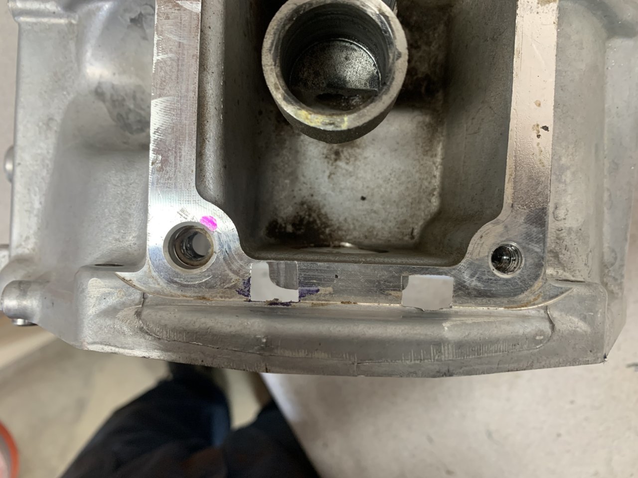

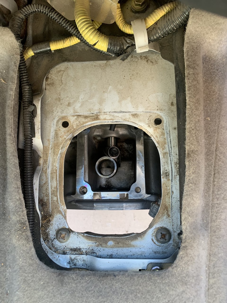

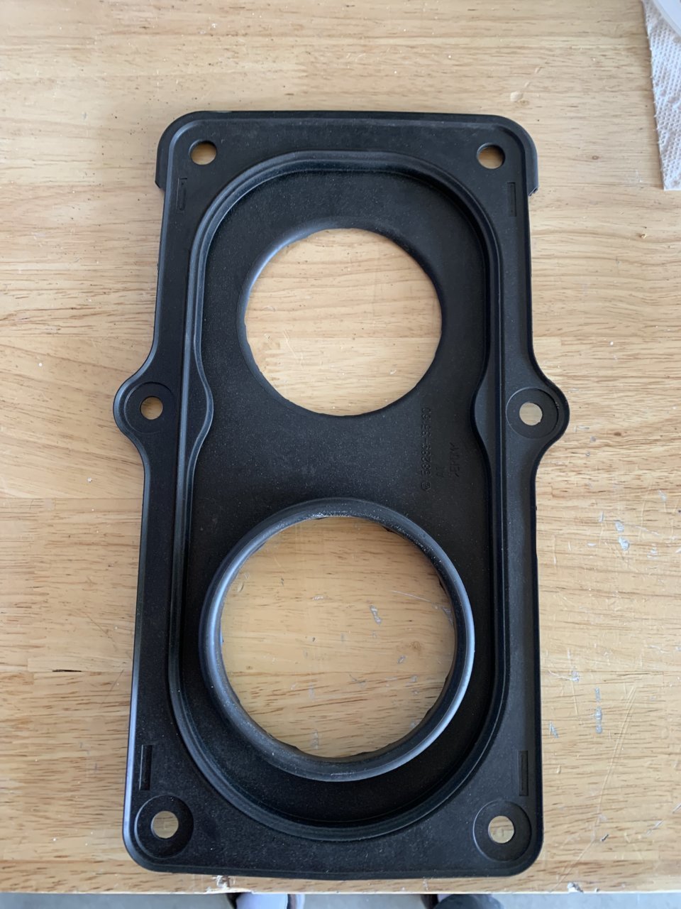

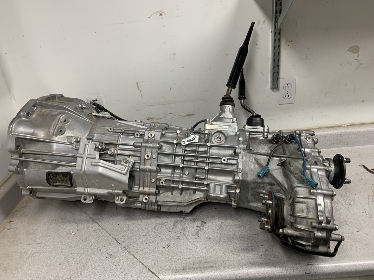

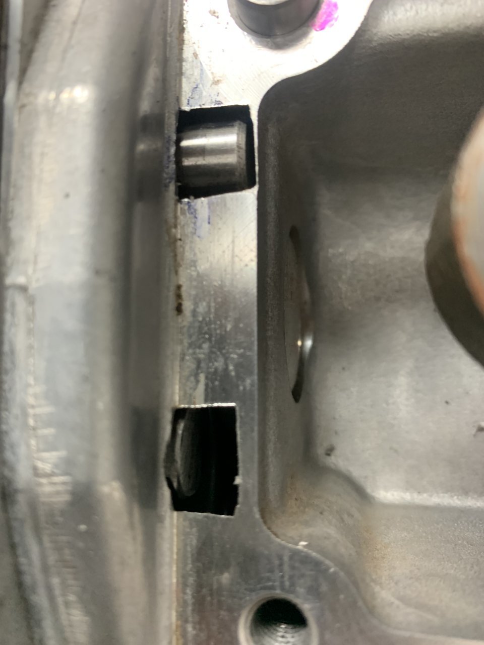

    A couple of things I thought about after yesterdays post that others may want to know. If you are doing this swap with a manual t-case mod, I would suggest using the 3d printed template/ guide to modify the back of the transmission for the shift rods. Additionally you really only need to do one side of the transmission because you have to trim one of the t-case shift rods anyways. I did try mounting the t-case without trimming the shift rod after modifying the back of the trans and found there not to be quiet enough room. If remember properly rheath08 posted about this in another thread with his AWD conversation.

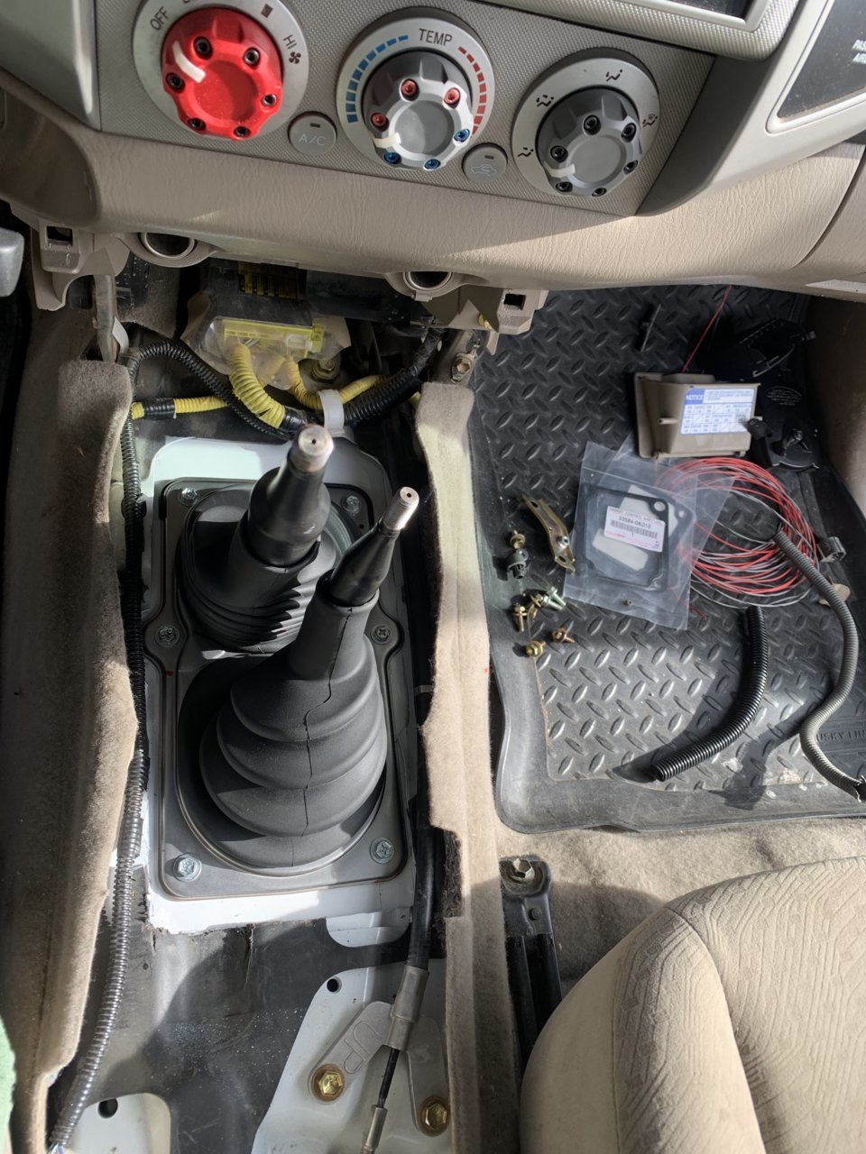

    Second thing when you cut the floor for the manual t-case shifter and you do it in manner I did it you will lose a mounting hole for the center console bracket under the cup holders. I had to bend the bracket and open up the hole so it would mount to an adjacent hole that is bigger.

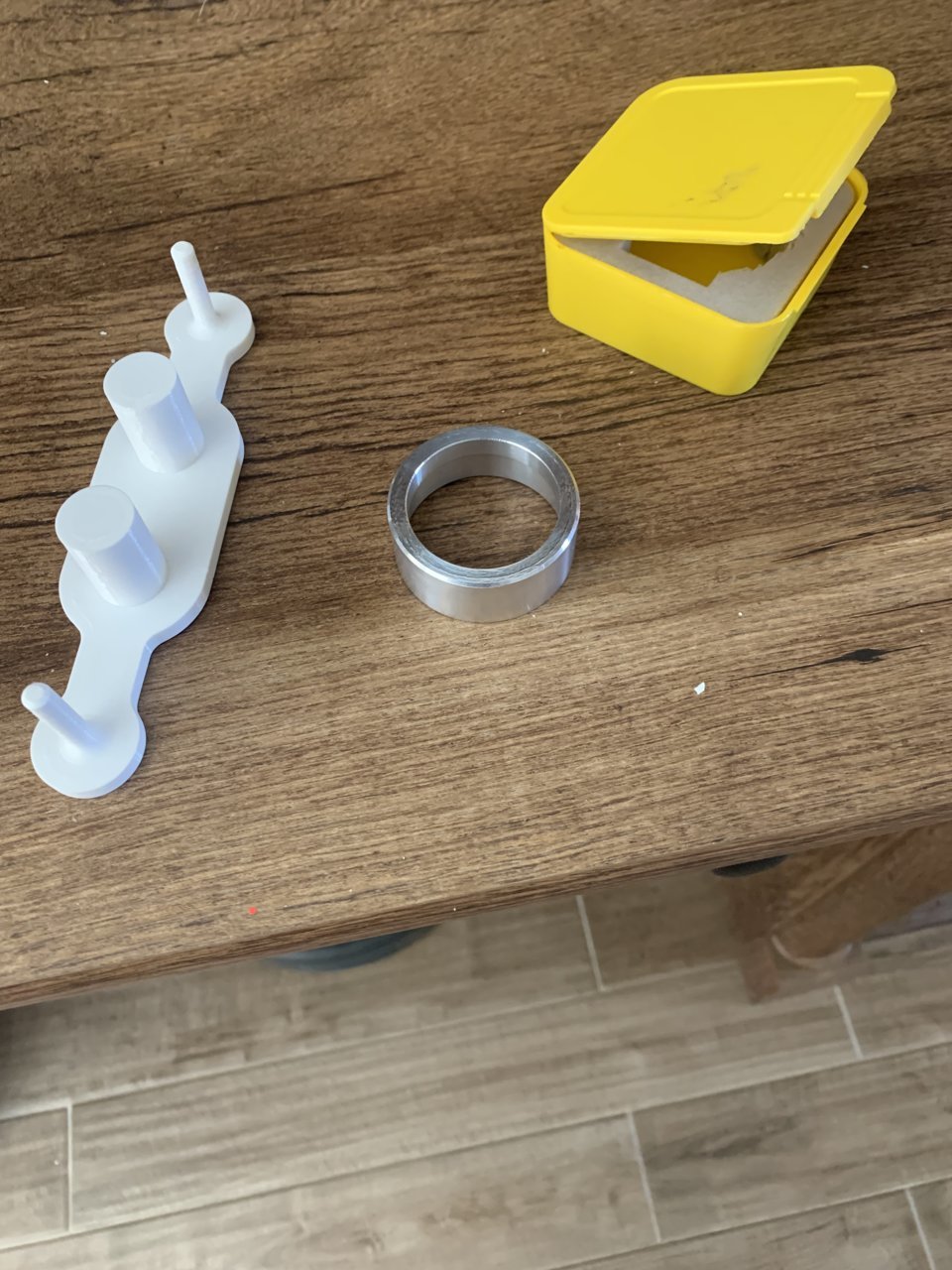

    The guy I reached out to made the skinny studs longer at my request so you can align them first. I found the larger studs to be too long as originally designed by another member and sanded them down to what was really needed.
    In these last pictures you can why you do not need to really modify the right side because of the shortened shift rod.
    Each picture show the shift rods in the different shift patterns.

    I too talked briefly to the guy that designed that template. But, since I never found a tcase, I never made one myself. Glad I waited. Yours is much better. Wanna sell that thing ?
