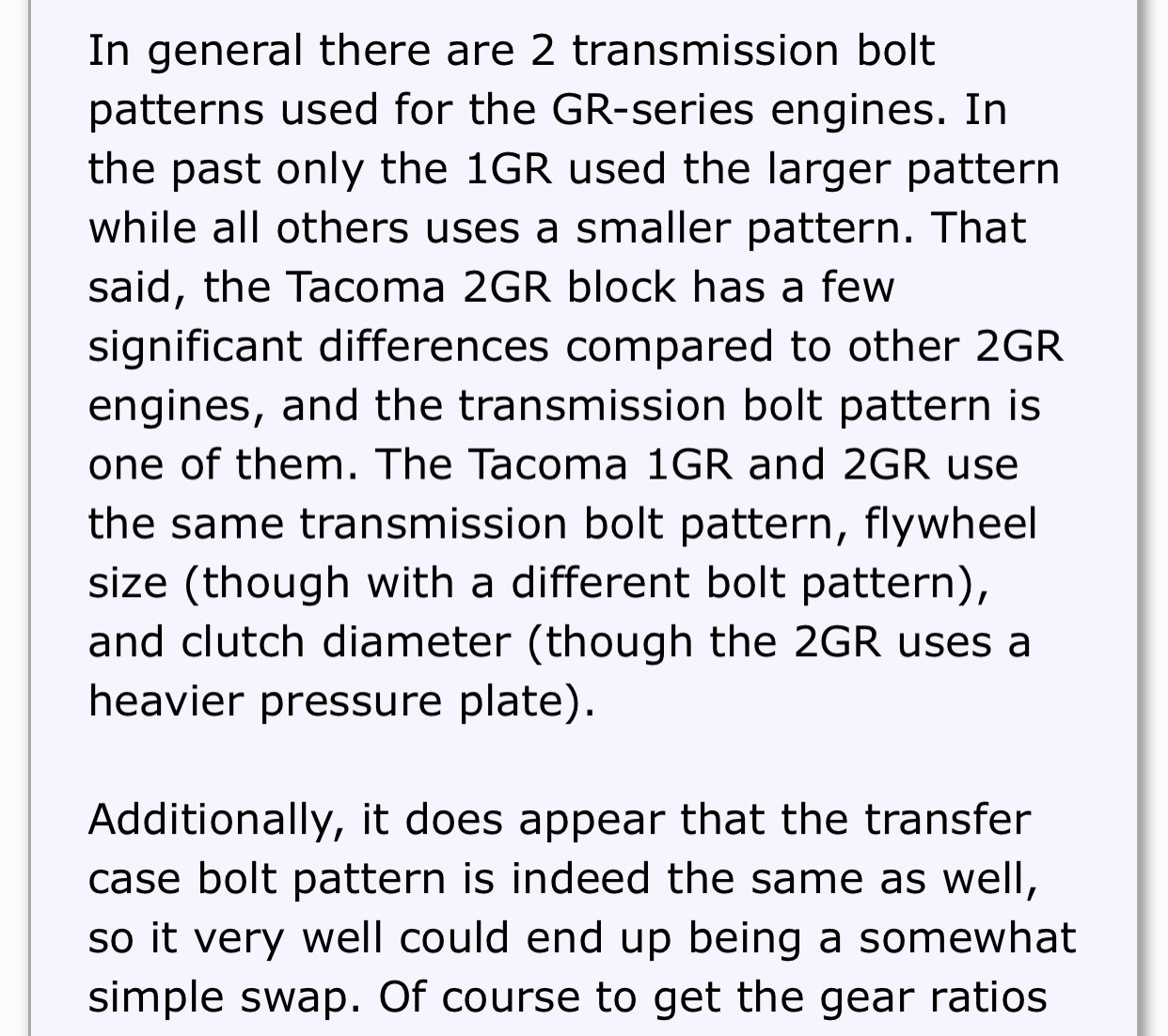

    I don’t know for absolutely sure that they do either. I thought that I’d read a post by @Jeff Lange that said that the fks in the Tacoma was in fact the same bolt pattern as the 1gr. He seems pretty knowledgeable about this sort of thing. I suppose there’s other ways to find out for sure though.
    Key-Rei and specter208 like this.

    #32
    Jowett
    Jowett Well-Known Member
    May 5, 2016
    #186182
    1,636
    Brian
    North Adams, MA
    Yes, Jeff is very knowledgeable, and I do hope his info is correct.
    BillDaCat8[OP] likes this.

    I stood under a couple of these trucks today and had a good long look. It's the same pattern.
    So, I ordered a tranny.
    We're gonna see...
