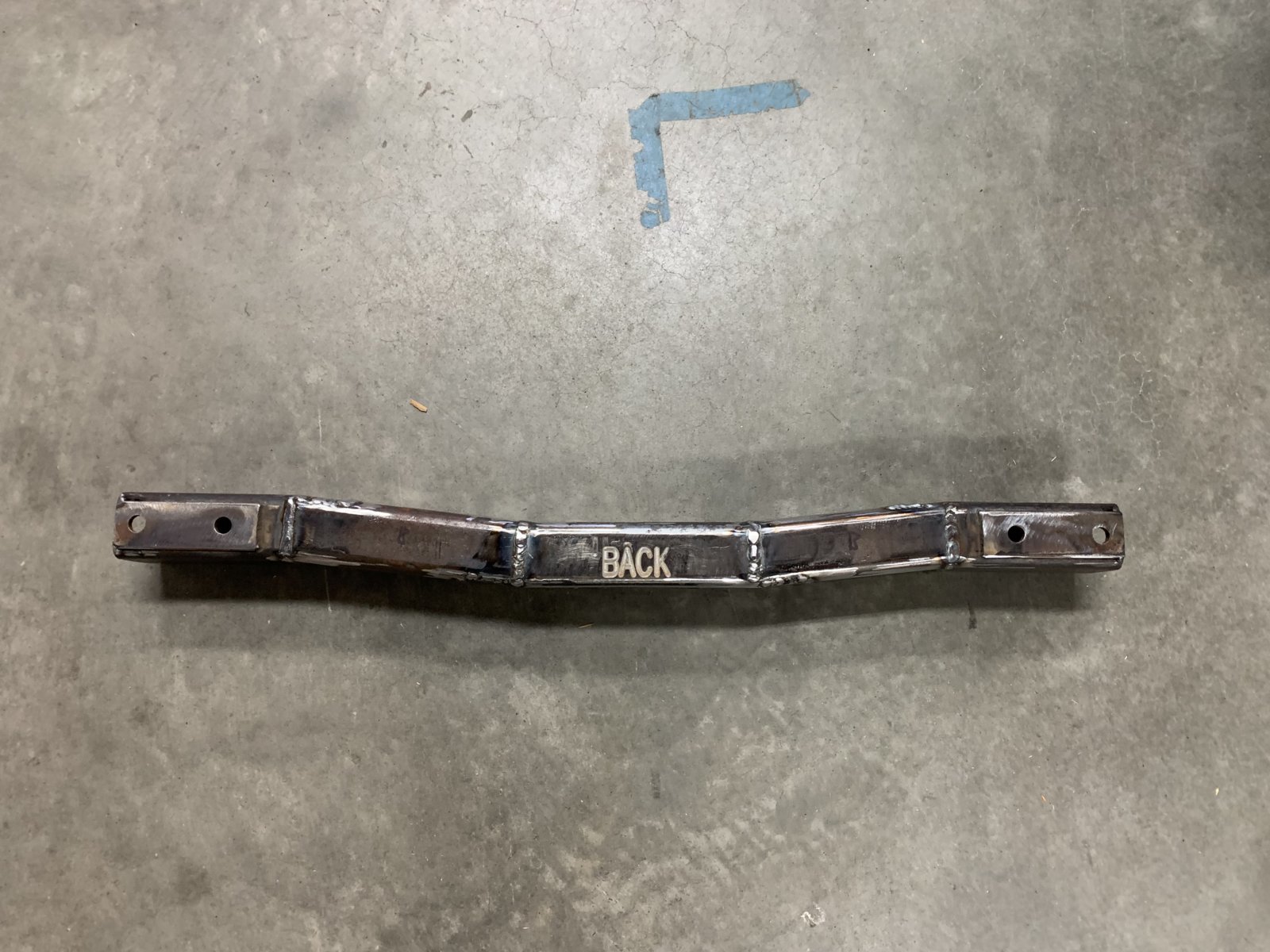

    This is what I'm looking to do in my DCLB. This seems like the easiest route for an MT swap since you don't need to change the lengths of the driveshafts.

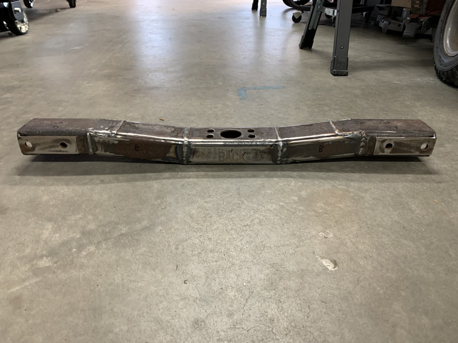

    For all those that swap to the RC62 while converting to 4wd in a pre-runner access cab and use the auto trans mount instead of the manual trans mount.
    I suggest you put a little drop into the cross member you build. This allows the trans and t-case to sit a little below the cab instead of almost touching it.
