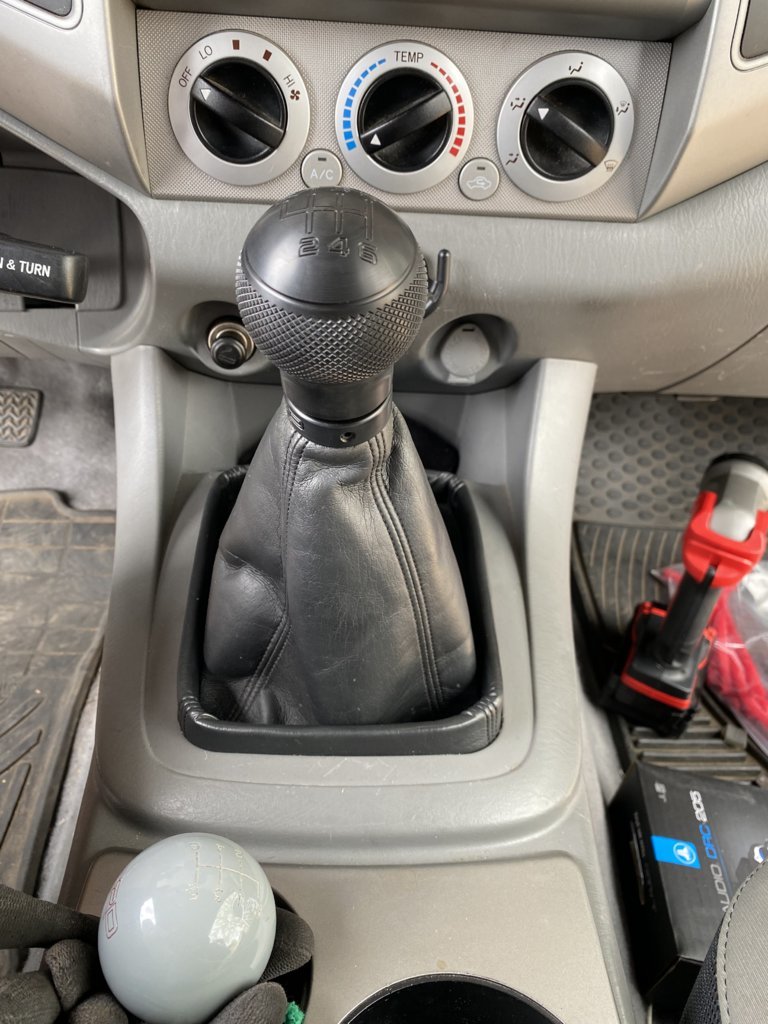

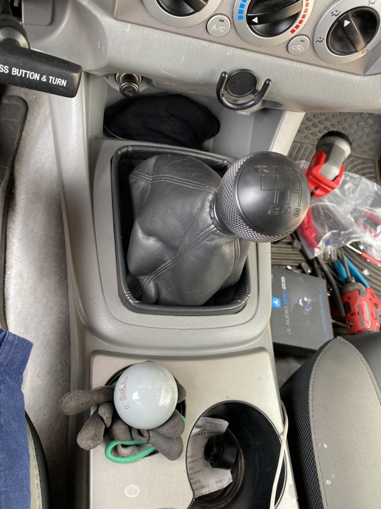

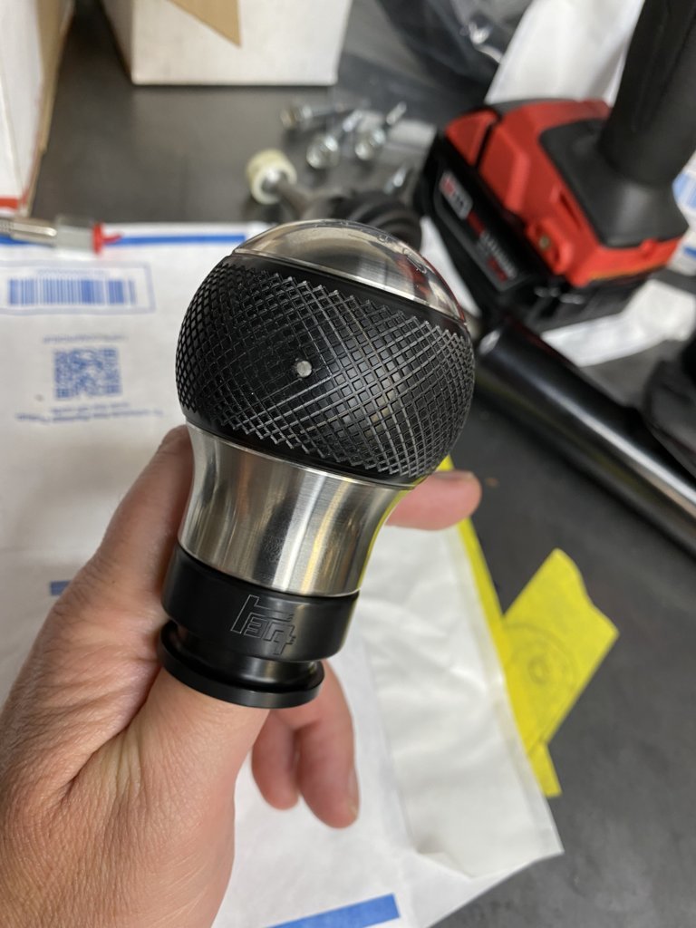

    So for those with RC62F swapped 2nd Gens that went with a Core/Hurst shifter: is the 4106 stick still the preferred choice? Are you happy with the position or would you try and order another stick if you had to do it again? I'm kind of digging the offset to the drivers side both for shifting the trans and to get a little more clearance on the passenger side for the TC lever.
    I see mention of the shorter/straighter 7201.
    7436 looks like it might work as well. All three are available at the moment.

    Mine came with whichever is the default stick for the third gen. Of the examples you posted, it looks most like the 4106 to me. I like the position. My hand just naturally finds it. Short flicks of the wrist to shift with my elbow planted on the console lid are fairly easy. Reverse takes some effort tho. This shifter demands some precision to operate. You gotta be deliberate. I’ve got a fairly heavy shift knob on it. That helps a bit. It does make subtle gear noise on the freeway.

    Thanks for the feedback and pics. Your description on position with the 4106 (or Hurst equivalent) sounds about perfect. I also have a Trailbreaker knob (a Ti V2) so I should end up with something really similar in terms of weight and position.

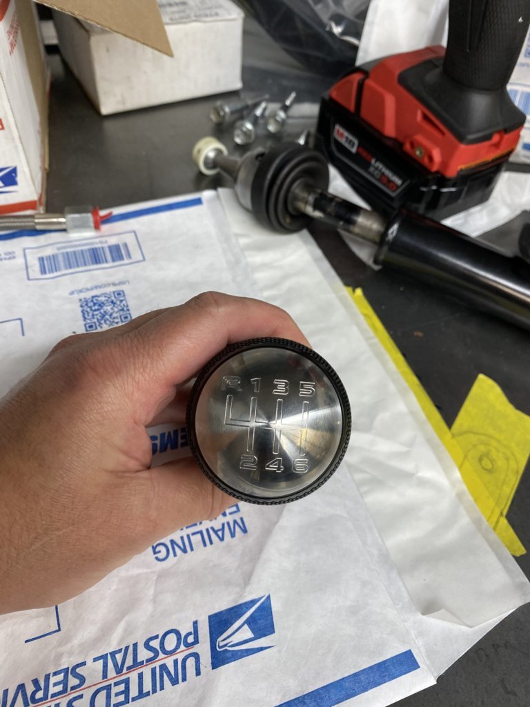

    Dood! These knobs are so nice. He really ought to make another batch. I bought two. A “summer” Delrin knob and a “winter” stainless.

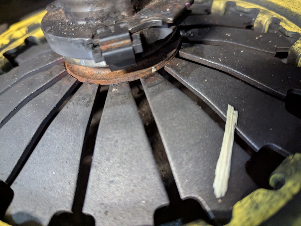

    Would anyone happen to have a measurement of the pressure plate fingers with it uninstalled? I have an ACT clutch and they state the pressure plate can fit both 2/3 gen but with the OEM 3 gen TOB it barely touches the fingers, doesn't give me warm and fuzzies installing it

    That is definitely wrong.

    That's what I figure as well but they seem confident that's it's correct, the fella I was talking to says the bearing they provide in the kit does the same thing that's why I want to compare with another brand/oem if it does the same then so be it but if not I'll get something else, this is the second clutch in this truck in 2000Km and getting real tired of dropping the trans

    I have a 2nd gen ACT pressure plate uninstalled that measures 2 5/8" across the fingers.
    I have a 2nd gen Spec pressure plate uninstalled that measures 2 9/16" across the fingers.
    My 2nd gen OEM release bearing measures 2 13/16" across the face of it.
    Hopefully this helps.
