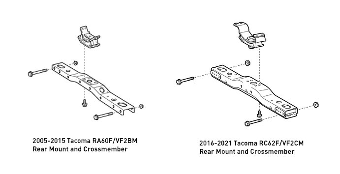

  13. Jan 6, 2021 at 1:24 PM
    #53
    Jeff Lange
    Jeff Lange Well-Known Member
    May 19, 2015
    #155616
    2,267
    Calgary, Canada
    '86 AE86, '05 NCP13, '11 GSE21
    I expect the RC62F mount will probably line up with the crossmember without issue. The mount won't come with the transmission and will need to be ordered separately.
    Jeff
    BillDaCat8[OP] likes this.

  15. Jan 6, 2021 at 1:48 PM

  17. Jan 6, 2021 at 2:08 PM
    #57
    BillDaCat8
    BillDaCat8 [OP] Well-Known Member
    Jun 25, 2017
    #222348
    1,915
    Jake
    PHX
    07 4x4 Access Cab M/T
    My shit is all stock.
    From what I’ve seen in the past, I may get the mount as well as the crossmember along with the trans. Depends on how lazy the guys pulling it out of the truck are. Cross fingers for me.
    rheath08 likes this.

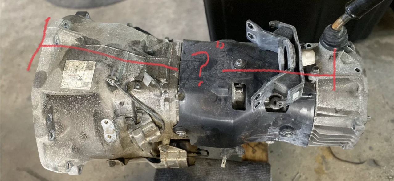

  19. Jan 6, 2021 at 6:55 PM
    #59
    BillDaCat8
    Jun 25, 2017
    #222348
    1,915
    Jake
    PHX
    Anyone have their 6mt out of the truck? Or possibly one laying around in the corner of the garage? I need a measurement. Bell housing face to center of shifter socket.

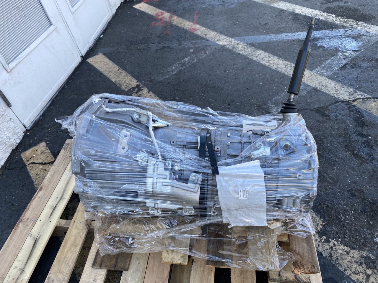

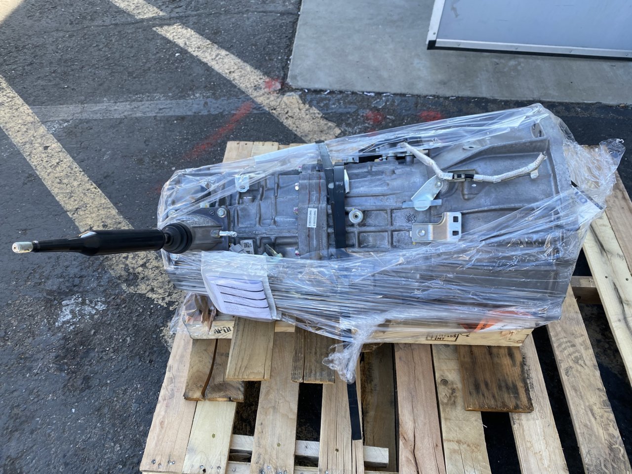

  20. Jan 12, 2021 at 12:48 PM
    #60
    BillDaCat8
    Jun 25, 2017
    #222348
    1,915
    Jake
    PHX
    It’s heeeeere...
    It came with the shifter. I was told that it would not. Oh well. No biggie. I’ve got an extra one now.
    Looks pretty clean. Donor truck was only at 8k miles. Lived in PNW area. Shipped to me out of Seattle.
