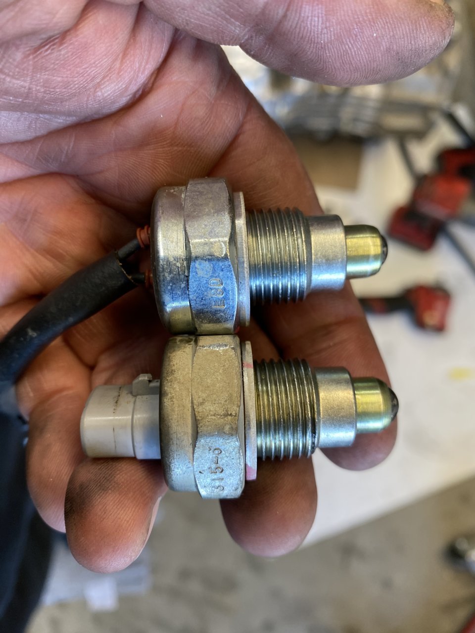

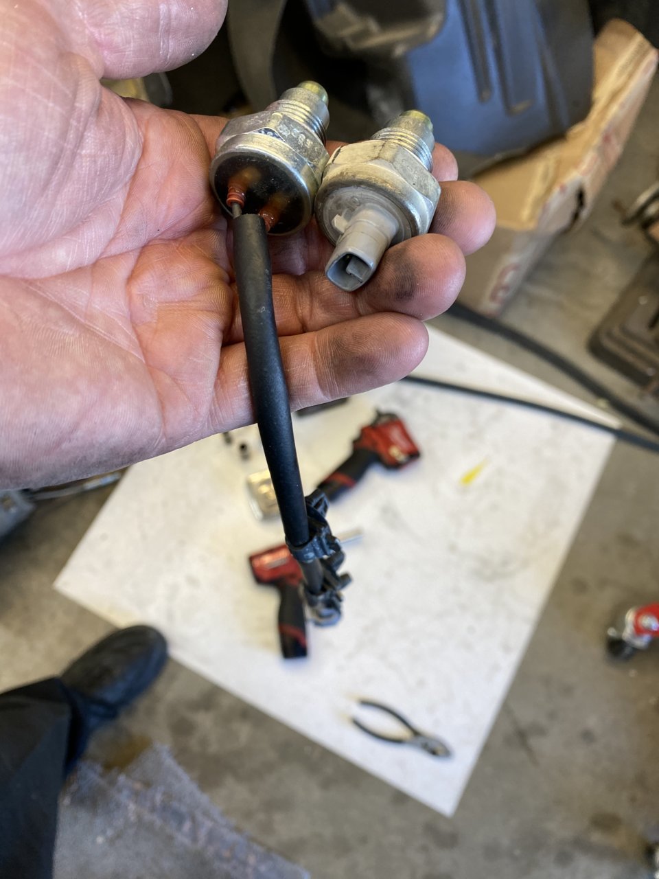

  4. Jan 25, 2021 at 9:26 AM
    #104
    wrmathis
    wrmathis Dark Lord of the Sith
    Sep 10, 2008
    #9126
    9,457
    Bonaire, GA
    2006 Tacoma TRD OR 4x4
    parts and stuff
    is that for the connector or the sensor?

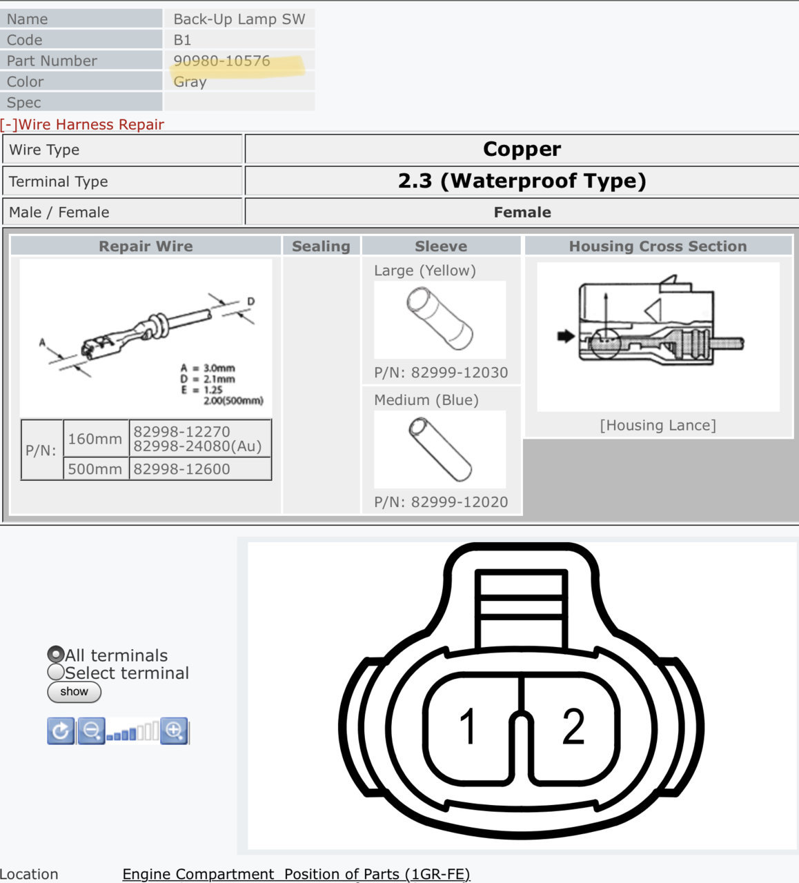

  6. Jan 25, 2021 at 10:27 AM
    #106
    wrmathis
    Sep 10, 2008
    #9126
    9,457
    Bonaire, GA
    parts and stuff
    The connector is fine. It’s the plug part on the switch that’s busted. Sorry.

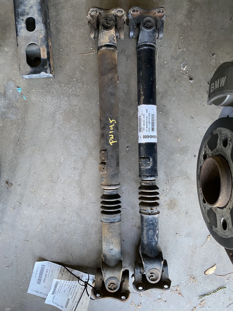

    I know you already sourced one but just for everyone’s benefit. I have a second gen A/T and am using a front driveshaft from a second gen manual 4banger.

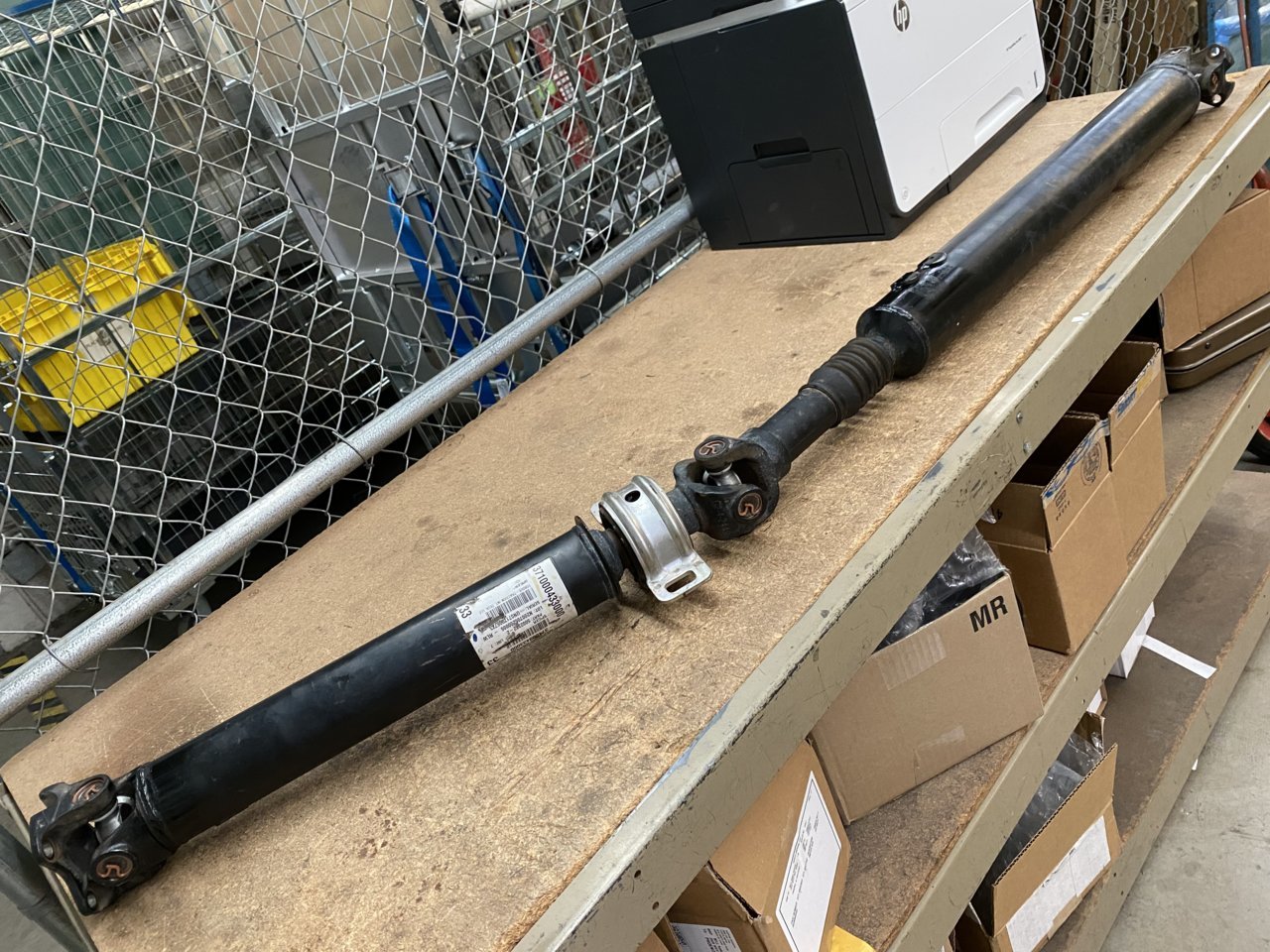

  17. Jan 27, 2021 at 5:15 PM
    #117
    BillDaCat8
    BillDaCat8 [OP] Well-Known Member
    Jun 25, 2017
    #222348
    1,915
    Jake
    PHX
    07 4x4 Access Cab M/T
    My shit is all stock.
    Used shaft has arrived. There it is next to my original shaft. It’s not as clean as I would like. But, the price was right. I’ll clean it up.
    Long section is an inch longer. Short section is the same length.

  18. Jan 29, 2021 at 2:08 PM
    #118
    BillDaCat8
    Jun 25, 2017
    #222348
    1,915
    Jake
    PHX
    Another puzzle piece just showed up. Front section shortened by 1”, new U-joints, and balanced.

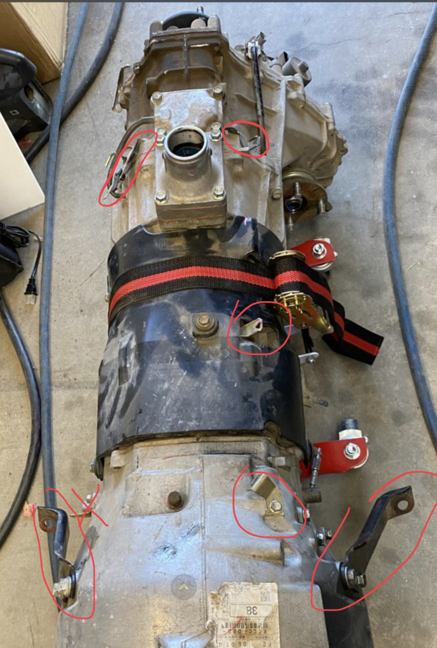

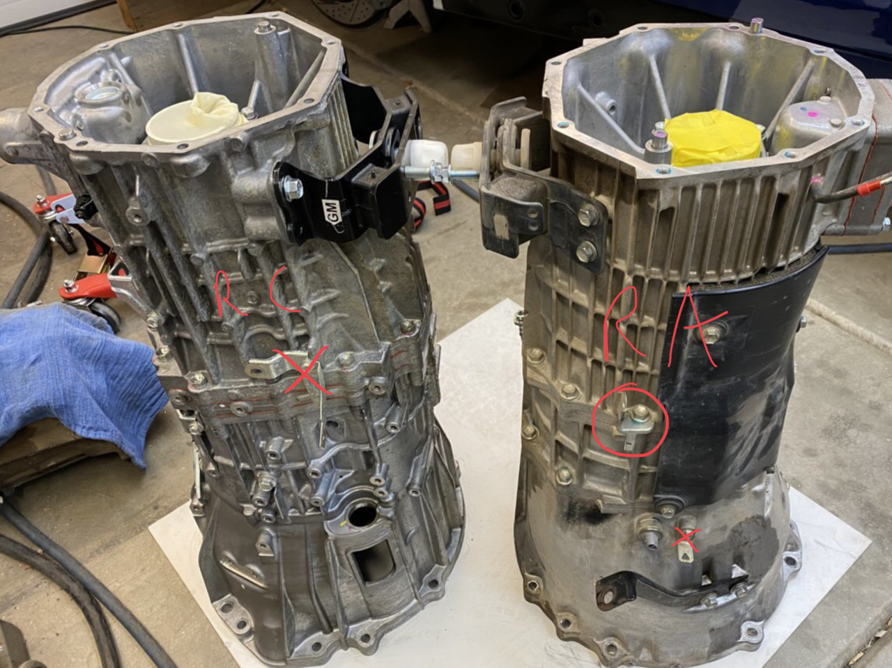

  20. Jan 31, 2021 at 11:11 AM
    #120
    BillDaCat8
    Jun 25, 2017

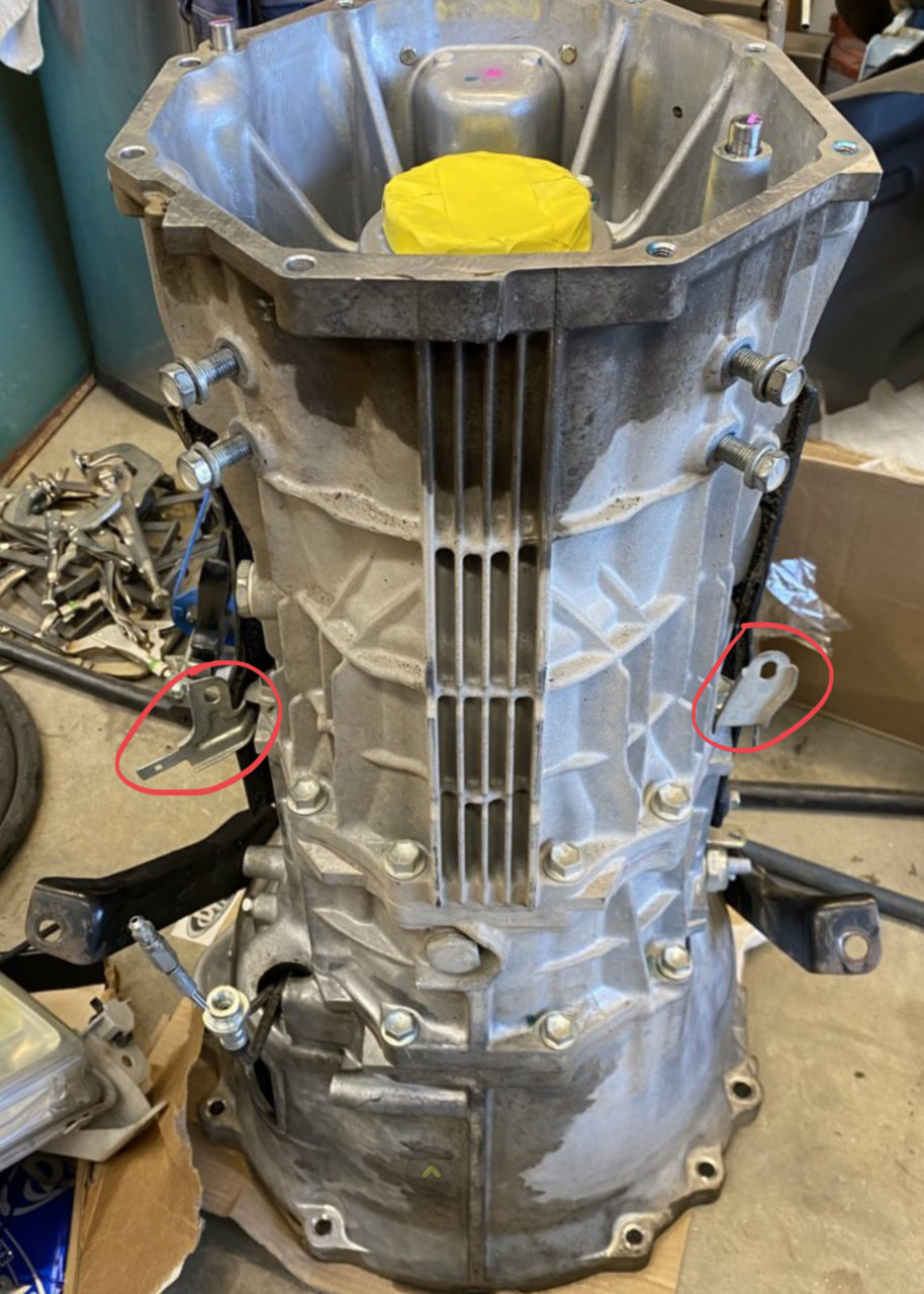

    #222348
    1,915
    Jake
    PHX
    I did a bunch of stuff yesterday. Just about all of it was clutch related and therefore posted up in the other thread.
    I did however set both transmissions side by side and swapped over the necessary brackets to hold the harness and vent tubes in place. A couple of them required minor massaging. No big deal.
    EDIT: hopefully these pics help. Basically you’re going to transfer the brackets I’ve circled and eliminate the ones I’ve crossed out. The plastic holders on the harness will need to be moved around a bit to line up.
    The LH O2 bracket needed a bit of trimming to get it to play nice with the casting of the RC trans. Take your time and only trim what you have to here to make it sit flat under the bolt head. The O2 bracket that came on the RC might actually work just fine. Maybe try it first and then decide.
