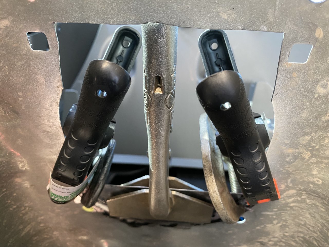

    My panel bond adhesive is a lot slower to cure than I’d like. So, I probably won’t be able to unclamp and continue with the floor until tomorrow evening.

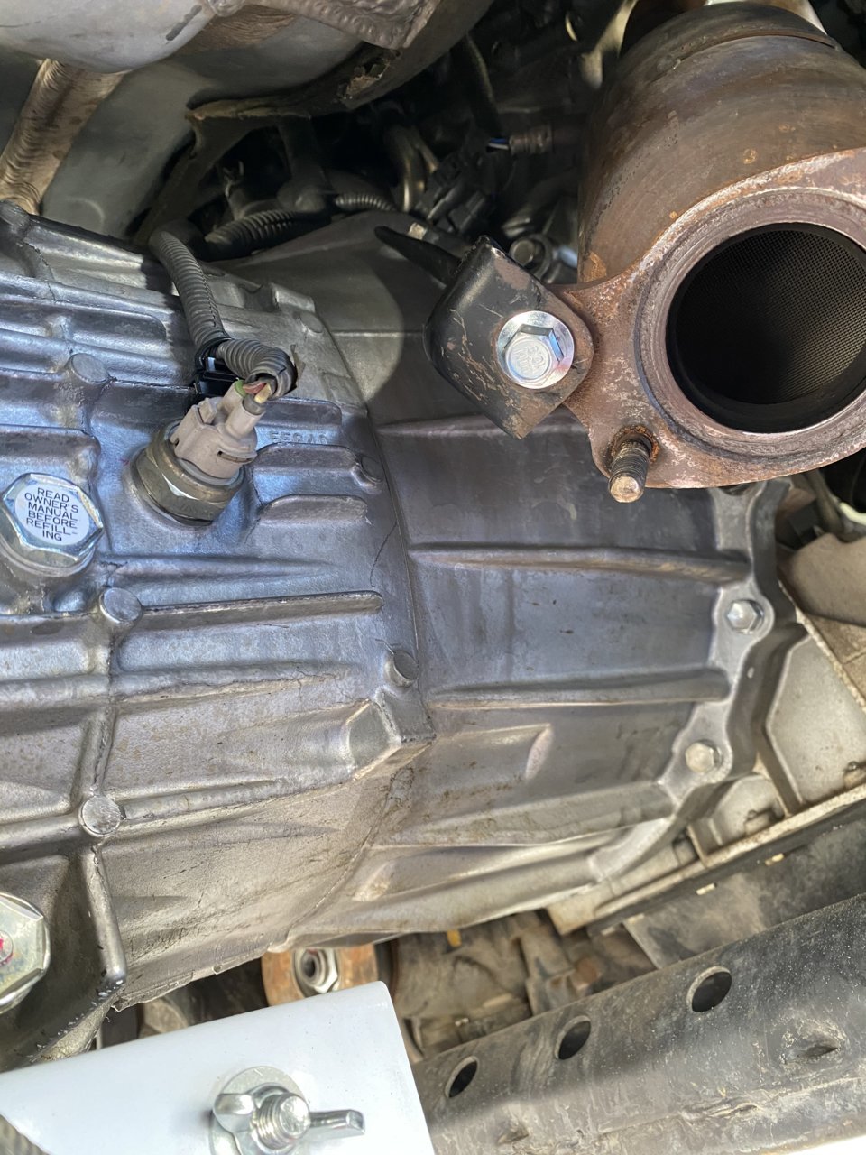

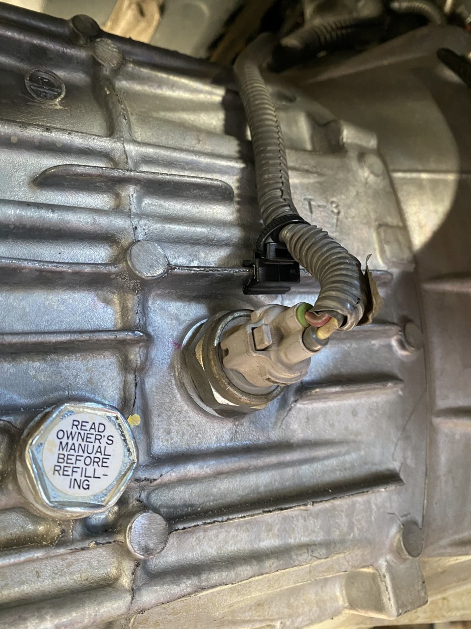

    I got the harness all positioned and ready. Had to move a few clamps and such. No biggie. Had to get creative with the harness holder on the reverse switch. The new trans does not have a bolt hole there like the RA trans did.
    I stole this clamp I had languishing in the garage from my bimmer project and made it work. A 90118-WA732 would be a better choice here though.

    Exhaust manifold brackets off the bell housing are the same. So, that just works.

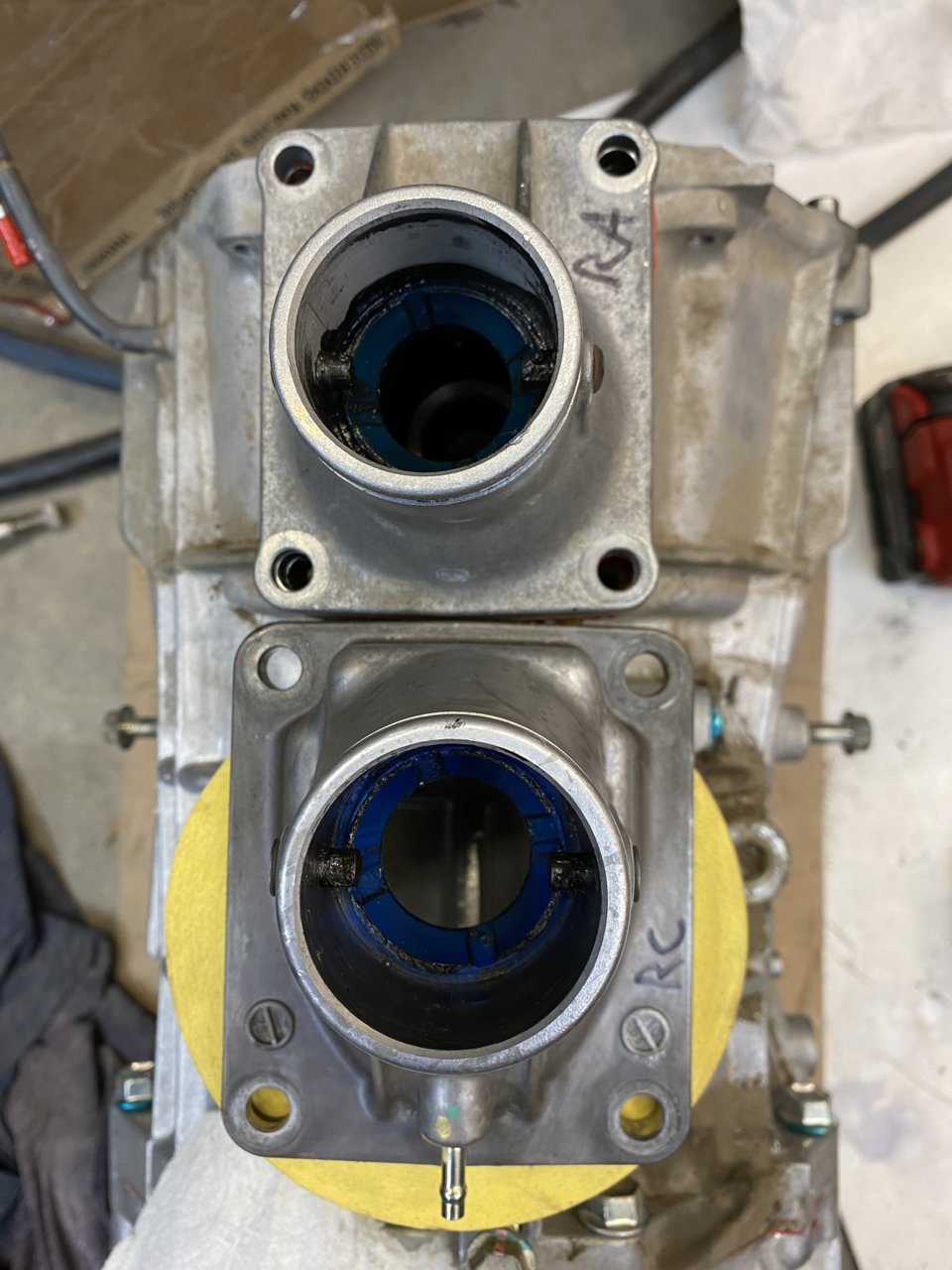

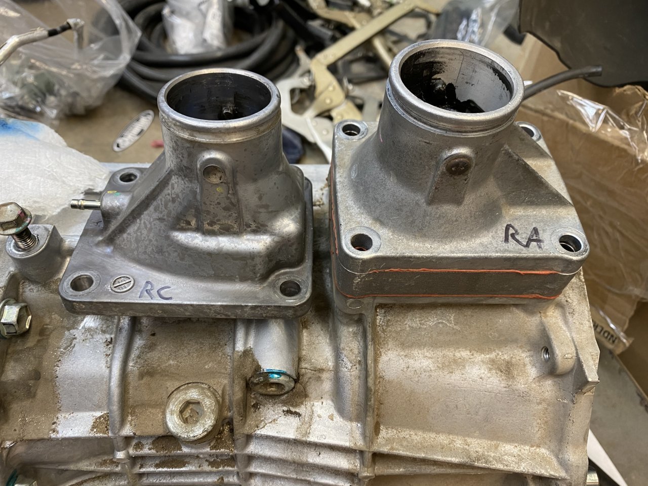

    Do you have a picture of the shift lever retainers for the RA and RC side by side? Curious if they share the same bolt pattern.

    Definitely not the same pattern.

    looks like they moved the breather up to the shifter too, the RA breather was on the top passenger side of the bell housing.

    I’ve got some tubing ready. Once the transfer case is bolted up, I’ll get it all connected up.

    in think that’s a good change too because the old one being integrated into the housing was a pain to extend higher. With this design it would be easy to run some tubing from the shifter up to the top of the engine bay.

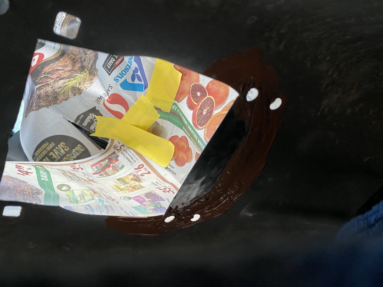

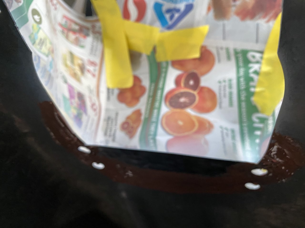

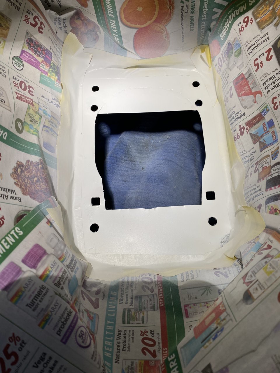

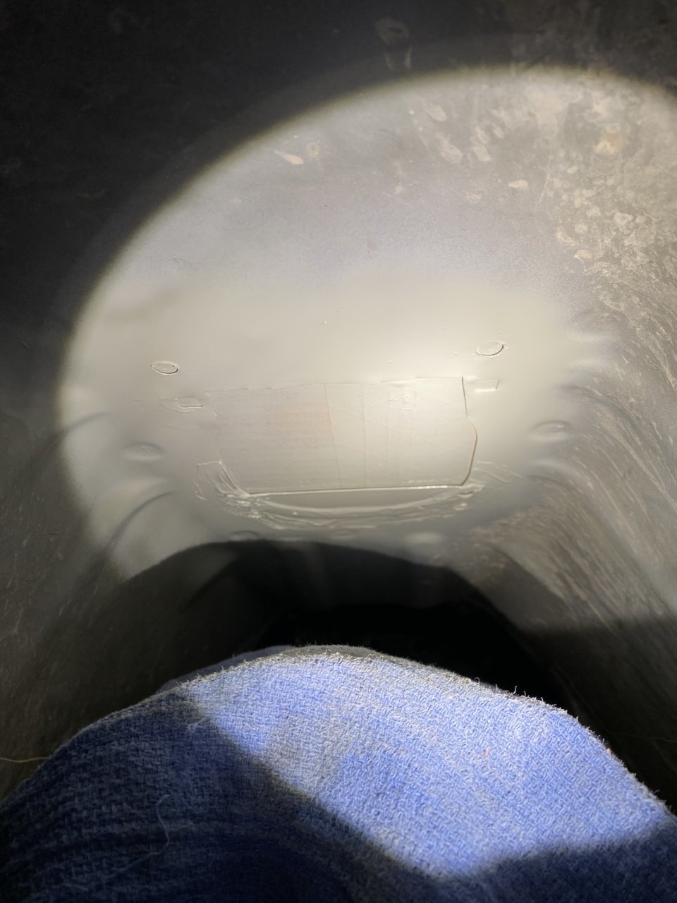

    Finished up the floor editing tonight.
    Pics are dark, I know. I’d lost daylight by the time I thought to take pics.
    Seam sealer underneath.
    Top coat below and above.
    Fin.
