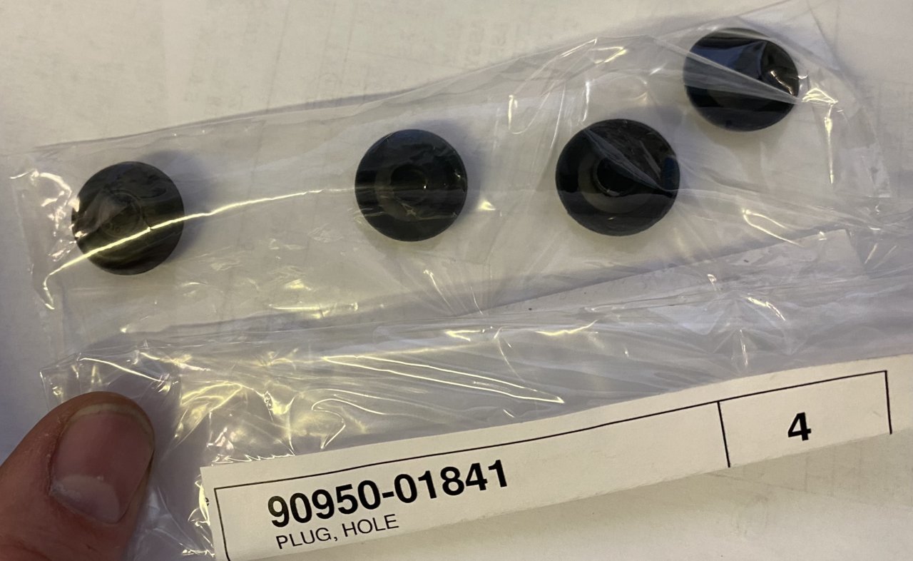

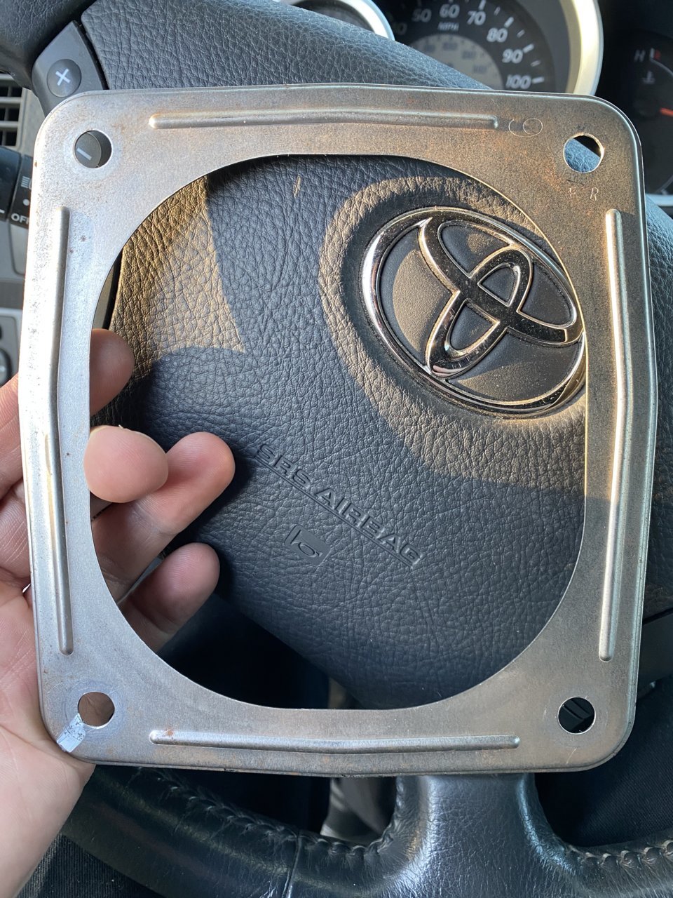

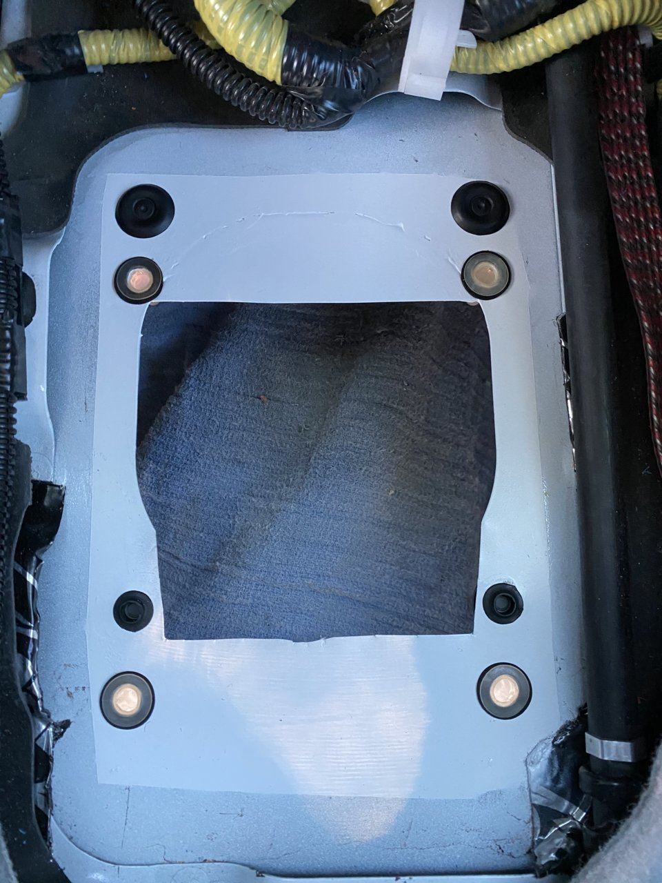

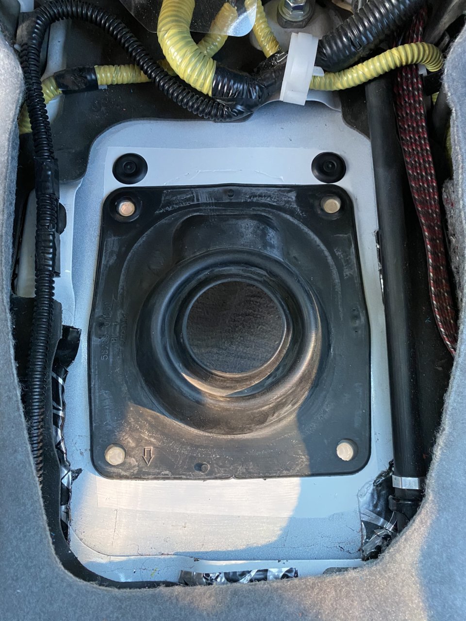

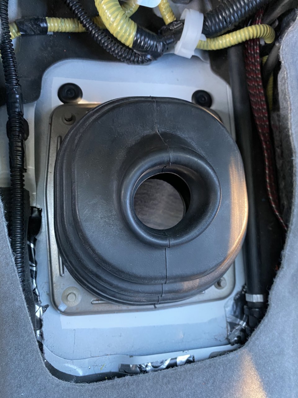

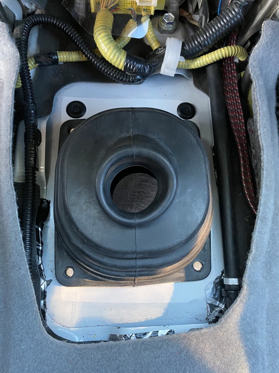

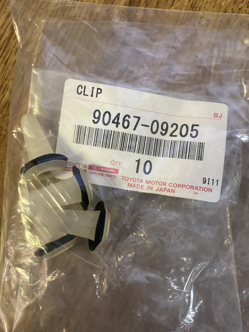

    So, I typically like to make things reversible if I can. That’s what this floor modification is all about. I’ve only trimmed just enough off the rear of the hole to allow access to the shifter bolts. If, for whatever reason I end up going back to the RA transmission, the OE boot still completely covers the opening. The piece added to the front of the hole can be removed with a bit of focused heat. Hole plugs re-located, etc. I realize that this part of all this isn’t all that interesting to most. Apologies for that. But, it is a part of this swap. Anyone who does this will end up dealing with the floor. That being said:
    Here’s a few trinkets I used:
    Trinkets in place.
    Reverse the lower bootie and top it with the upper boot in the original orientation. There’s a couple of staples and two rubber alignment nubs that need dealing with.
    I used a unibit to open up the two odd shaped holes in the ring to the same diameter as the larger holes.
    Ta-daaaa
