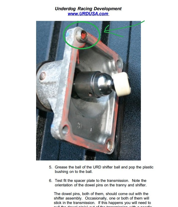

    Does anyone know the part number for the 2 dowel pins? See attached dowel.jpg

    90253-11021 for the V6 4x4 manual trans

    thank you sir
