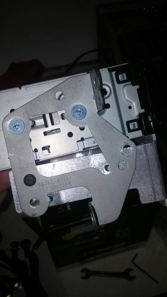

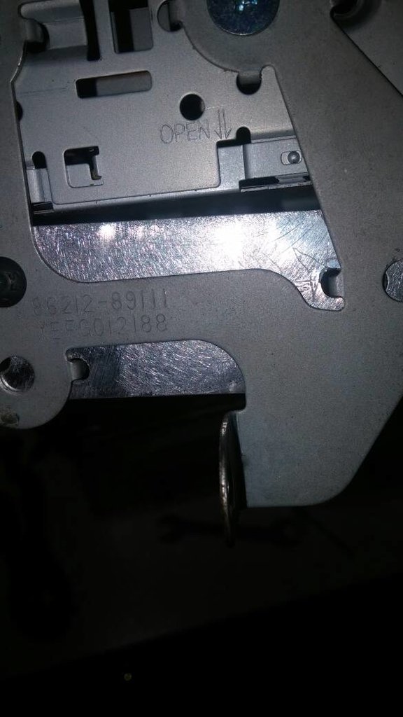

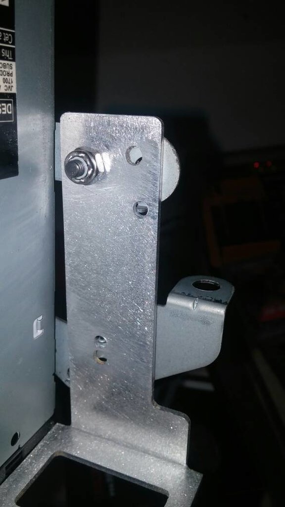

    So I finally got to working this mod.
    Up front: I purchased this 6 switch plate for a '95 4Runner, hoping that it would drop right in... It did not. Although, it's only a few drilled holes and some patience away.
    Here's a couple pics of the changes:
    The face plate fits great just needs different holes to fit the mount bracket.
    I'll edit/post some more pics when done.
    Thanks for a sweet product!

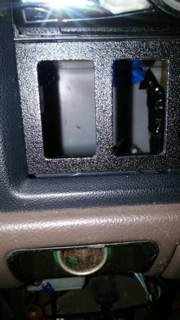

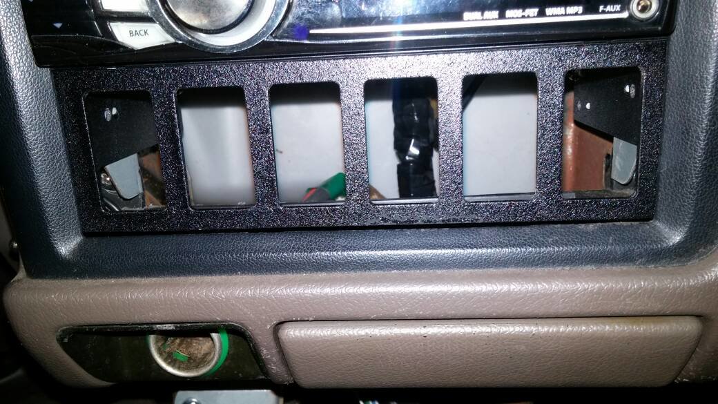

    Couple more pics now that it's installed:
    There is a slight gap along the bottom edge. Again this is in a 95 4Runner, so the panel is not exactly made to fit here but its darn close!
    Switches are on the way. Will update when completed.

    That looks pretty close, I am intrigued by the ring around the cigarette lighter outlet, it appears to match the ignition ring light, might have to find me one for my Tacoma.

    sweet, looks like it fits the runner pretty good.

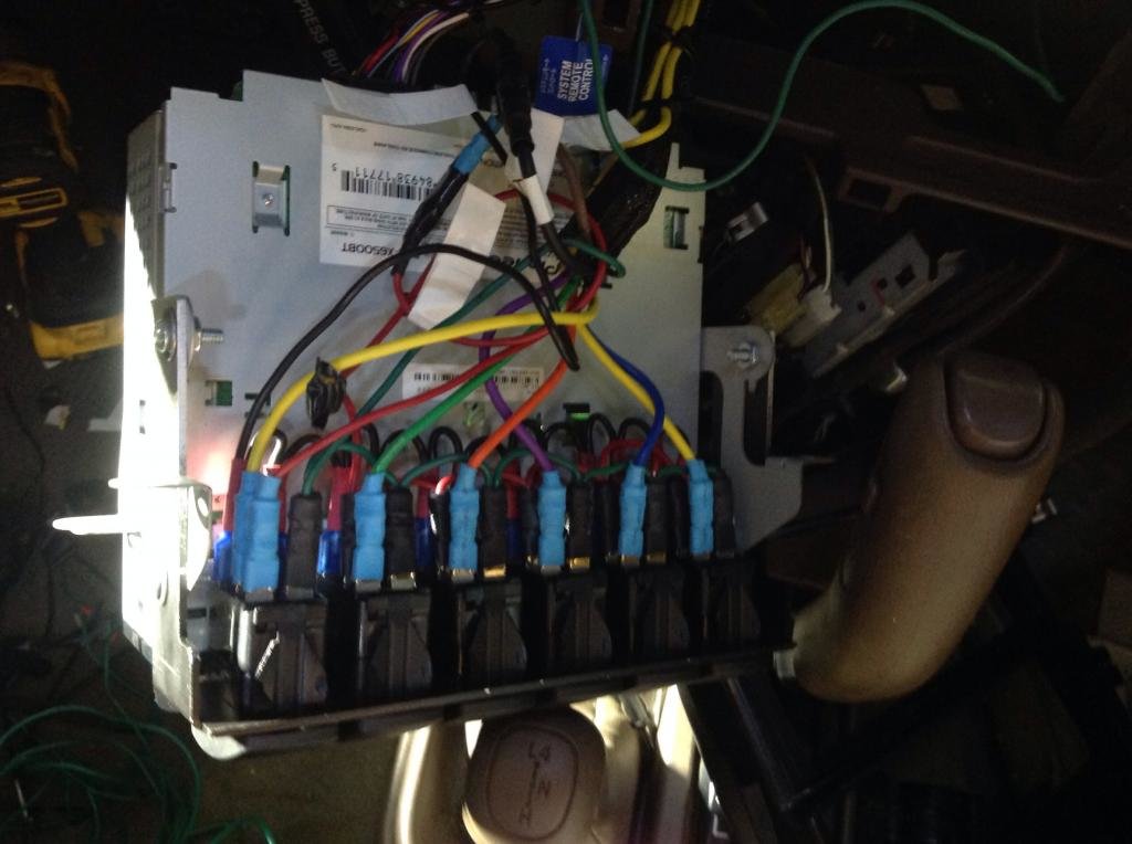

    Is there a "how to" on wiring up these switches together? I already have enough accessory lights to fill a 6 switch plate but it would require re-wiring most of them, and wiring is not my specialty.

    Other than the wiring diagrams for the switches (http://www.otrattw.net/wiring-diagrams.html) not that I have seen.
    You'll notice in the pic you quoted, a bunch of the terminals are jumpered together; these are typically the common ground and any dash light wiring. This reduces the number of incoming wires.
