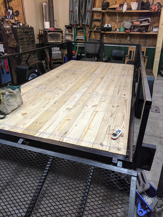

    T99c1ebYyfZqocjf0yXTMFmguntxYiblbERVA-5v_b5b92f2ead9f8a66bea02094c1f9c206932129e9.jpg

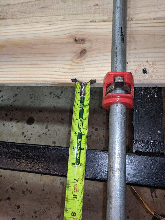

    Checking the final board width. I want this gap to be somewhat uniform. I have to rip the last board to fit and it's a lot easier if the measurements are close to the same the full lenght of the trailer.

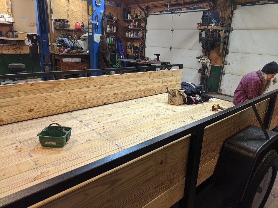

    O1OdxBot61HAbKCJnPB_PeqvW7fUXosIpspe0gRU_20d38158aeee35cabb2e5a93c2939777039cbed0.jpg
    Chalk lines to show where the cross members are. Note I never drive the 1/4" self tapping torx head screws into the 2 x 2 tube tongue support cross member. This tube has the trailer light wires going to each side of the trailer frame. It's too easy to cut the wires with the drill bit.

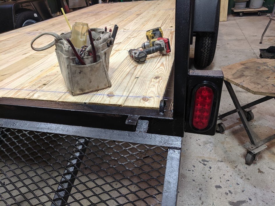

    QjMM2-h6SDmY5i2ke8ZP6U4zv6Bcdf2WYG1Wayr4_5d104eedb5c7a8c30fcae8ebd455435ca3845f06.jpg
    My wife installs the deck and sides. (I'm drinking a beer and taking pictures).
    Her record is 14 trailers on 1 drill bit. I think it was the Dewalt brand from Lowe's. There is roughly 140 screws per trailer. She wanted to put that drill bit in a frame.

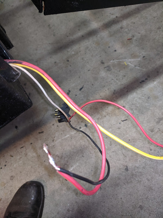

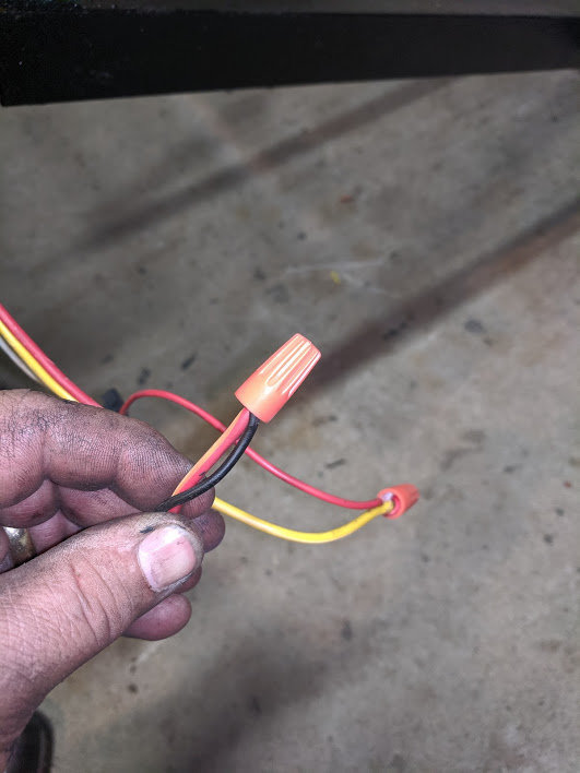

    wCzDkXJDyGydbzBInKKzRNqQd_iESzP-Oq85mgnS_b104f2d964a3b549e05c790464461b7754b25821.jpg jZIMcLSrf35cVno8ZJWWVDciFsld4C9WP5Tu_wIS_9a9c54a63cea87192ee0cb3044faf597be339fea.jpg
    I like to solder the wires for the tail lights together then throw on a wire nut. I've never had a failure using this method. It's quick and its reliable.

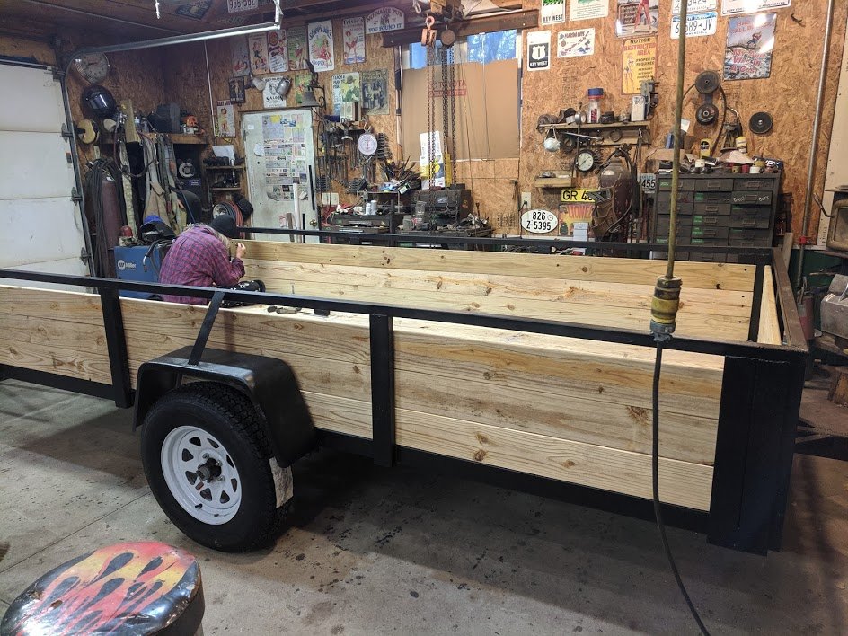

    8i5Qyp6ZbWeOTJvDHsPKA8tSxBhp9oWevVWZ7SRr_b1df398a9644a0620f68207deefcc8b18c86a01d.jpg
    Lights installed. Trailer is done.

    2000 reg cab 4x4 flatbed MT
    This is interesting to me - I would think you'd get corrosion up in the wire nuts. That said, its probably pretty easy to rinse out. Hmmm

    Those are wire nuts that have a hardened plastic thread. My car hauler is 15 years old and all the lights are functional. I used this exact method.

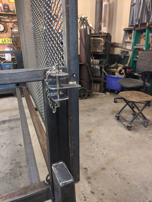

    On the latch, it looks like the ramp has the extra tang sticking up, which would be easy trip on it or run over it (cutting a tire or bending it). Why wouldn't you have the extra long tangs on the rail, so the ramp's tang doesn't extend up?

    I've done it that way in the past. I only needed to have that tab jab into my forearm one time to realize I didn't like it that way.
    I've used store bought latches as well, but I didn't think they were any stronger or easier to use. The biggest expense us the cost of the pins going my route.
    Anyone building their own trailer gate is free to use what they want. I like my cheap and easy style.
    I guess there really is no right or wrong answer.
