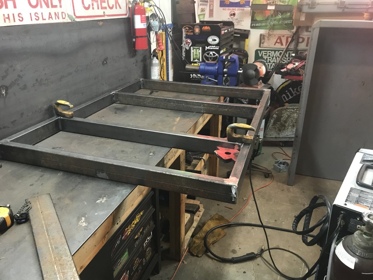

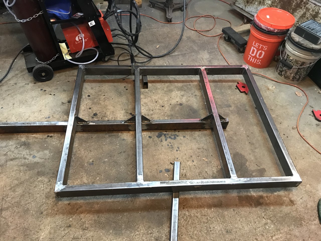

    Calling it a night. Gotta Go inside and order parts. Hopefully, I can find time to do the tongue and get it rolling tomorrow.
    The crossmemers aren’t evenly spaced because I made them line up with the ones on the box.

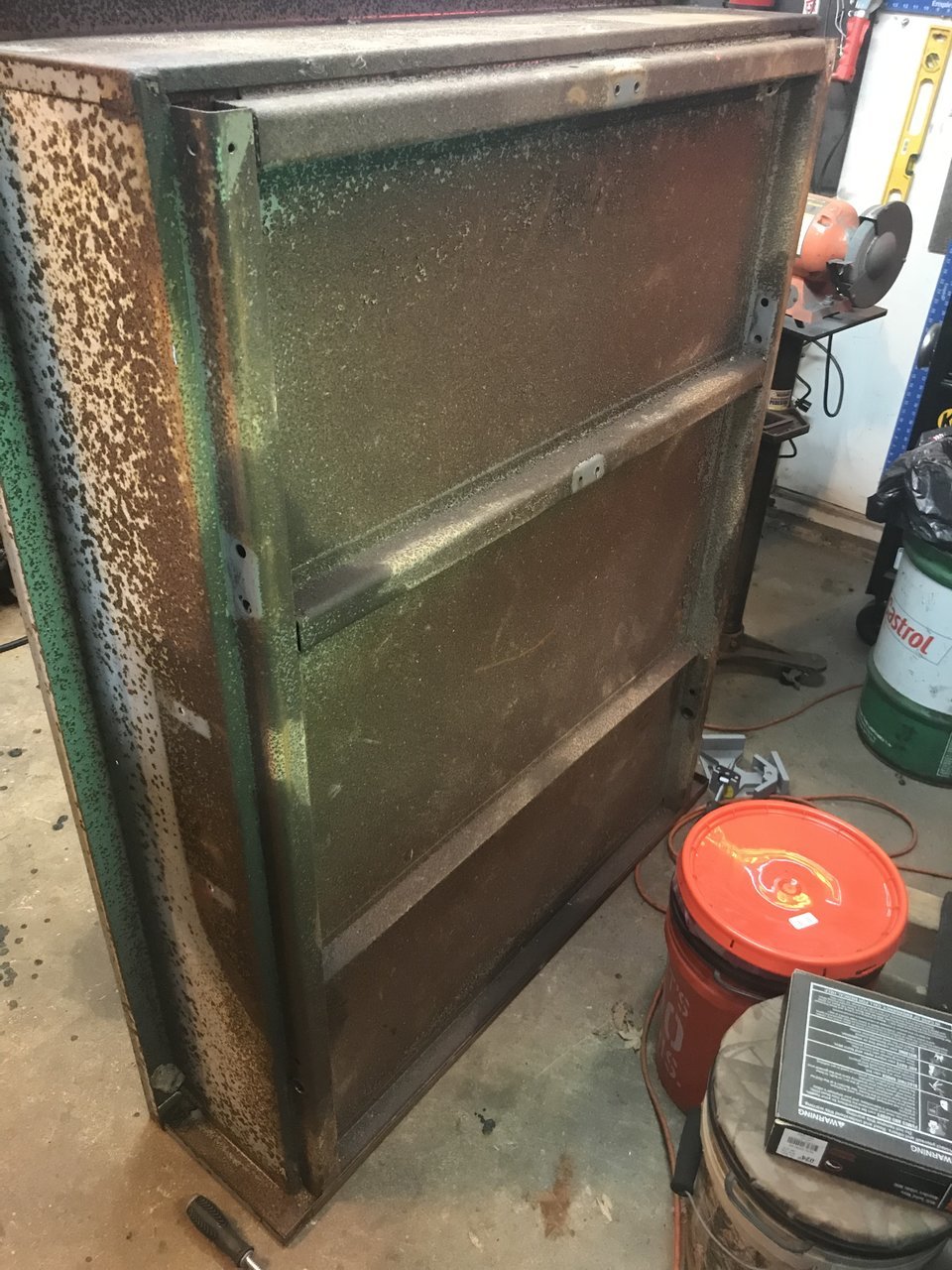

    The most time consuming part will be cleaning up, and painting the box.

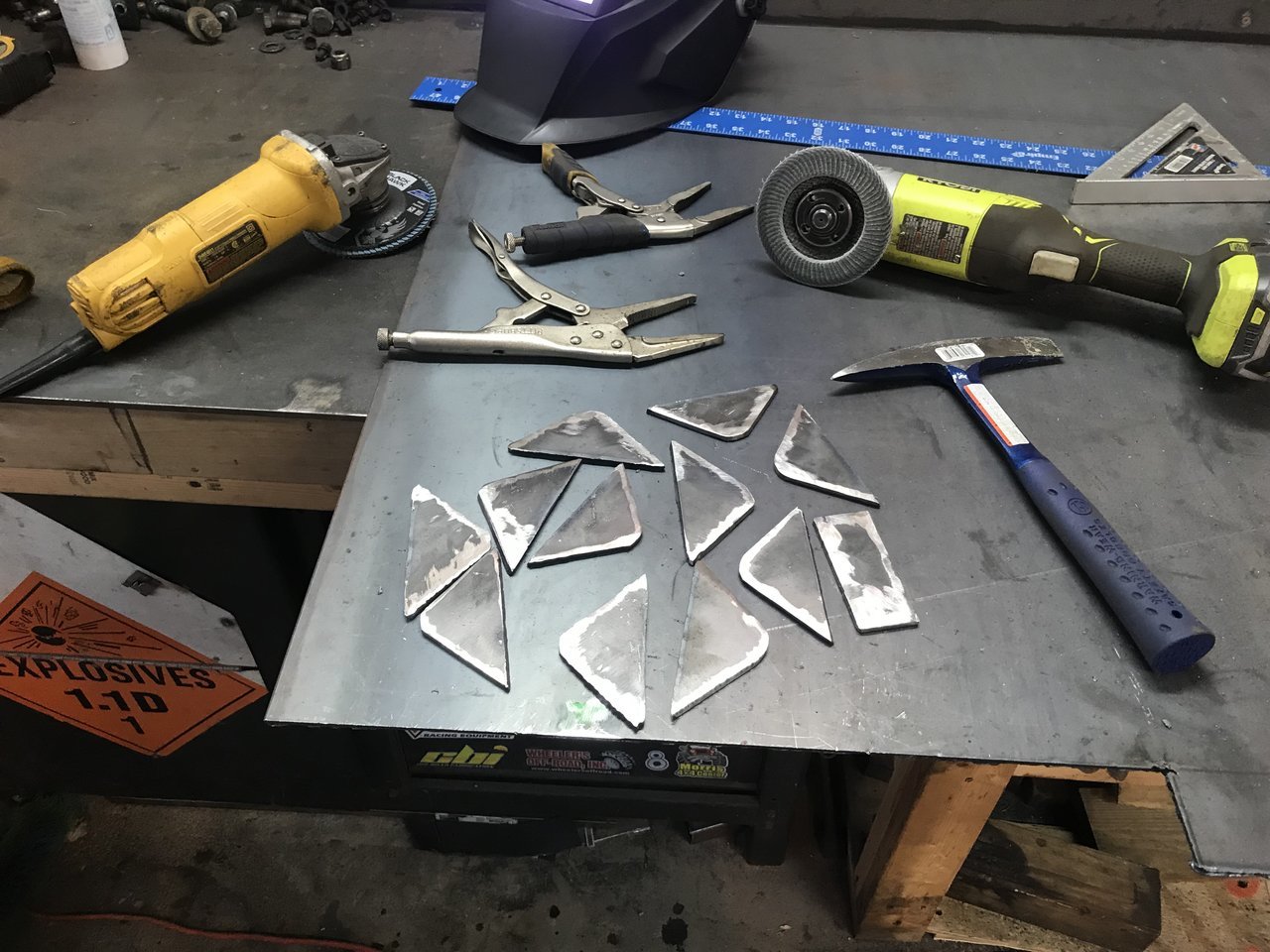

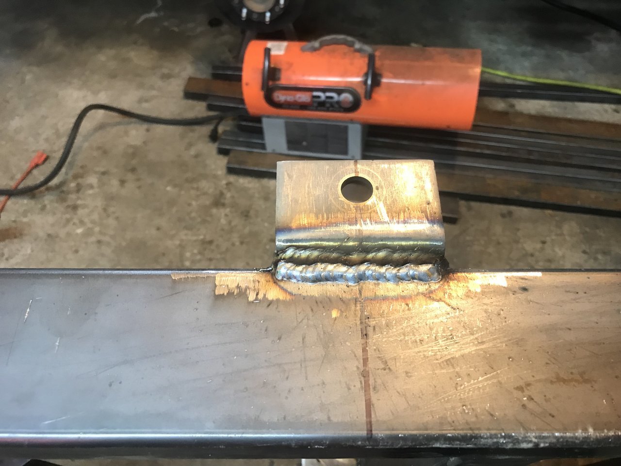

    Gussets
    Hangers. I did a double pass on these.

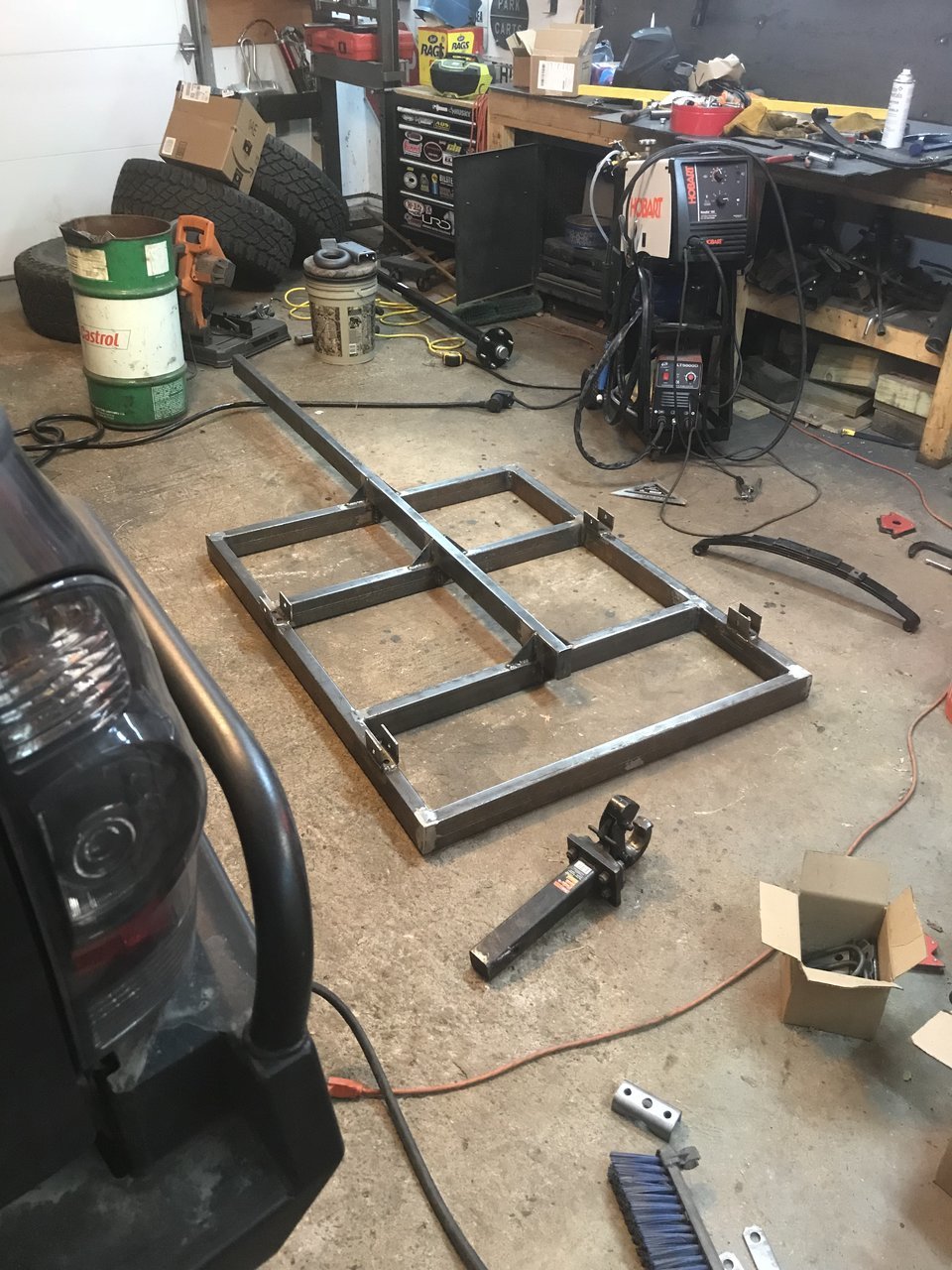

    Where I left off today

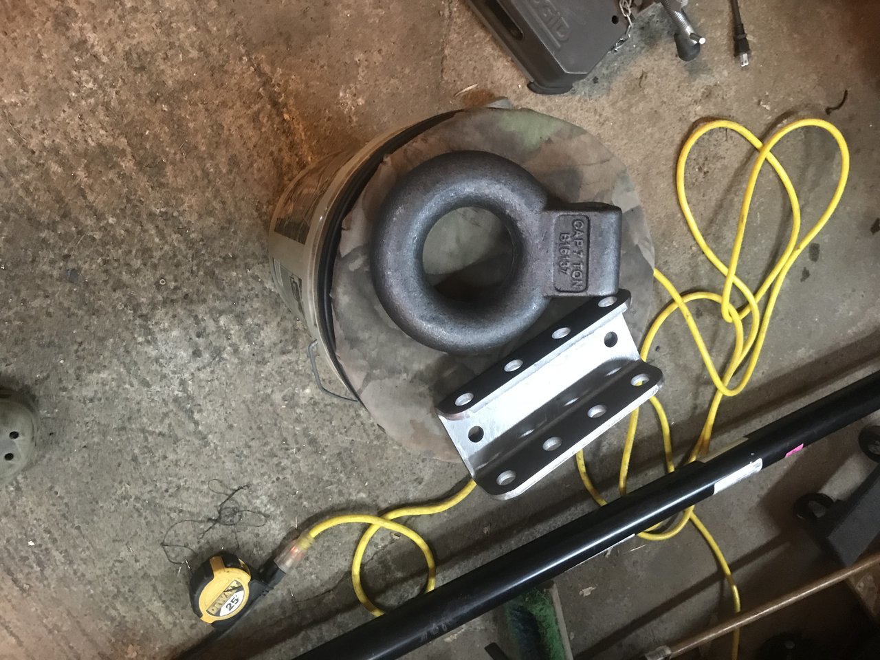

    Weld on lunette arrived today

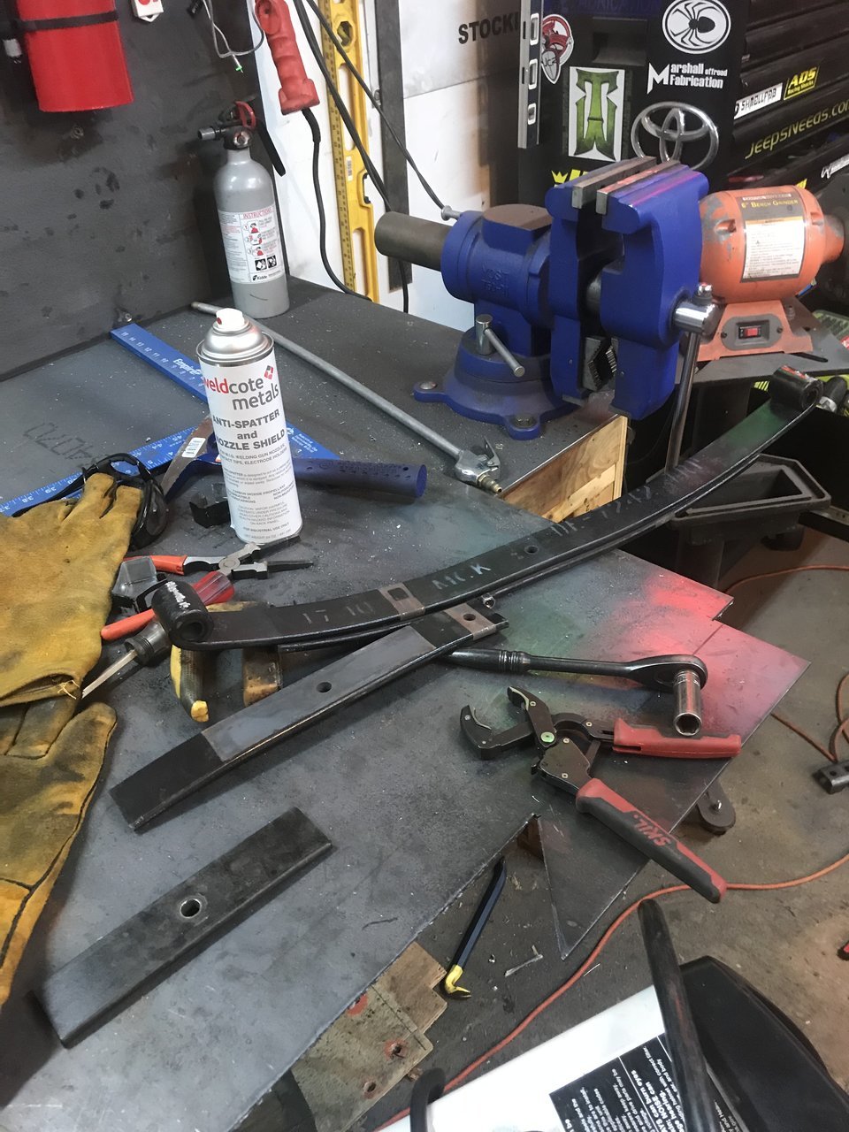

    Removing leafs from the 3500 lb springs.
