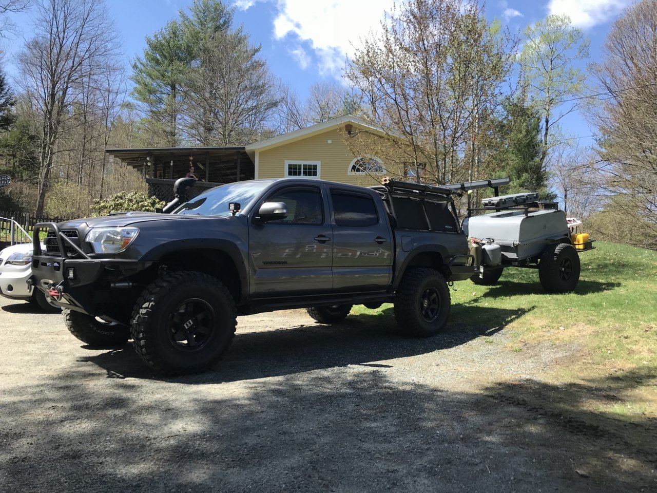

    Honestly, I don’t like the hitch carrier. I doubt I’ll even use it anymore. I just left the option because I could easily do so.

    It was. I can’t use the carrier on a trail, and it takes too much weight off the tongue.
    The trailer tows fine with it on, but the Lunette bounces in the pintle too much.

    What shocks and leafs did you get to use on this thing? Im redoing a 94 teardrop and it bounces like crazy!

    The axle is a custom width 3,500 lb. springs are 3,500 lb with the bottom two leafs removed. The shocks are meant for a T-bucket and are from Speedway Motors.

    I also have a custom 3,500lb axle, but the trailer came with a single leaf and there is no leaf hangers so it bounces a lot!
    I will have to build a custom shock mount for the shocks, also should install some brakes on this thing. im sure it will be very helpful going down hills.

    Nice. With the setup I have, the trailer doesn’t bounce. I’m sure you will be much more happy once you add hangers and shocks.
