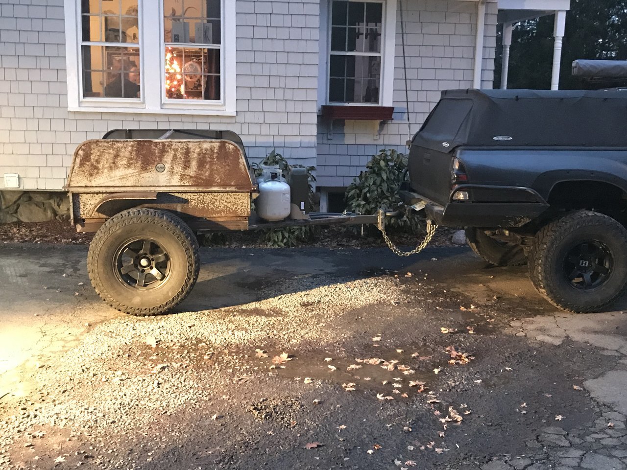

    The track width on mine is 6’. Truck is 6’6”.
    I would’ve made my trailer a little bigger, but the size was predetermined.

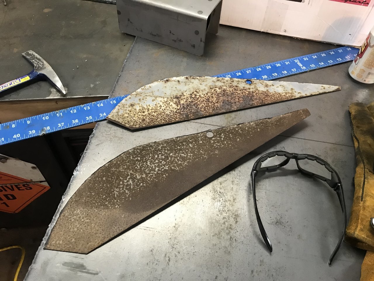

    You know? The more I think about it, I don’t think I’m going widen those original fenders and use them.
    As much as I’d like to see the trailer that way, it’s just not practical. I think I need to make fenders that aren’t going to bend when they’re up against a rock or a tree.

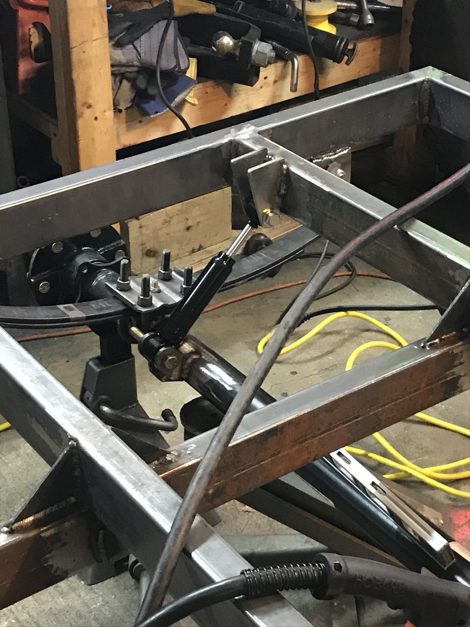

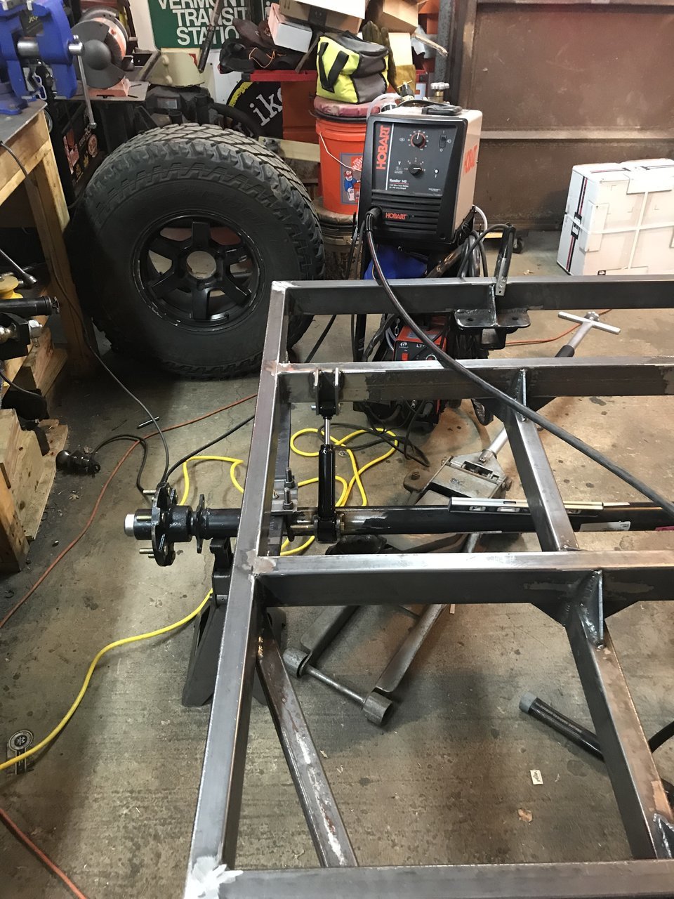

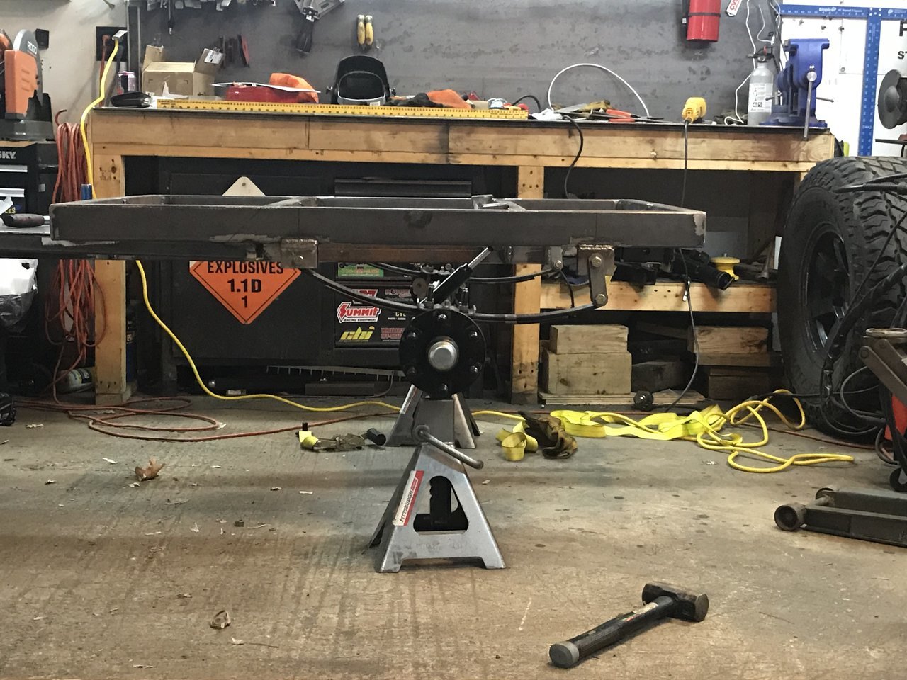

  10. Jan 26, 2018 at 4:53 PM
    #130
    Bocsy44
    Bocsy44 Well-Known Member
    Mar 30, 2016
    #182850
    5,196
    Erik
    Ottawa, ON, Canada
    09 DCLB Sport
    This that and the other thing.

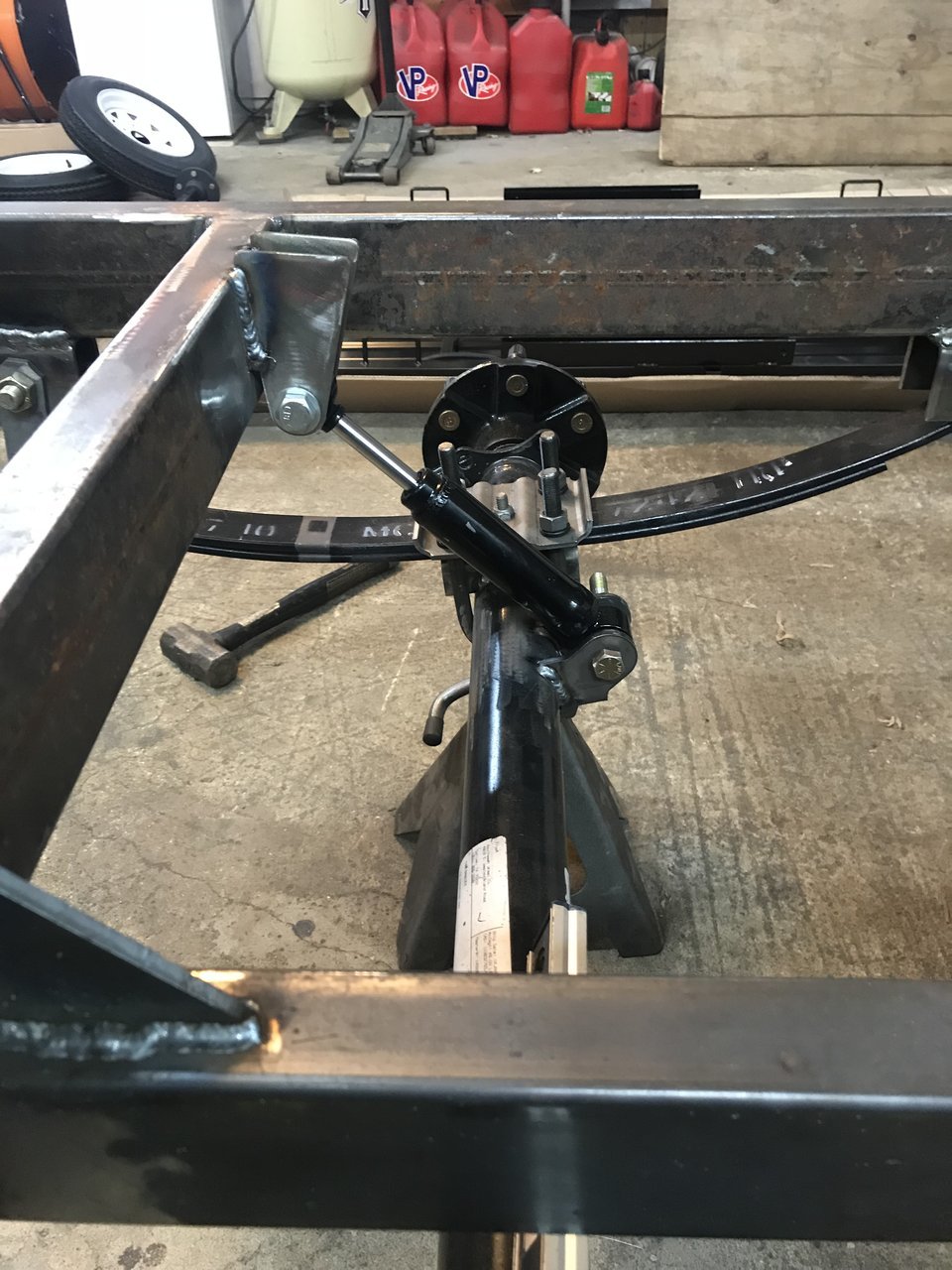

    that's pretty cool haha was not expecting that. what would be the advantage?
  11. Jan 26, 2018 at 4:58 PM
    #131
    HolyHandGrenade
    HolyHandGrenade [OP] NOOB
    Mar 25, 2013
    #100579
    11,801
    Tim
    Garage Most Likely
    DCFB (RIP)
    Some Stuff
    To lessen the bounce :thumbsup:

    Running lower tire pressure with all that rubber between the road and the rim will help too.

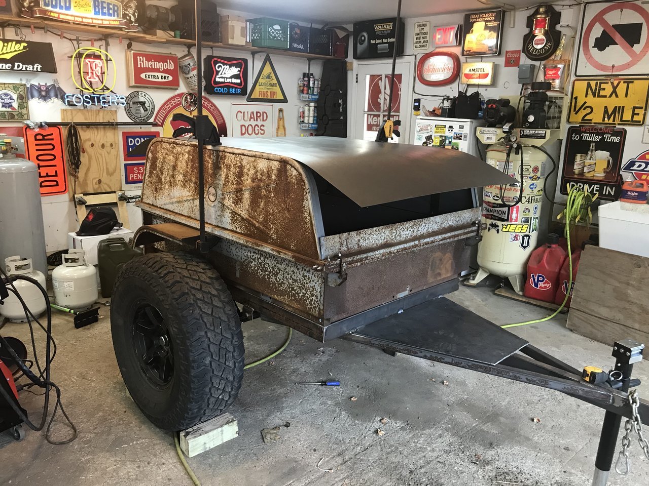

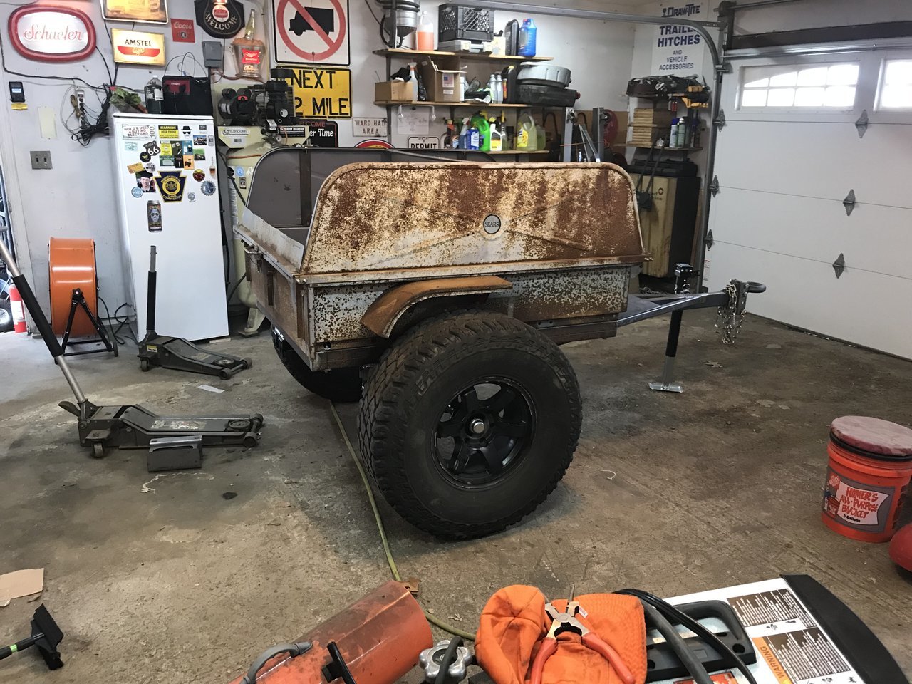

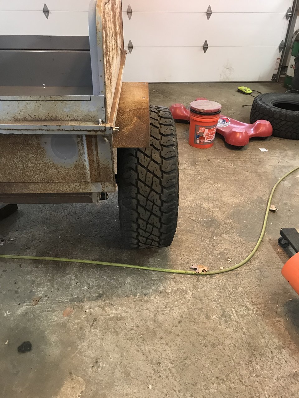

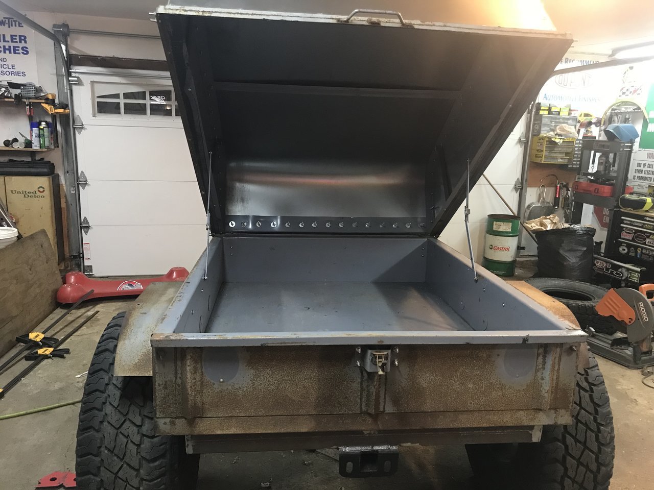

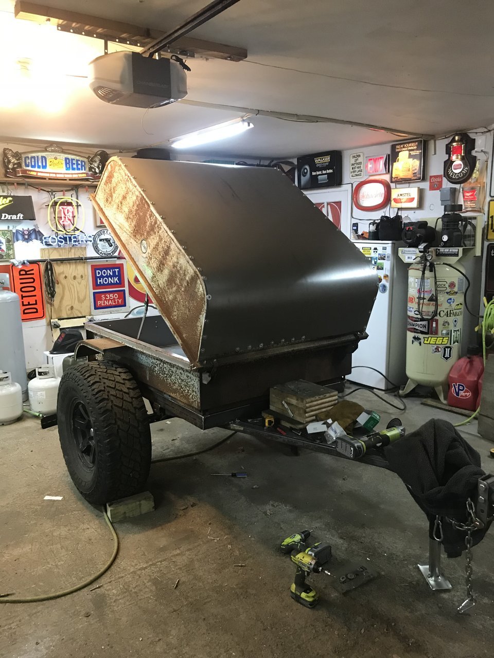

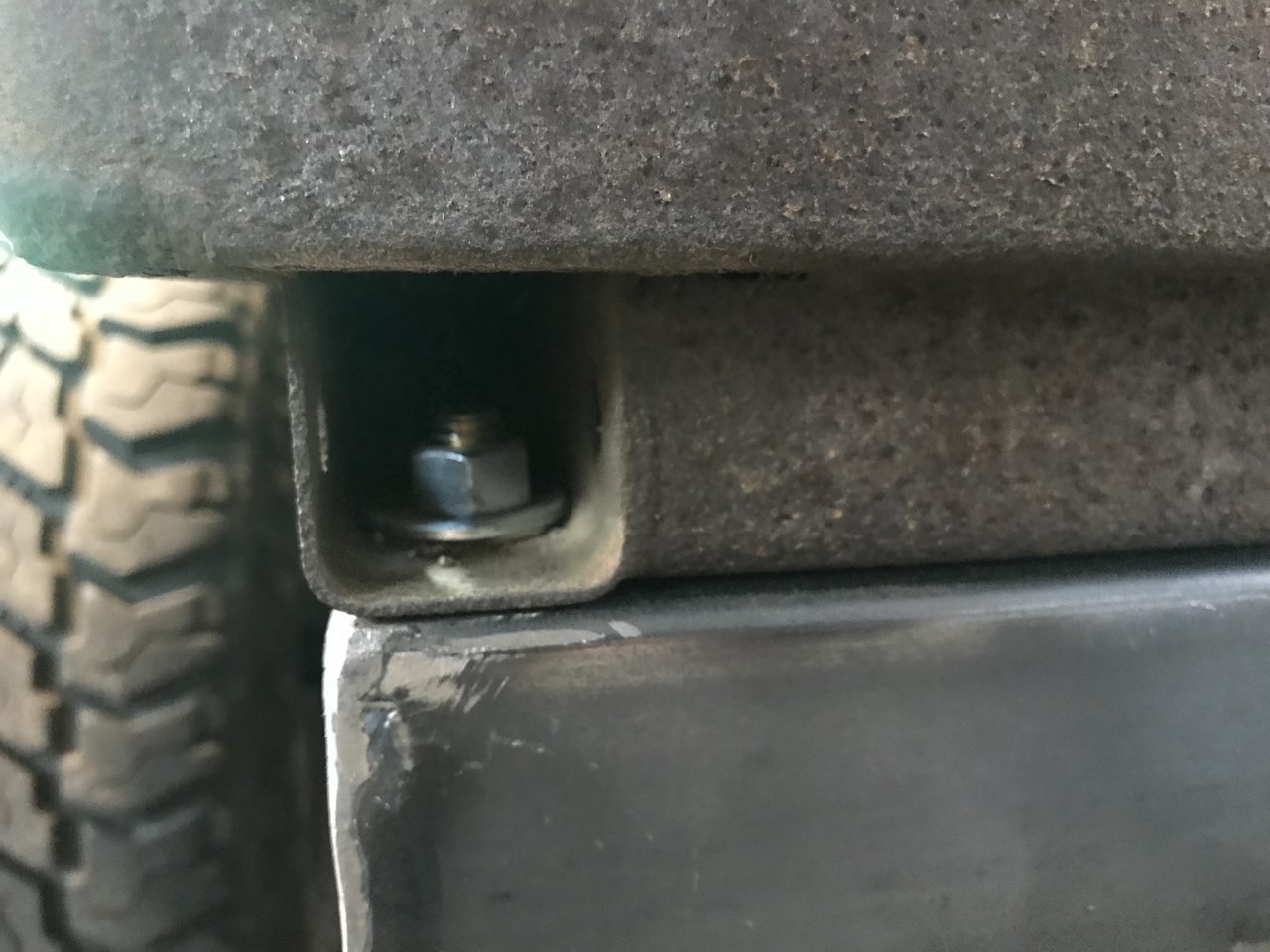

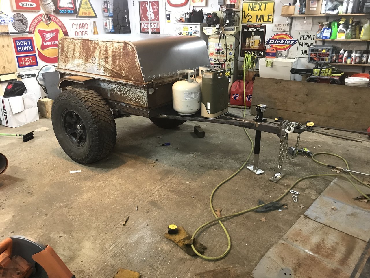

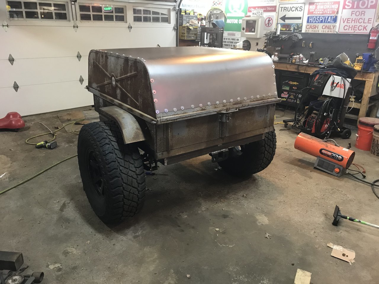

    I’ve been busy.
    I really want to use these original fenders somehow. I cut them and bolted them on.
    I can’t decide where to go from here. I can widen them, order 4-1/4” rubber flares from Low Range and add them, or cut more of the lip off and run them as is.
    My truck will shower the trailer with whatever is on the road anyway.
    Got the body bolted to the frame with 1/2” grade 8 bolts.

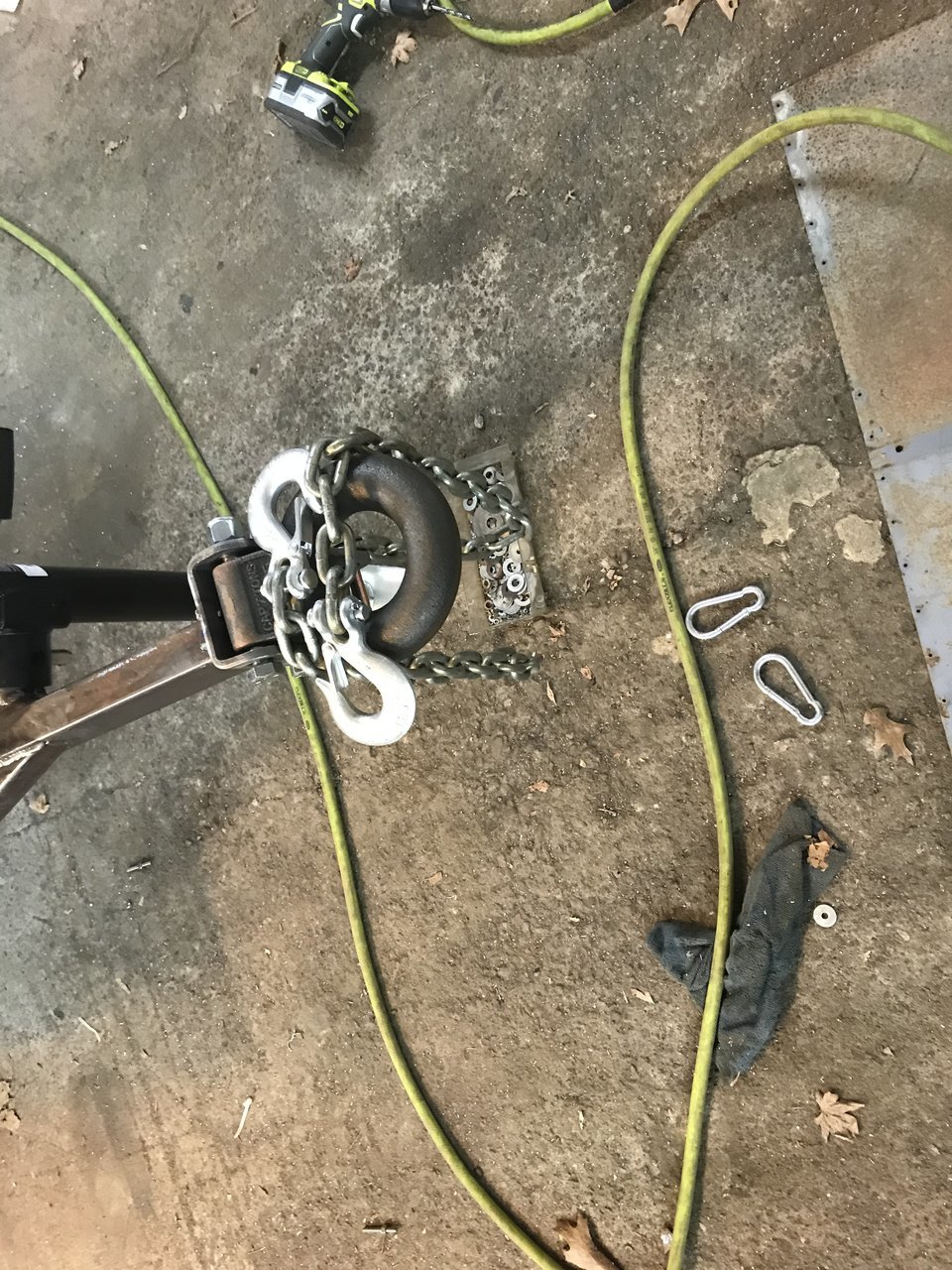

    Safety Chains

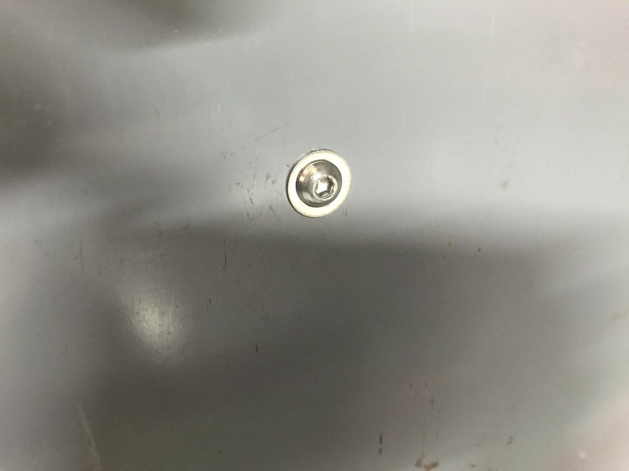

    Picked up the 20 gauge sheet metal and skinned the roof tonight. It looks a little silly with the giant washers. They will be replaced with smaller stainless ones pictured below. I ran out... that’s seventy 1/4-20 bolts. All stainless. If it’s not grade 8, it’s stainless on this trailer.
    As you can see, I have a lot of bolts to cut off. I was scrounging around using every stainless 1/4-20 bolt I could find. In the end, I was using 2-1/2” bolts to hold sheet metal together lol
    I thought I was going to have to buy a drop plate for my Pintle, but it actually matches up great.

    I’m getting close to blowing this thing apart for paint. I’m going to make a simple roof rack tomorrow.
    After that, a rear bumper, and figure out the fenders. Then, the fab work is done.
    Paint, assembly, wiring, camp.
