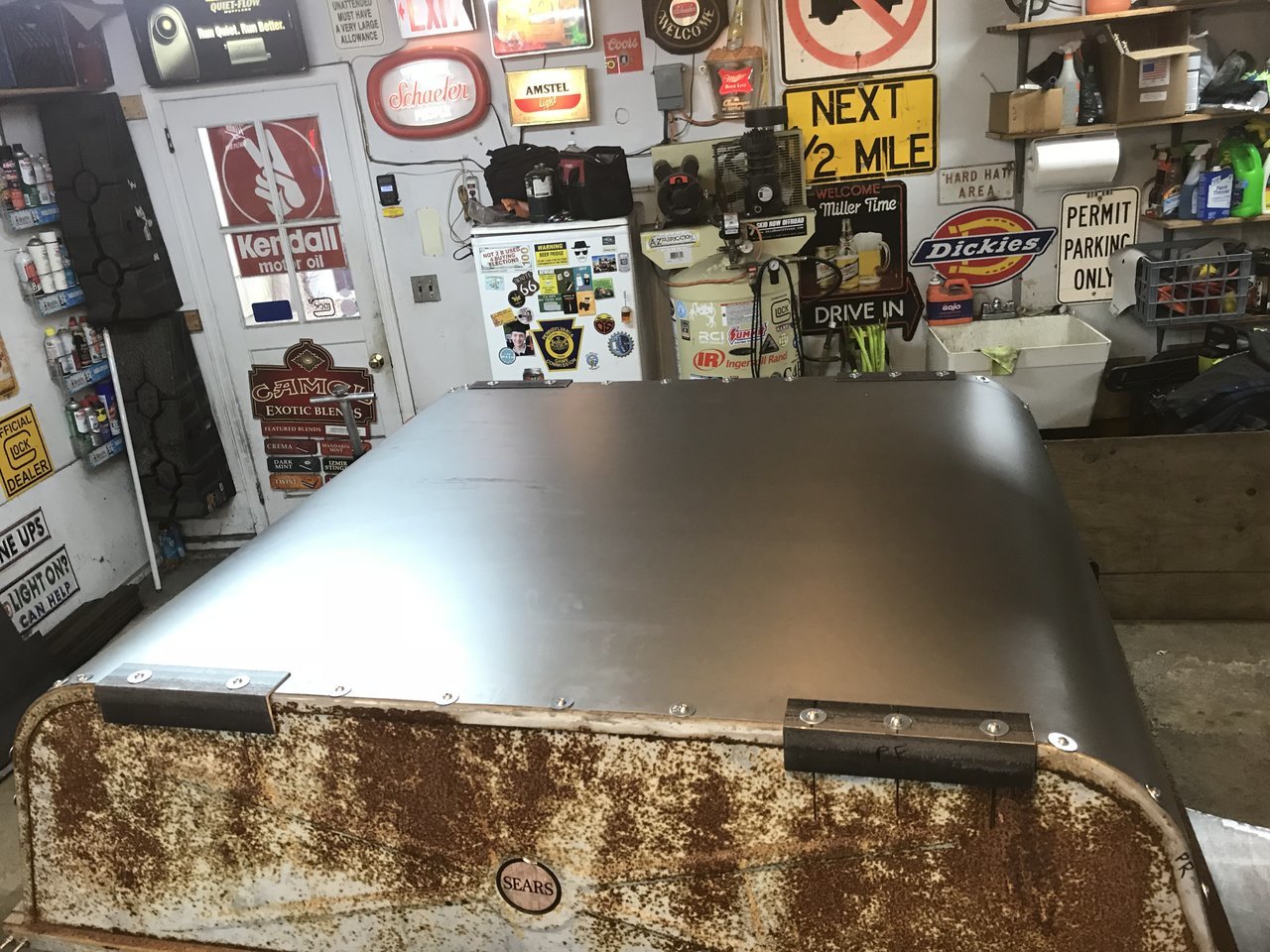

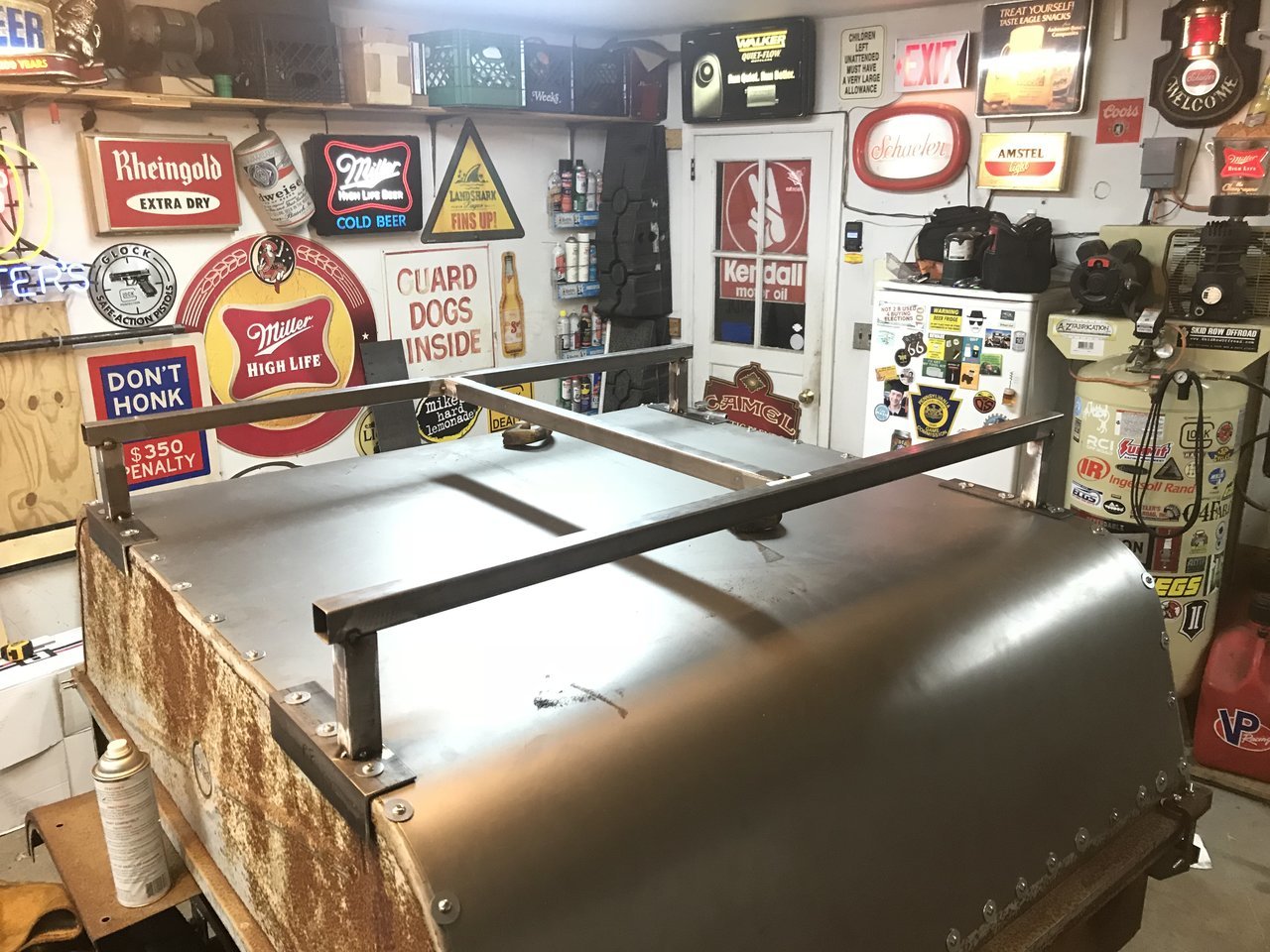

    Dude this things coming out so well! Any reason you went the bolt route to put the roof on and not simply rivet them?
  5. Feb 1, 2018 at 7:36 AM
    #145
    HolyHandGrenade
    HolyHandGrenade [OP] NOOB
    Mar 25, 2013
    #100579
    11,801
    Tim
    Garage Most Likely
    DCFB (RIP)
    Some Stuff

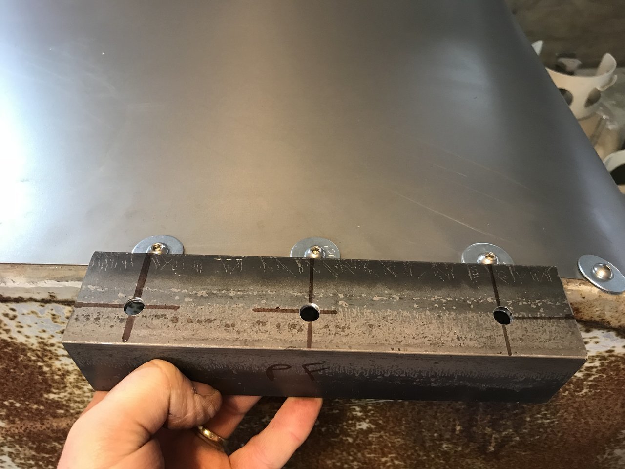

    Thank you Mike. A couple actually.
    Where it’s bolted it’s a couple of layers thick with a space in between. Rivets just wouldn’t have worked.
    I also wanted to fit it before painting it. Now I can take it back off easily to paint the pieces where they meet before putting it back together.
    Also, if the roof is ever damaged, I can change it much more easily.

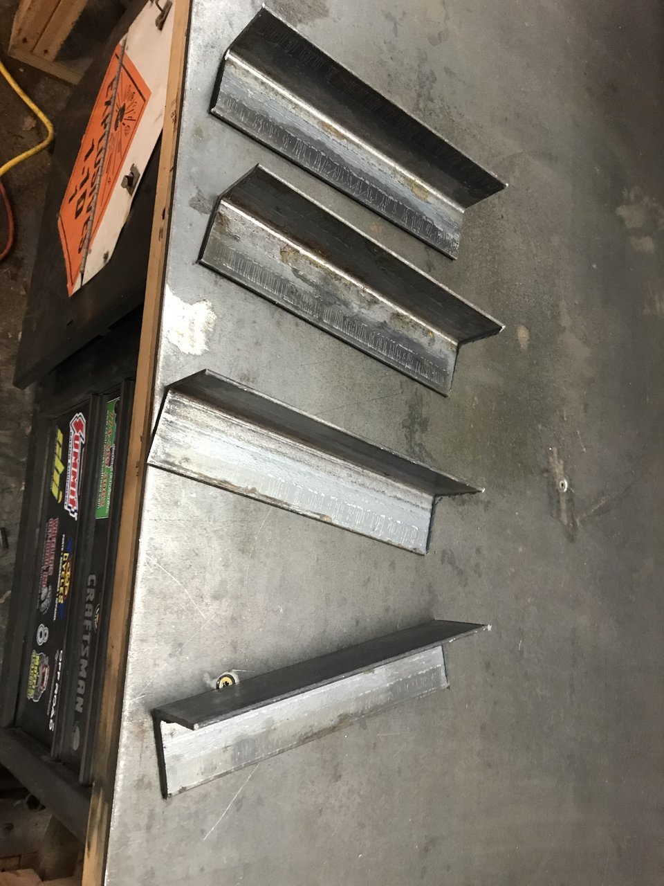

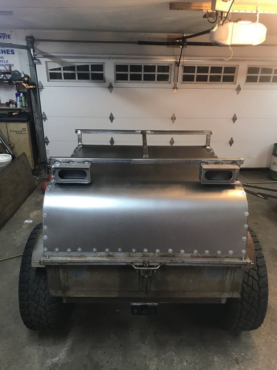

    Roof rack
    I found this 36” piece of 1/8” angle. So, I made four 9” feet. The feet sit over 1/4” side reinforcements that the original owner of the trailer added. (Last pic)
    I bolted the feet on through the holes that I made to attach the roof skin.
    I bought these oval light boxes off eBay. I was planning to hang them off the rear frame, but I realized that the hitch carrier will block them. If I’m towing this trailer, chances are, I’ll have my cooler.
    Best part? The rack is even Fat Guy Rated

    So what’s your though process on the box lights?
    I would think a couple of LED strip lights under that bottom lip would work great!

    The light boxes hold standard oval truck / trailer lights, and have 2” round marker light cut outs on the side.
    I bought oval LED truck lights that are stop, signal, & parking lights. They are also dual color and have white reverse lights.
    That’s why I bought a 7 pin harness. So I can have reverse lights.
