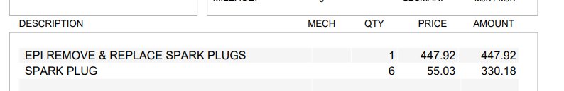

    I just stopped by a reputable local independent shop - asked for an estimate on spark plug change.
    Wait for it, MORE EXPENSIVE than the stealership.
    Stealership was about $700 and change + tax.
    In fairness, Chapel Hill Tire said they'd consider matching the Stealership's price if it was lower, which it is.
    I will call a few more shops, but I will be shocked if anyone is significantly cheaper than this.

    Called another shop..... $482 + tax for spark plug change, NGK plugs.
    I can def live with that compared to $800.

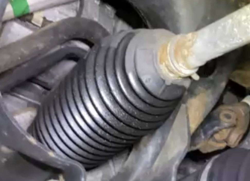

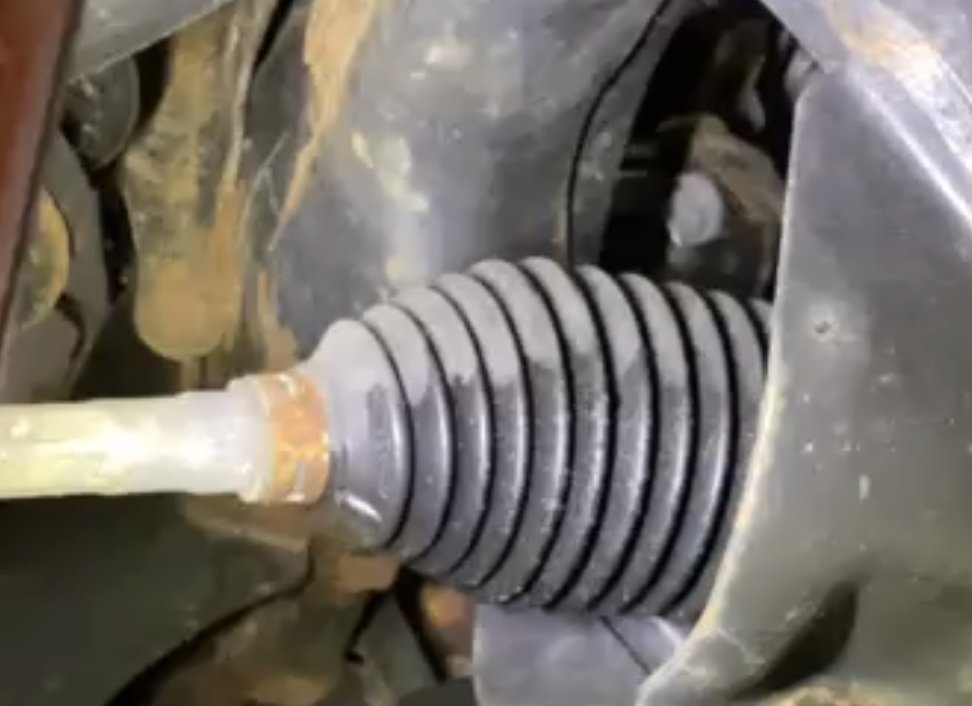

    Just brought my 2020 in for 60k spark plugs and transmission drain and fill. They're telling me I need new rack and pinion, both sides, $2,500. I declined the service. Still have to go pick it up and look at it. Did a search and guess it's not uncommon for these trucks? I'm in a bit of shock. I don't even off road.

    They have been telling me this for my FJ for the last 10 years! I suggest you crawl under there and look at it yourself. If it has a minor weepage stains on the boots and your reservoir is holding steady, then drive on brother. Just periodically take a look to make sure it's not getting worse. Not all minor leaks require addressing.

    What is the mileage on the truck? 60,000? as per above? (reasonable for a 2020) If that is the actual mileage, something smells. Also: what does "both sides" mean? The normal symptoms of a failing rack are fluid leaks and loss/drop of fluid as indicated on the power steering reservoir. Fluid getting past the internal seals can show itself as damp boots as the fluid slowly collects in them and presents as a "damp look". Check those boots on your truck.
    Beware: especially with that "both sides" claim. Unless they have changed the design, the rack is one unit. Watch the fluid level in the reservoir and get a second opinion: the rack is a ridiculously expensive item... not to mention the labor to R&R it. ($$$)
    FWIW: I had a dealer tell me my rack boots were "damp" and the rack needed replacement. When I got home I checked the boots on both sides: >>Bone Dry!<<, and the fluid level right at the "hot" line where it has been for the last 40,000 miles and four years since I got it. (current mileage: 142k) I never went back to that shop.

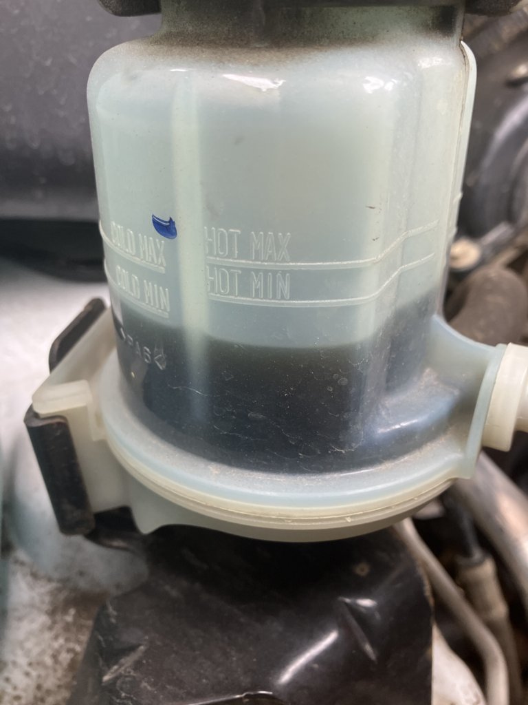

    Hopefully I uploaded the pics correctly. right and left boot. mileage is 60k. The reservoir was low.

    My passenger side boot is lightly damp, reservoir is down, but within limits.
    I plow two properties, both in the woods, and it’s a lot of turns, lock to lock. Gonna let the seals weep, one day it will be my turn to weep

    Spray the boots with a gentle cleaner rinse them with a clean-water spray (spray bottle) and monitor. Again: watch the fluid level for any loss, and keep it at the proper lines on the reservoir. I cleaned mine, and the only thing that has returned has been some light dirt and dust.
