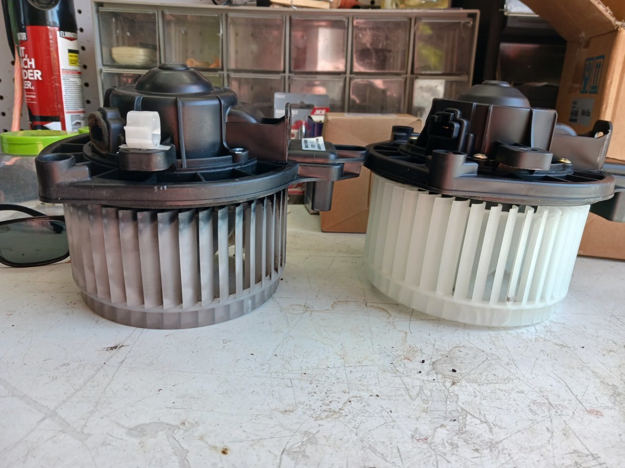

    :pccoffee: Good Morning Porch Pals & Sue! Well, nice; cloudy and warm this week. So, today is the day for the new blower motor, and doing the resistor pack while I'm there. Having to kick start it too regularly. Parts are here, so....

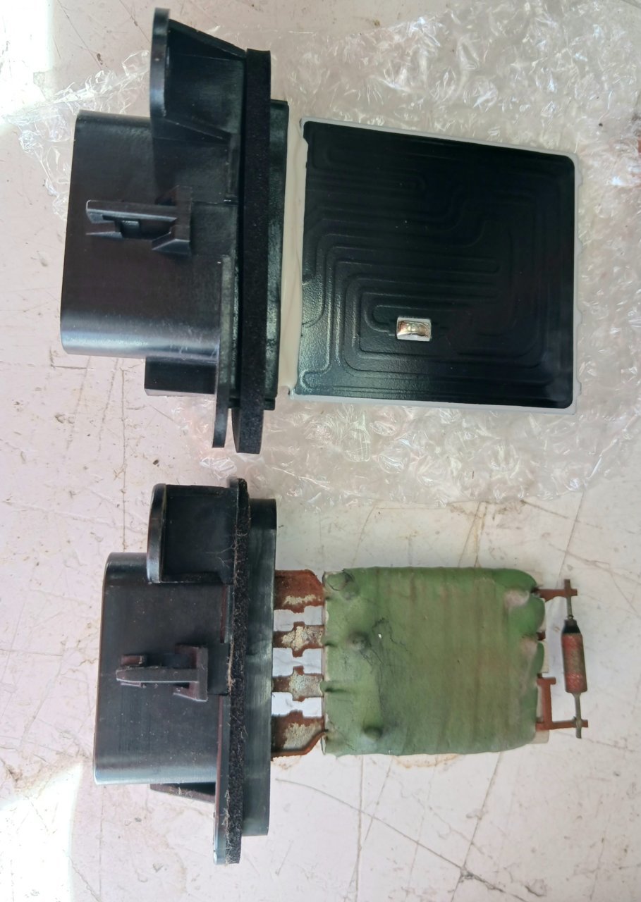

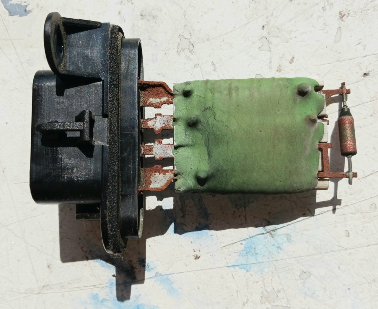

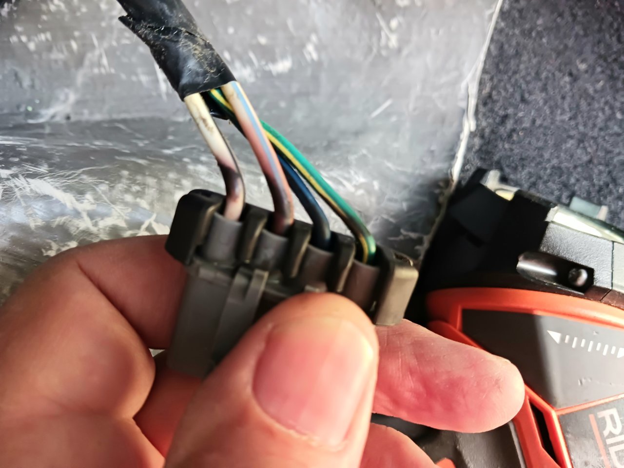

    Wow! I got lots of blower now!

    :eek: That's one reason why you don't buy anything that was in a flood, especially salt water.
    How did it get that bad, my 66 doesn't even have contacts that look that bad.

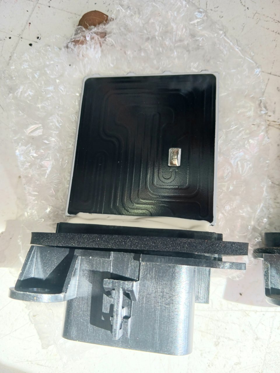

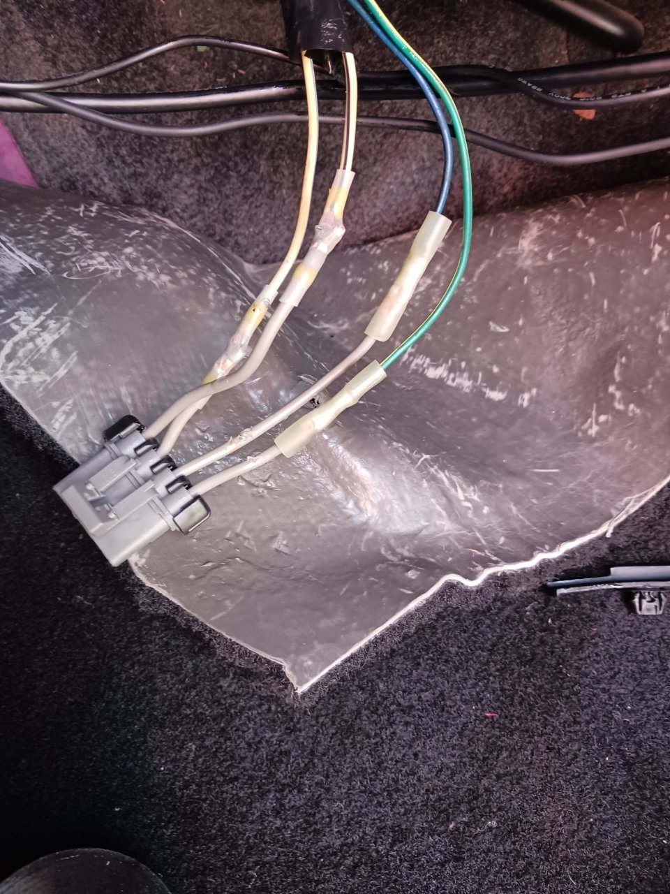

    Never under water. Second generation have this issue, and that specific contact, on the resistor pack. Blower was sporadically quitting on me. So I got both, and ordered the resistor that came with the connector. Planned on doing both anyway, looks like just in time.

    Never run the blower on low.
    Too much resistance. I always run mine min second position and adjust with temp dial.

    Something about the design..... These things point straight up, into a "void" that seems to be where fresh air from the outside vent enters the blower. Since I can't see inside, it's a guess that some "fresh air" might have been used to cool these old resistor setups. I don't know - my guess. Since the replacement is a LOT different!
