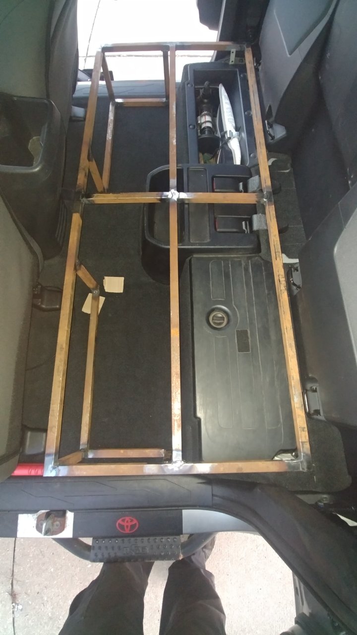

    Steel frame nearly complete, bolts into stock seat location:upload_2023-3-25_15-10-43.jpg

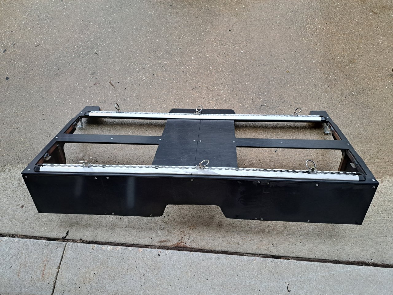

    With much of the HDPE riveted on:

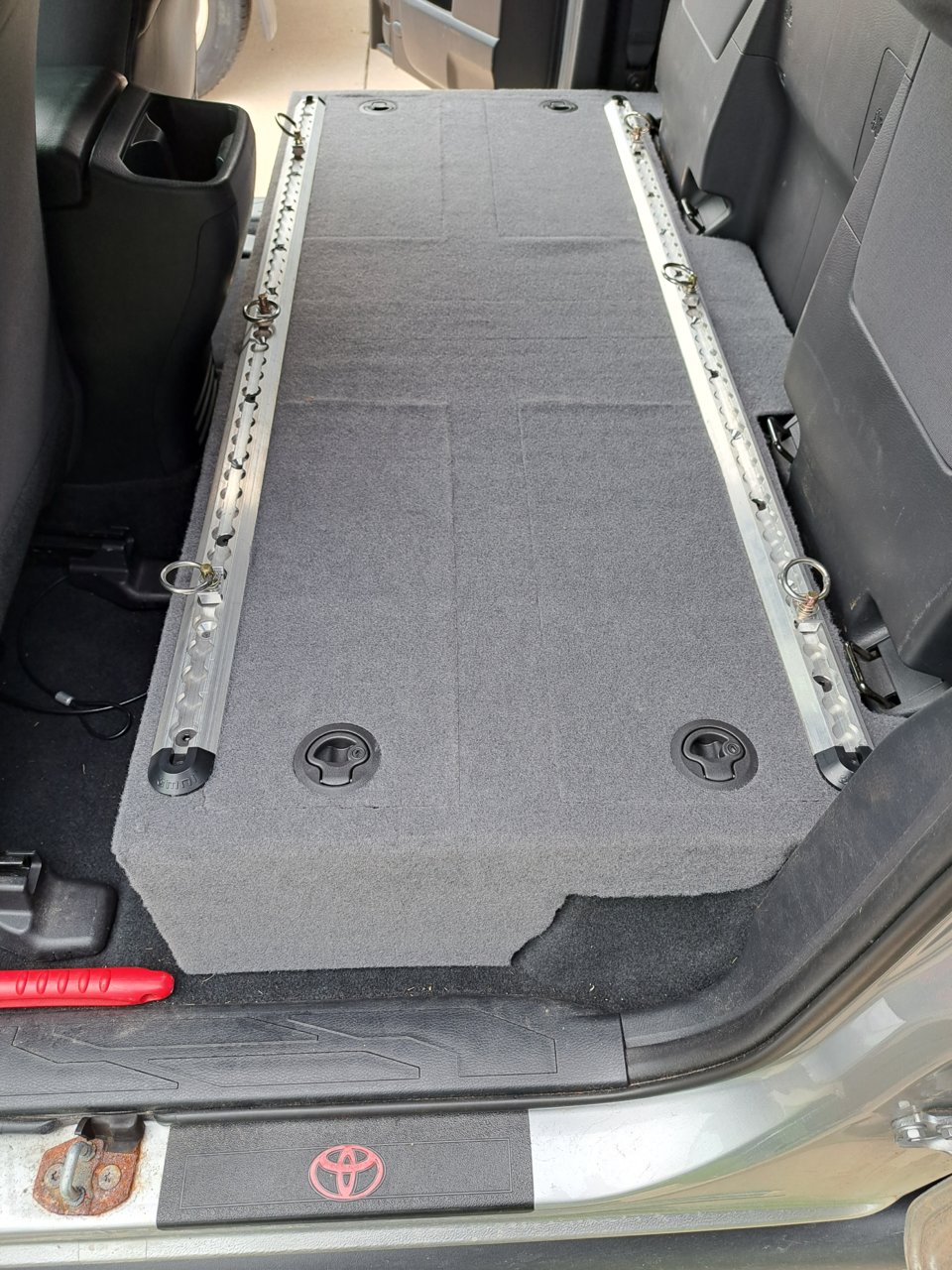

    Completed, wrapped in automotive carpet, lockable access doors:
    Hope this helps.

    That's some fine work there, Rich.

    Well done.

    Thanks. It had been a long time since I had fabbed anything of mention and was a lot of fun. The welder was happy to get out of the back corner of the garage too!
    As you can see, most of the cost was the HDPE and the aircraft track. It will do just about anything I could imagine.

    How about a pic with lid open showing hinges and latch, please?

    No hinges, the panels just lift off. You can see the latches in the pic. On the other end of the lid, I riveted a strip of aluminum to slide under the HDPE and hold it down.

    That's very clever
