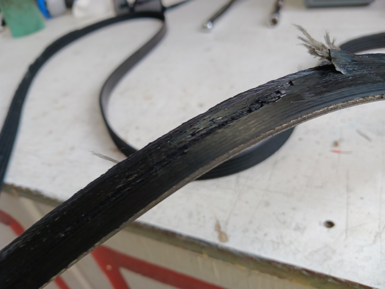

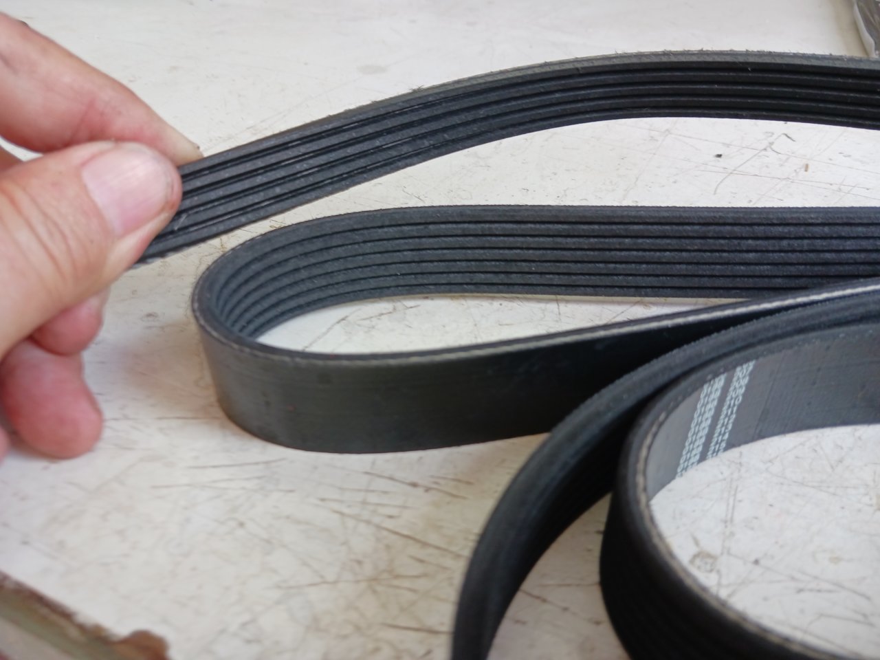

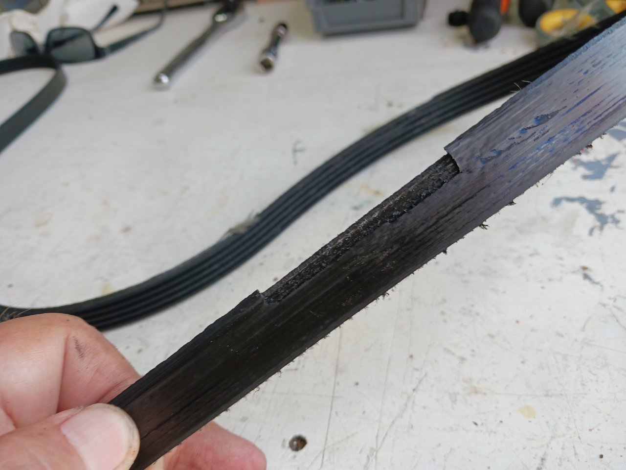

    Not really! 45 days! Don't buy a Gates belt. It looked old when it went in, but I didn't think it really was! I'll find the as-new pic tonight.

    I was going to ask if it's a non Toyota belt.

    Yikes, 45 days? Where did you buy it; a few years ago there were many reports of Amazon selling counterfeit "Name Brand" belts and pumps; genuine Gates belts are usually solid.

    Time to check the tensioner and that all the pulleys are in alignment and don't have any burrs.

    And it was Amazon. Our AutoZone had nothing. It replaced a Continental, which was their best. Grey rubber, no feel to it. I am back to a nice black Continental.

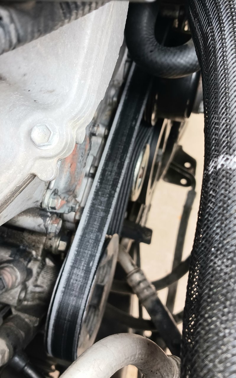

    Tensioner has plenty. Idlers replaced with water pump last fall. Everything spins nicely. Grooves sit square. I'll be painting my striped edge, to see any edge wear. I can't find any slicing edges that would hurt it.

    Sadly a counterfeit.
    Amazon will buy from a dozen wholesalers and toss them into a common bin.
    It made it super simple for counterfeiters to supply and not get caught. There have been discussions of a label to track supplier and lot number, but not sure if they implemented it.

    The whole reason I started this belt thing, is because I had ordered a "spare" Continental, and last night it hit me over the head. All my complaints about potential starter problems, might really have been this belt slipping when cold, it started right after replacement. Only happens when it's been sitting, so could never duplicate it for any one. (Don't start with it was all in my head!!) The guys that replaced the plugs, noted I should consider a new belt, and it was only a week old. As of last week, it still had all the grooves. So, that close to throwing another grenade into poor Little Big Red!
    So, now I see if the problem is gone.

    Well, first full load starts ok. Wear bands marked, so I can easily see if I'm losing an edge again.
