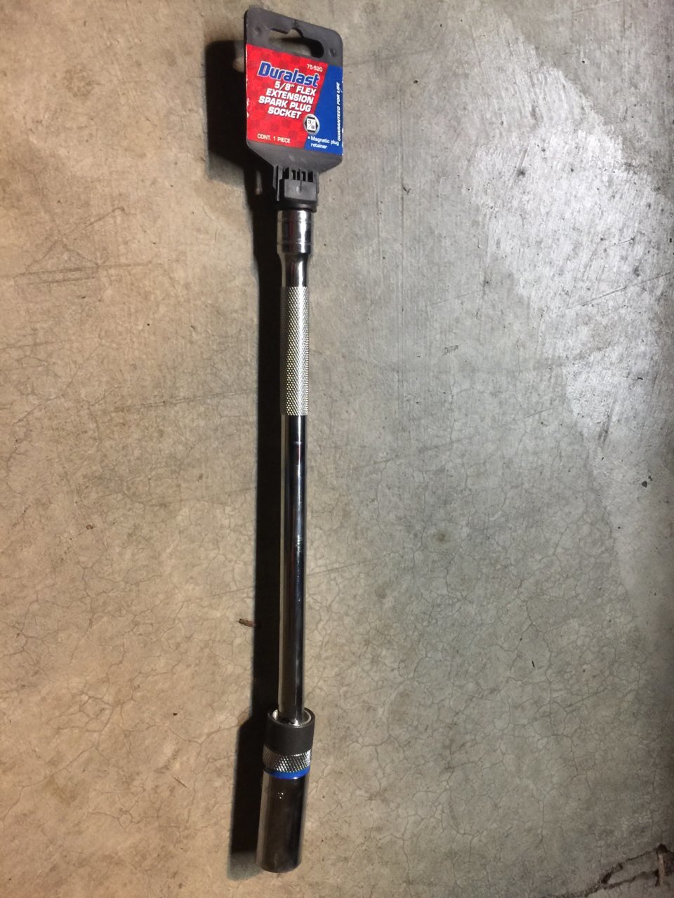

    It’s pretty darn easy to do. Done it twice now because I put the wrong plugs in the first time. Driver back is a bitch, but with a good flexible spark plug socket with long extensions your will be good. Tighten them to spec torque of 12ft/lbs (if I remember right) double check that...
    If you decide to do it yourself. Put towels on the fenders and use a small step ladder for leaning in/leverage.
    As always, don’t force anything, have an ice cold beverage and take yer time

    I've loved these extensions since the '80s when they came out. Sooo handy I rarely use a straight extension for anything anymore.
    edit: just noticed that this is a manufactured together with socket ext. but find just the wobble ext.'s with a socket indispensible for just about everything now.
