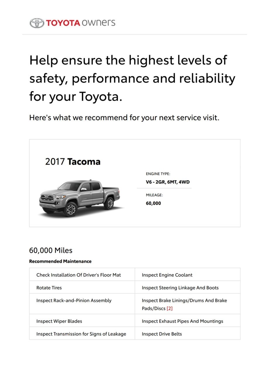

    Im working on my 60K maintenance and am done besides replacing the spark plugs, and engine valve clearance. I found a guide for the spark plugs. I cant seem to be able to find any info on engine valve clearance. Can anyone point me in the right direction?

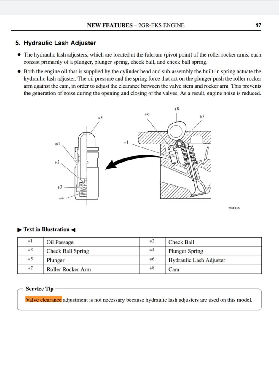

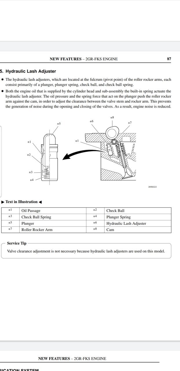

    9,869
    service manual says there is no direct valve clearance adjustment for the 2gr-fks, because it has hydraulic lash adjusters. but listed at 60k.

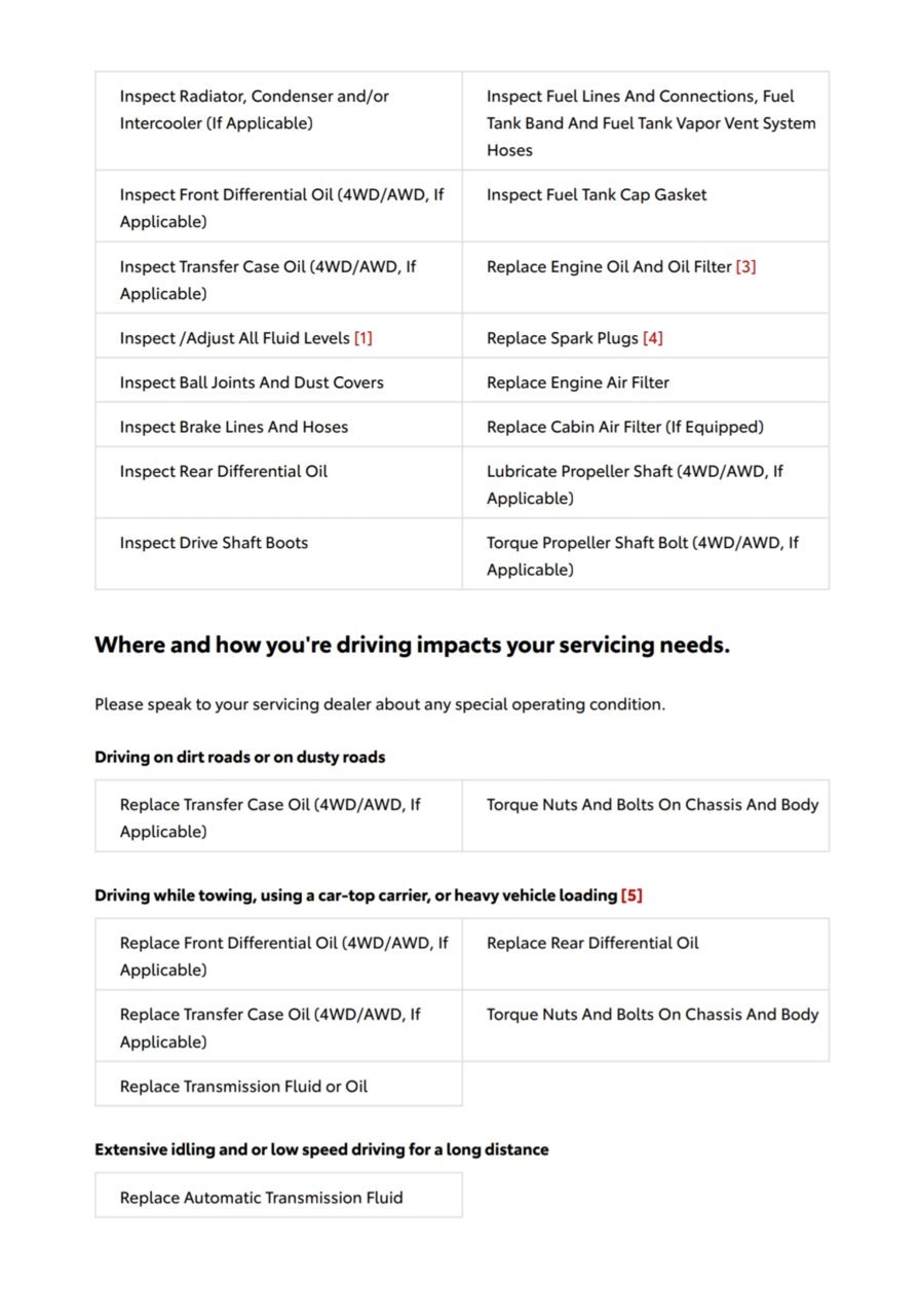

    Where does it say valve adjustment?

    Good point...
    From the service manual....
    Valve Clearance: Specifications
    The 2TR-FE engine uses a hydraulic valve lash adjuster assembly. Adjustment is not required
