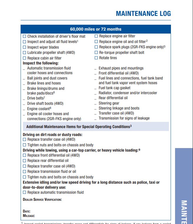

    He recommends drain and fill only at 60,000 miles or 6 years for your transmission also... ;)

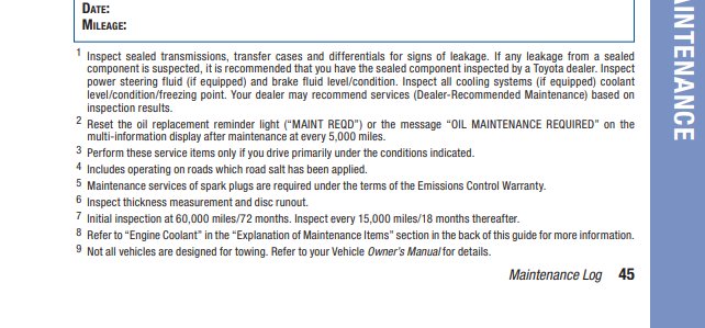

    The OP has a manual transmission. It appears you may have been thinking of the auto.
    The manual transmission is not "sealed"...just a drain and fill procedure.

    Each trans and environment is different. Mitsubishi dual clutch automatic...due every 20k. 3rd gen Tacoma automatic...I would go every 50-60k. The OP's transmission, you can't flush it so your only option is a drain and fill.

    To be fair, I was referring to the OP's transmission, I did miss the Manual trans part, my bad on that...
    But the TC-SST is more of a manual than an automatic by design anyway...
    And heat IS the killer of an automatic, so if towing or hauling heavy load a lot, then I would change my automatic ATF every 30K...
