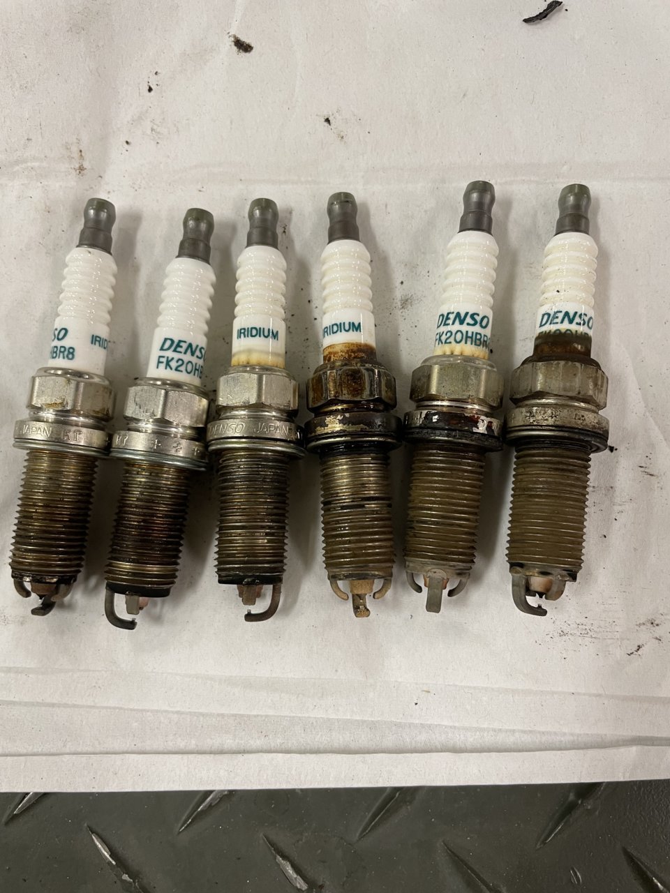

    That’s not necessarily true. I had 2 plugs with blow by on them and gunked up by oil, probably not cinched down from factory is all I can imagine. Here are mine, I believe this was at 70-75k but no reason they didn’t look like this at 60k……
    Did I notice much or any difference after installing new plugs? No. Basically same mileage and drivability. But I would recommend swapping them out at the recommended interval if for no other reason then to make sure they are installed properly. Several posts about this.
