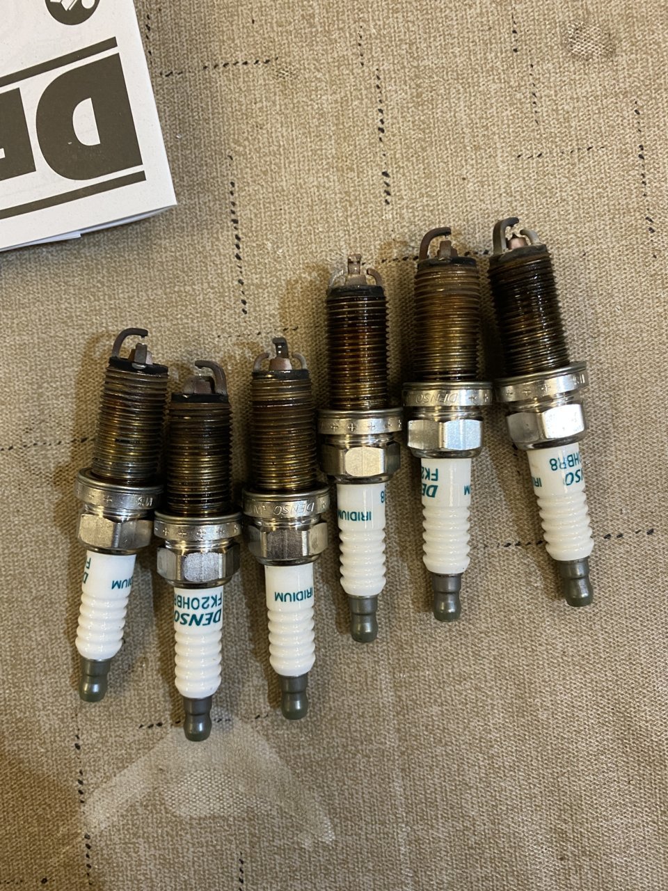

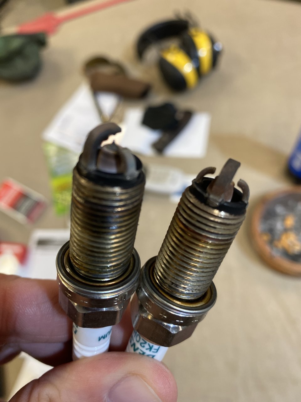

  15. Nov 26, 2021 at 5:25 PM
    #55
    ROAD DOG
    ROAD DOG Well-Known Member
    Nov 4, 2019
    #309830
    2,212
    2019 I4 WHITE SR PRERUNNER
    FEW
    plugs dont look good at all
    so signs of overheating & fouling
    excessive idling.................possibly normal environs yet lots o idling
