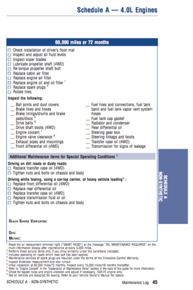

    It'll be in the maintenance schedule booklet found at Toyota Owners
    Damn beat me to it! Here is the Maint. Schedule for 2015 4.0L page 45 for 60k
