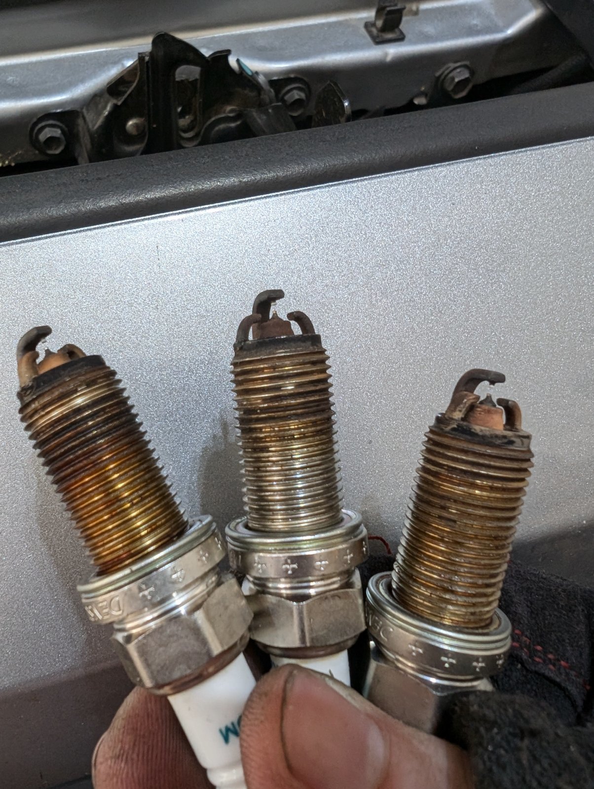

    I did mine at 65k miles and they looked fine. Little porcelain deviation but gaps looked good. Probably could go a little farther on them
