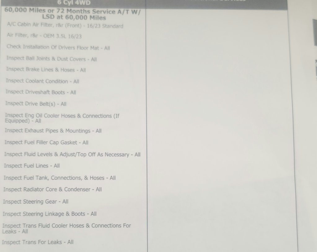

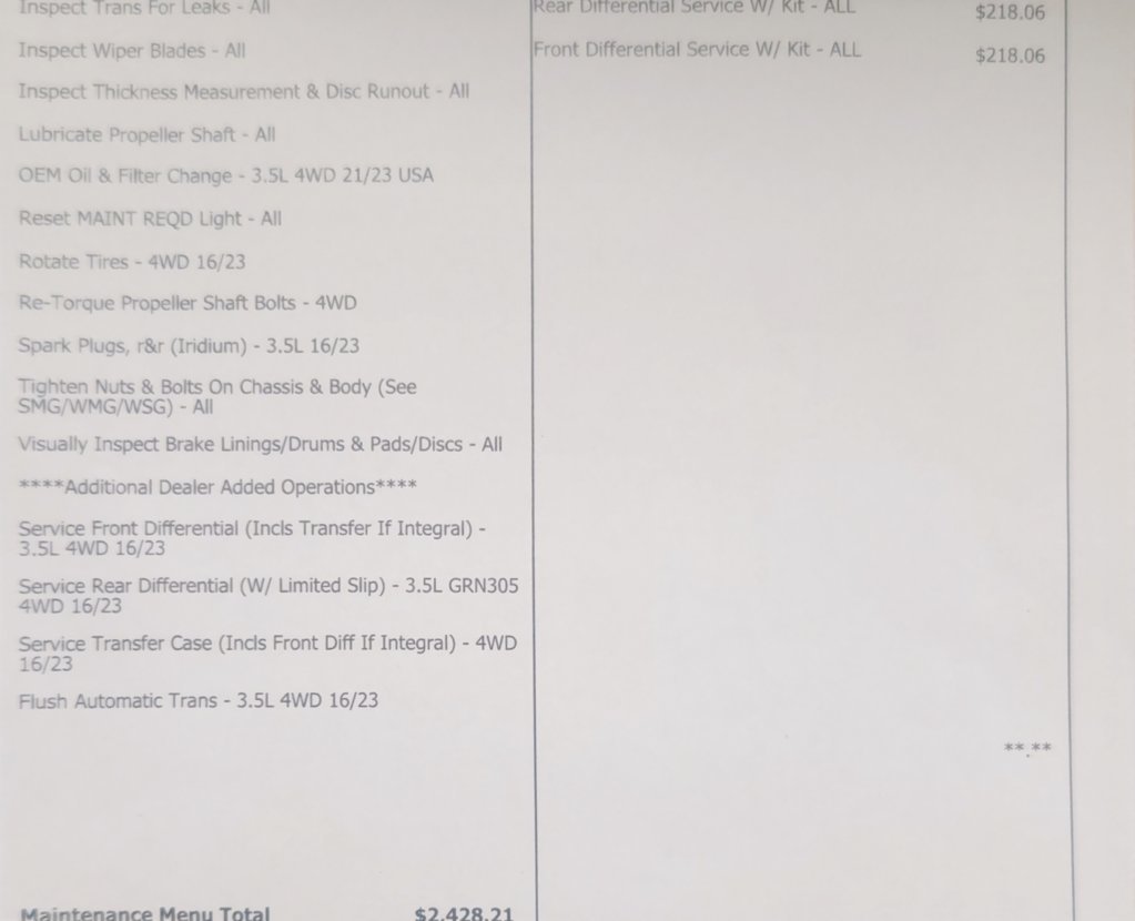

    Appreciate any opinions.

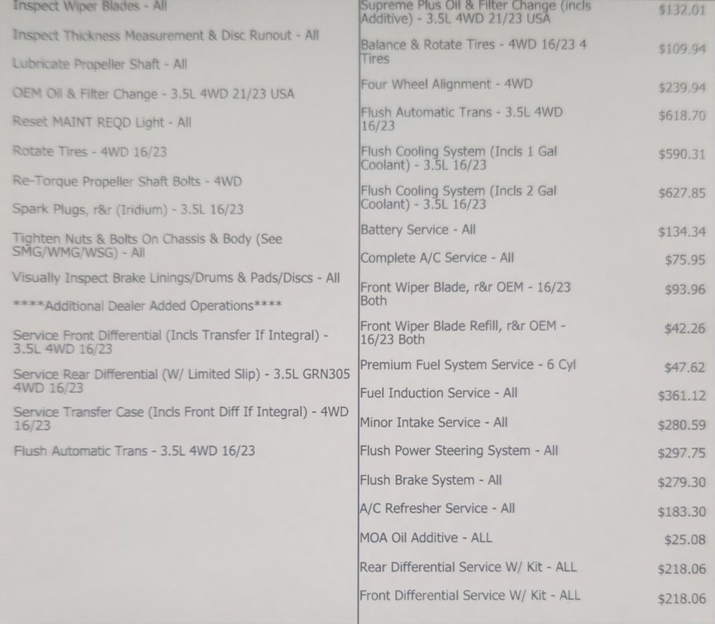

    Wow, please do not let the dealer do that. They will not do 75% of that but they will charge you for it. $110 to balance and rotate the tires. Fuel induction service. LOL.. WTF!
    Notice they have complete A/C service listed at $75.95 and further down they have an A/C refresher service for $183.30.

    You don't 4 wheel align these trucks. You can't.
    And they are charging for new blade AND refills......WTF?
    The 4 I see that "should" be done are
    Oil and Filter
    Transmission Fluid
    Front Diff
    Rear Diff
    The rest can be done at home. Or a small independent shop for a cheaper price.
    A lot of guys never, or only change the transmission fluid at 100k. But you should at least do a drain and fill every 45-60k.
    Pass on the coolant until 100k
    Flush the brakes when you do the fronts. (if you want, I didn't until I did my rears)

    Each individual line item is about double what independent shops charge in my region. Not sure if that's typical in Alaska due to remoteness?
    Cooling system flush appears twice? Are they quoting $1200 to change the coolant?

    but it'd be a fun thing to try to get them to explain how they re-align a solid rear axle on leaf springs with centering pins.

    Four Wheel Alignment - 4WD $239.99 WTF
    Flush Automatic Trans - 3.5L 4WD $618.70 WTF
    Flush Cooling System (Incis 1 Gal Coolant) - 3.5L 16/23 $590.31
    Flush Cooling System (Incls 2 Gal Coolant) - 3.5L 16/23 $627.8
    Why two flush cooling system flushes?
