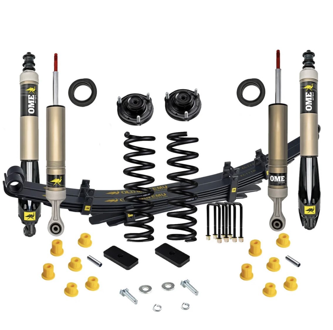

    OME MT64 Suspension
    I just had my MT64s installed today and couldnt be happier with them. Obviously just a first impression still but very happy with on road comfort. Havent tried the 6112s but love my MT64s. just did an add a leaf in the back.
