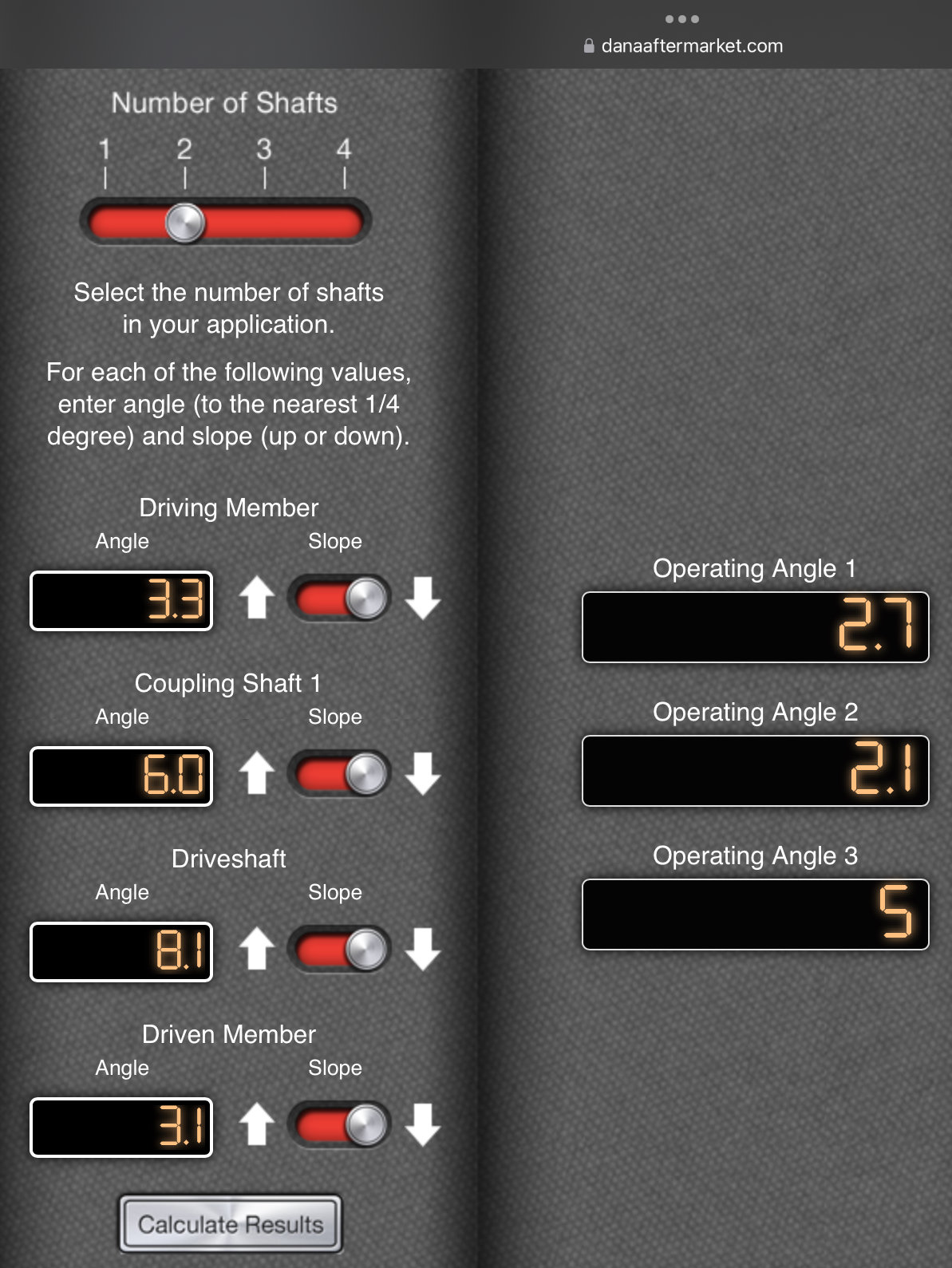

    North Texas
    '18 DCSB TRDOR Inferno
    New numbers with angles against true horizontal. Bumping up against uncertainties a little. If you figure the shift, I’m within about 0.2 degrees for the working angles compared to zeroing on the output flange.

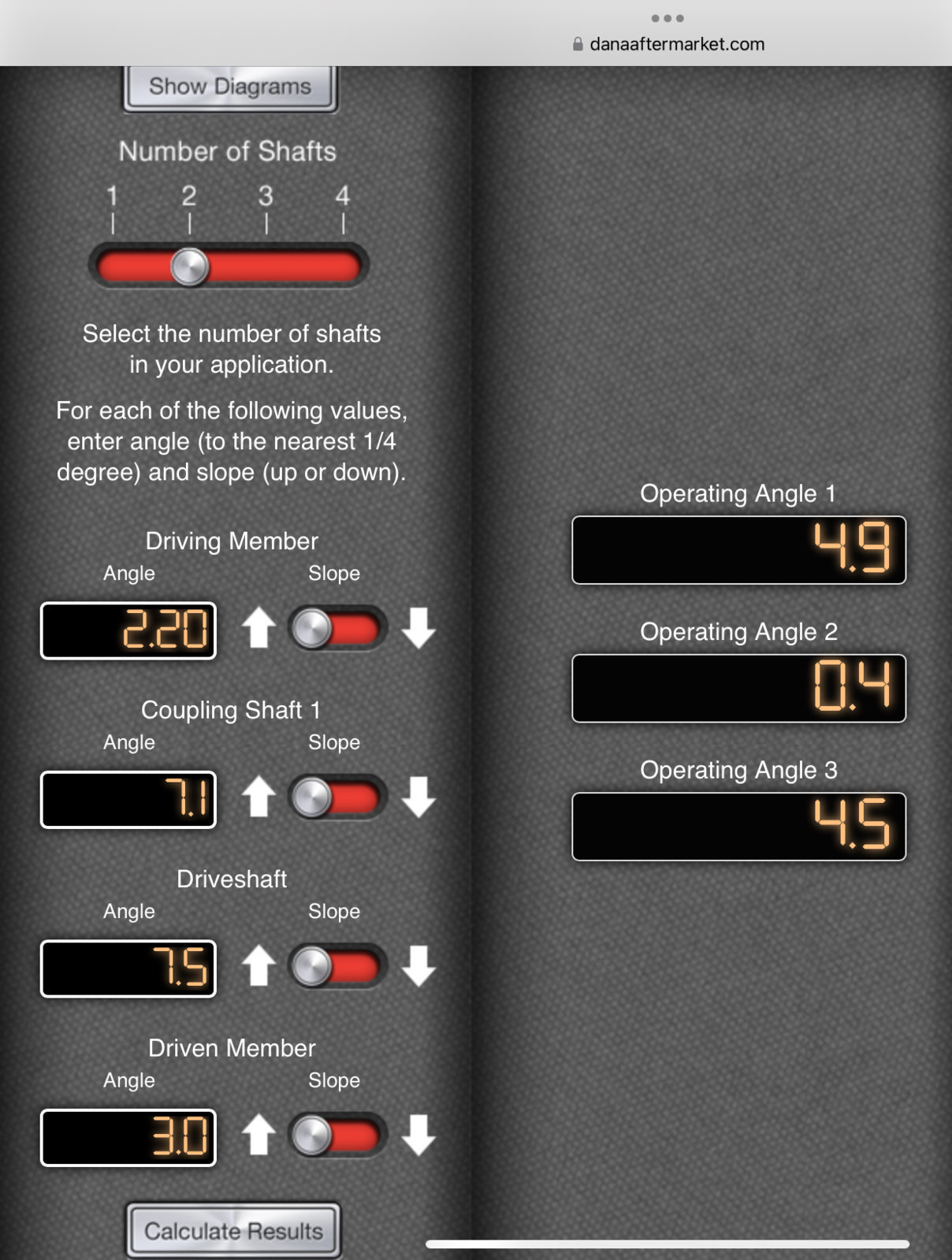

    Well, I went out and bought a small carpentry square to make sure I’m getting plumb measurements off the surfaces.
    Here’s a before and after I put in 3/8-1/2” of CB drop with some washers. I still don’t understand that high first working angle (yes, CB makes it a little worse). That’s something that seems pretty high to start with. Still have some vibration after the CB drop, it I’ll drive it for a few days to get a sense of how it’s changed. I could probably get 2-3 degrees of axle shim in there and reduce the overall angles, but that’s more lift. :(
    I also took some measurements for what the resulting lift was. I’m about an inc( over what I was hoping for.
    Front R/L: 2 3/16”, 2 5/16”
    Rear R/L: 2 5/16”, 2 7/16”
    Distance from the ground on 45k miles of 265/75/16s. This was measured with a laser for consistency.
    Front R/L: 36 11/16”, 36 9/16”
    Rear R/L: 38 3/16”, 38 4/16”
    Calculated rake.
    Rake R/L: 1 8/16”, 1 11/16”
    I’m not sure what the stock rake is out of the factory, But I’m sure I’d lost a fair amount of it. I think I recall stock rake being about 1”?

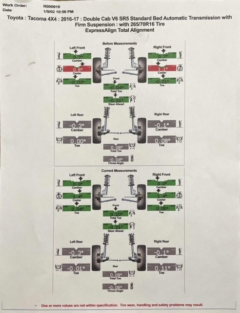

    Alignment done recently with Tandem Offroad.

    3" ToyTec coilovers, JBA UCA's, Bilstein 5100's
    Sure would have been nice if caster was at the higher end.
    RushT[QUOTED][OP] likes this.
  8. Jan 20, 2024 at 12:15 PM
    #28
    RushT
    RushT [OP] Amateur Everythingist
    Dec 10, 2017
    #238171
    5,664
    North Texas
    Yep… they sort of said: “Three letters bro, UCA”. They were pretty sure I could get in spec with some aftermarket control arms. I’ll hold off on that for a bit. It all adds up. :). Front end is just a bit more twitchy, but still completely tolerable.
