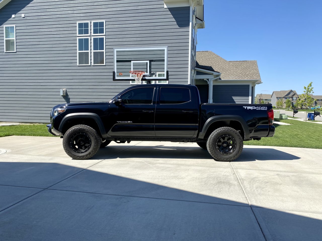

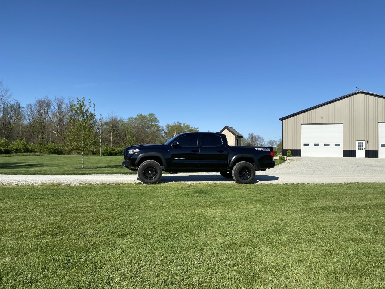

    This is mine on 3/4 with stock leafs and 5160s, pretty dang level. I have a Wheelers 3 leaf AAL that I will install at some point and bump up to 4/5. With that I hope to get some rake back and will bump up to a 285 tire. I’m almost tempted to try the AAL now and see how it looks on 3/4.
    7397BF41-9519-4102-832B-EE19F4F079BA.jpg 57A2FF4E-4E8D-4F58-A40A-C9906684B496.jpg

    Looking good. Hell Yeah why not! Give it a shot
