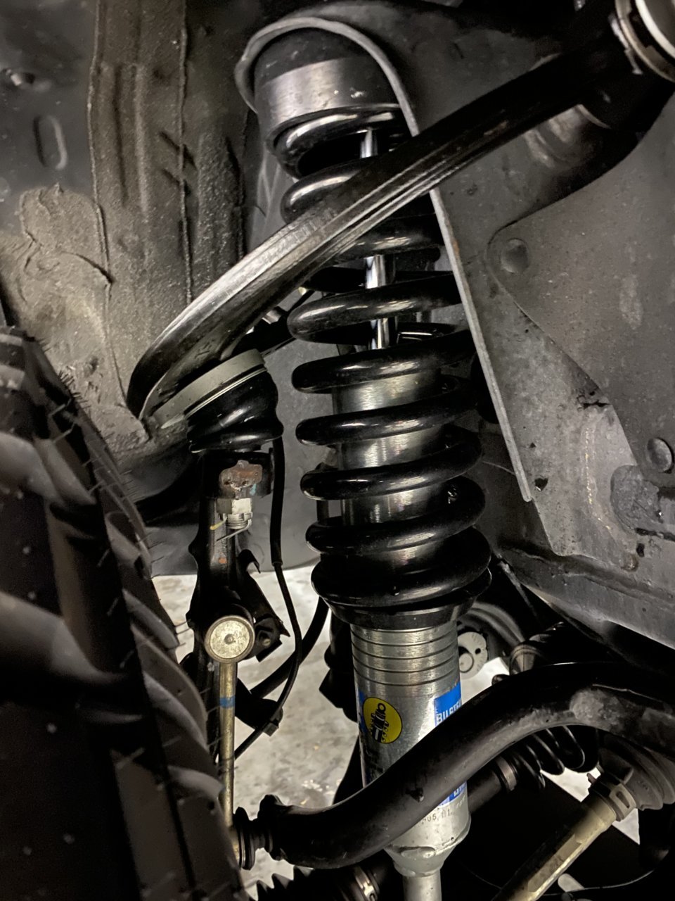

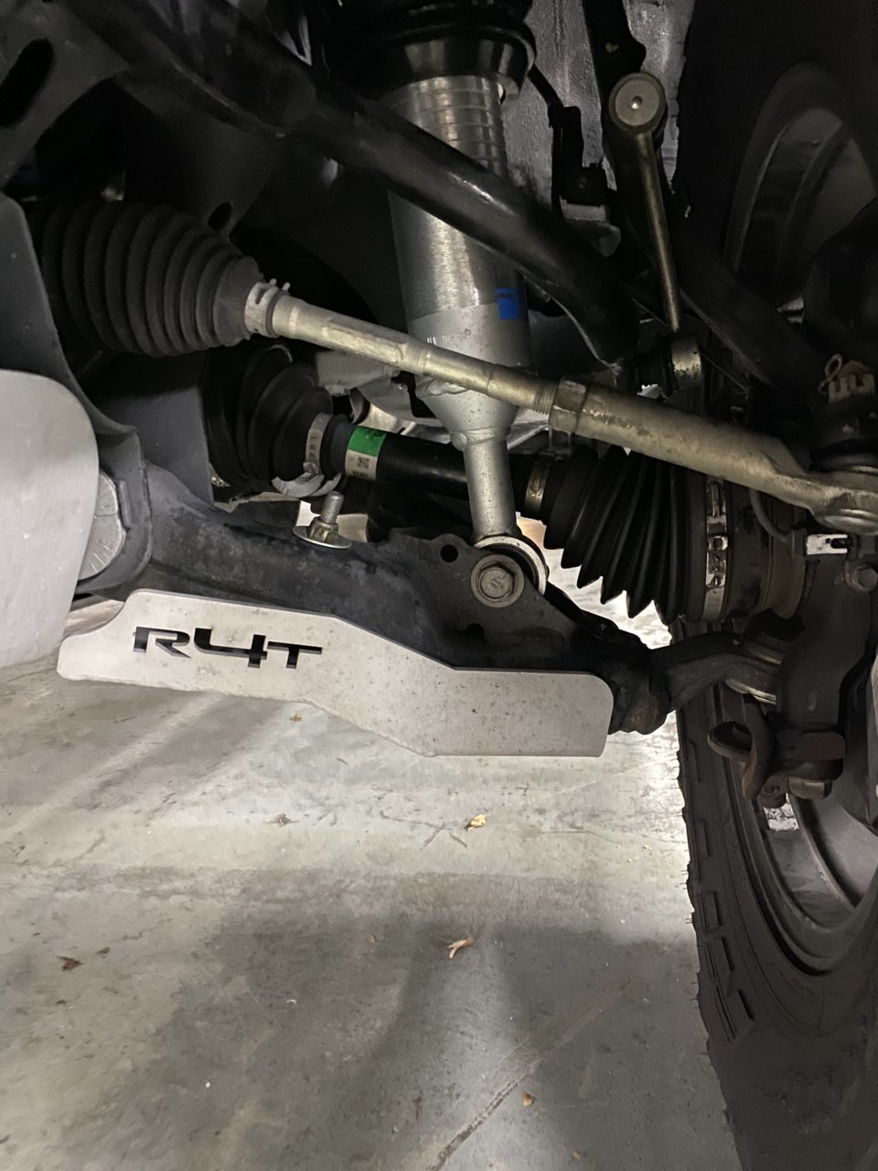

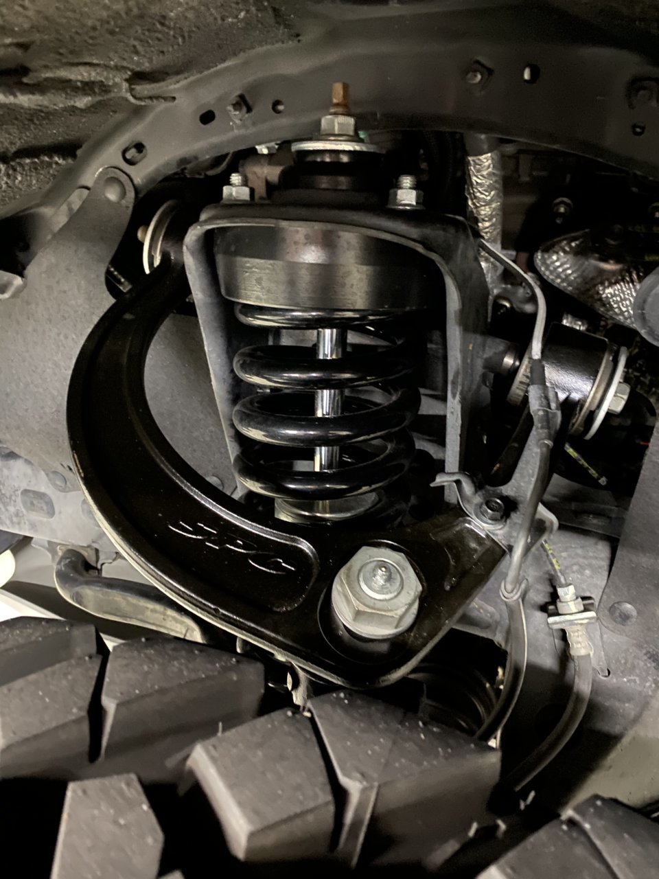

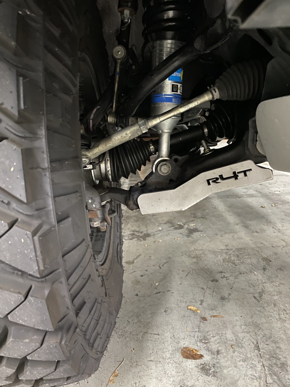

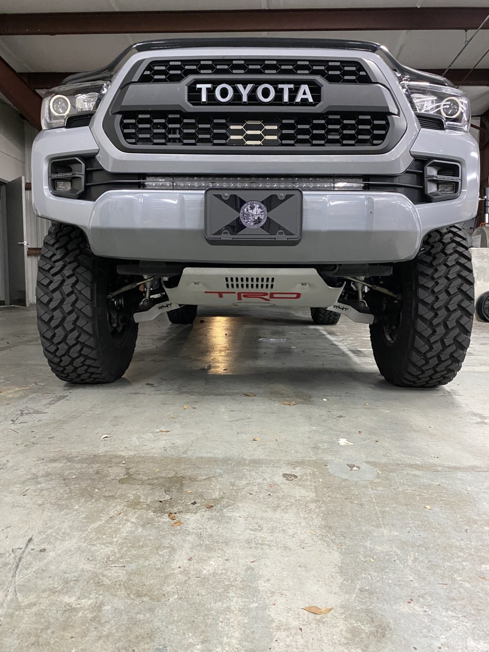

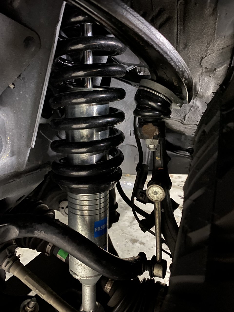

    I tried to get a few pics here. I also rocked the truck side to side with my hands on top of the fender on each side and the driver side seemed to have a little more movement. Will be home in about 20 minutes or so to measure center of hub to fender

    approximately 25in from center of hub to fender. don't have a clue what stock is or what is good. the small, quick chatter is where they seem really stiff. bigger dips or bumps are better. it feels like there's too much rebound

    Kings 2.5” front and rears from Accutune / ICON RXT LEAF PACK black badges doors and tailgate / method 315 / 255/85/16 Yokohama G003 / magnaflow exhaust , axle dump / meso int delete kit / meso led map lights / dome lights / wheelers front super bumps / accutune Flip kit with spacer and new bumps / Cali raised fog light pods / Cali raised ditch lights / RCI FULL SKIDS / SLIDERS / RCI rear bumper / rigid backup lights / tuned on 4.88’s
    I’m at 23 1/2” hub to fender front 6/5 setting on 32” tires

    So that Readylift top hat must be giving a little more lift than it advertises... ugh kinda of a pain but i guess i might have to take them out and lower the clip settings. their website advertises that it comes pre-assembled at 3in of lift and both are set at 6. wondering if that combination just doesnt allow enough compression with the weight of the vehicle and the shock is just riding nearly all the way extended

    More lift is not always good. IMO that’s why I stuck with Bilstein’s recommended settings and pear with appropriate coil. Your CV angles look real tight as well to me.

    I appreciate it. i had a 3in spacer lift on the stock sport shocks before these and i definitely think this is higher in the front than before. Having some work done on the truck soon so when its on the lift ill probably go ahead and do that at the same time cause im pretty sure the guy has a spring compressor.
