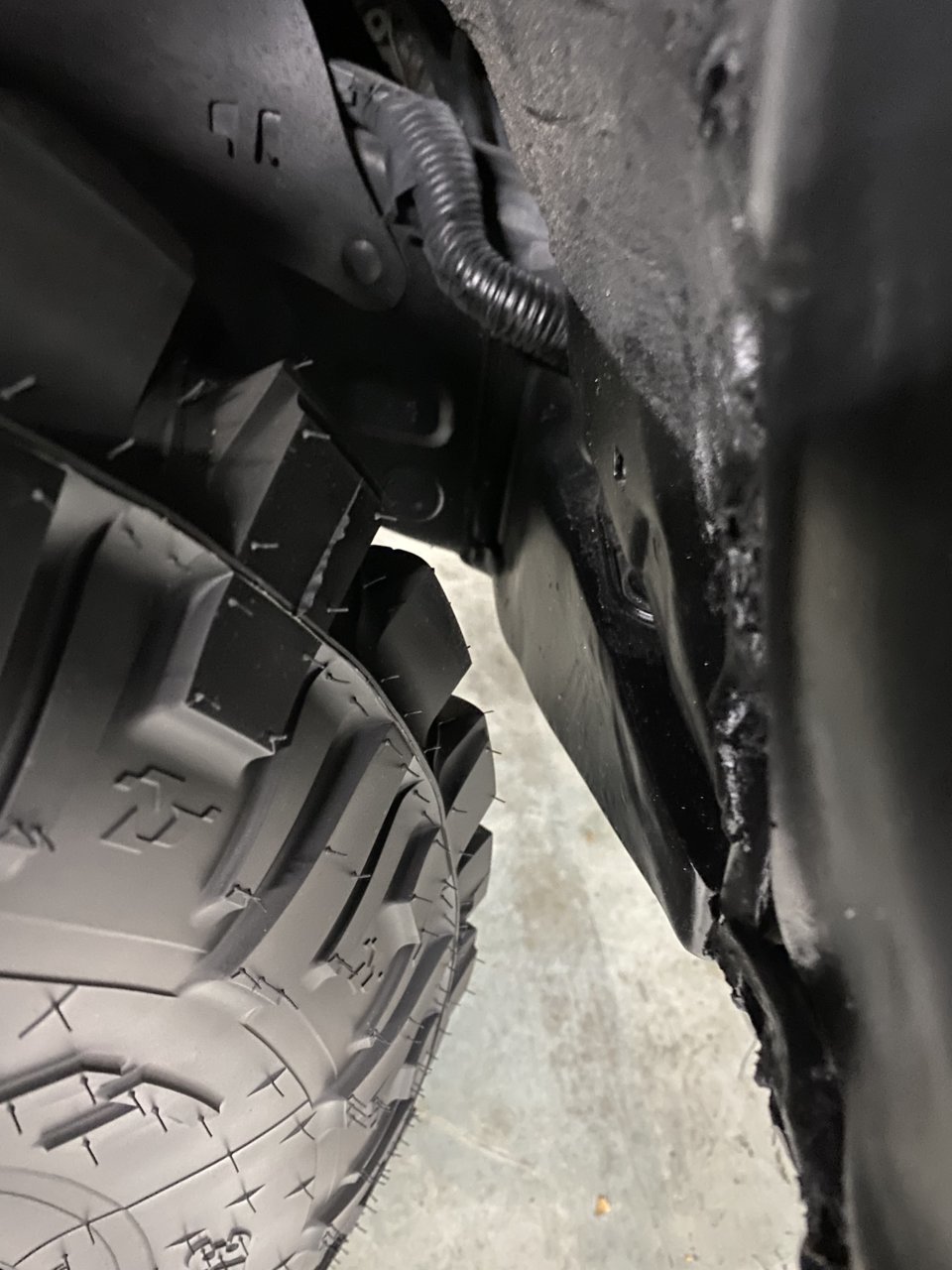

    LCA's maxed all the way forward. SPC UCA's set to setting F. Viper cut on front bumper and CMC, pinch weld hammered and minor trimming on bottom of fender on cab side. i do have a CMR ordered for more peace of mind but everything clears pretty well right now with no issues. wheels are 17x8.5 -10 offset SCS F5's. caster is 1.7/2.0

    this is wheel fully locked on flat ground with the setup I just mentioned

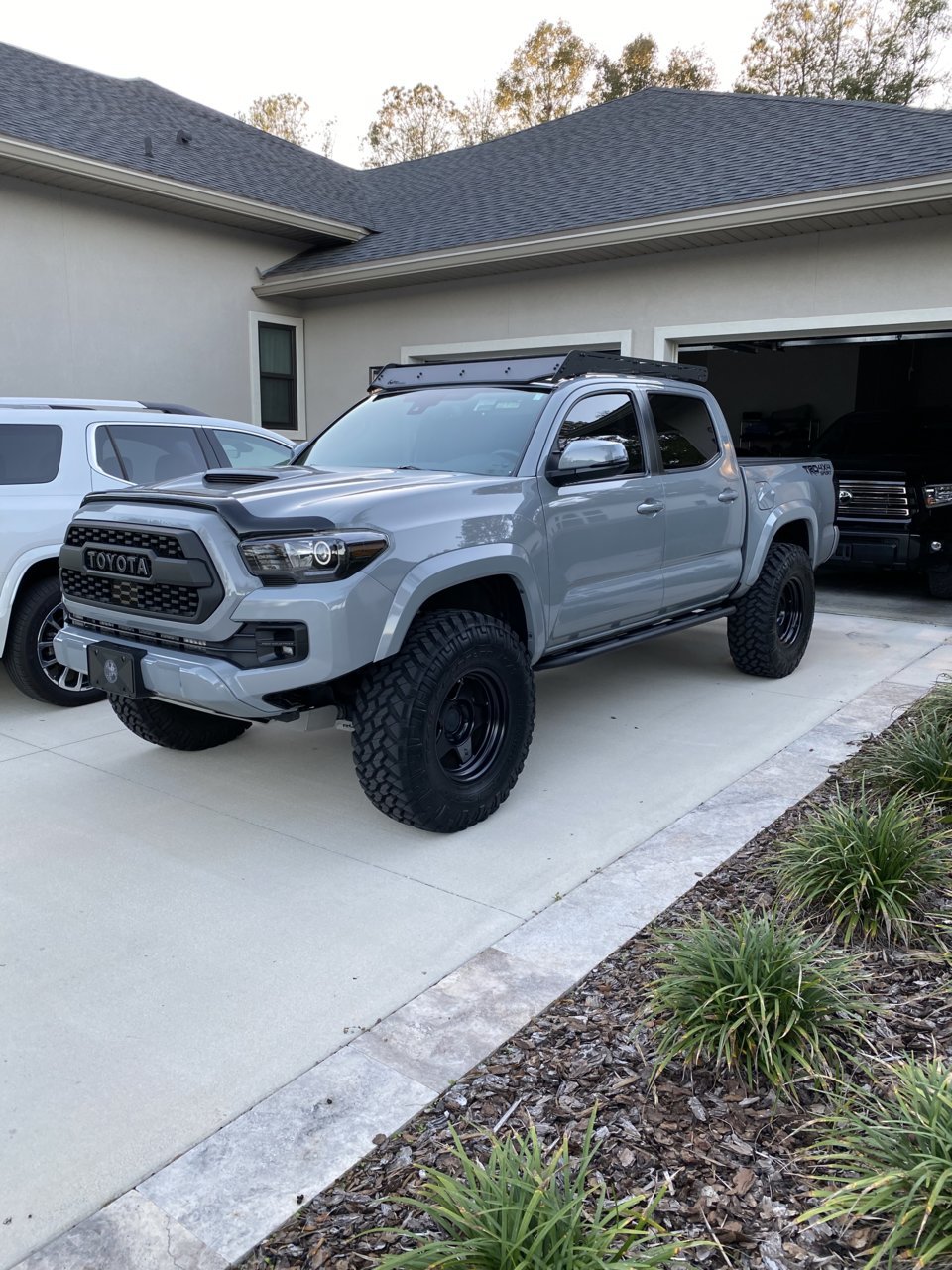

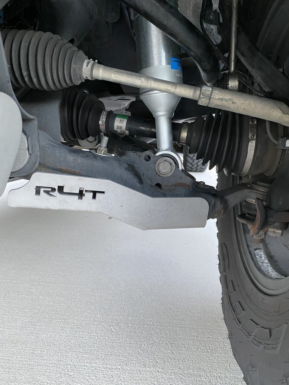

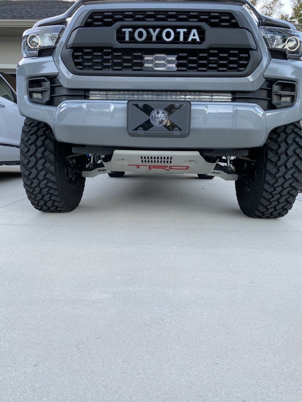

    Update for anyone that’s following or was curious…. Got the 6112’s set up with regular top hats set at 6/5 clip settings and I’m speechless. It’s like I’m riding on clouds and is so much better. I’m convinced that Readylift must have miscalculated how much lift their setup caused. CV’s look to be muuuuuuuuuchhhh happier and the stance of the truck looks way better than before. Definitely was squatted before. Thank you everyone that gave input in helping me out.
