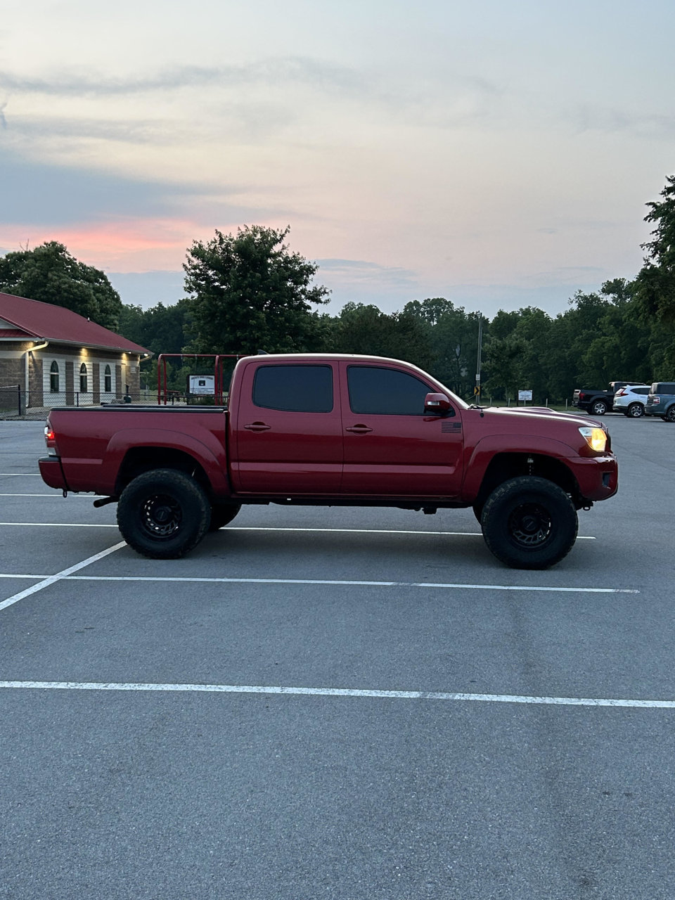

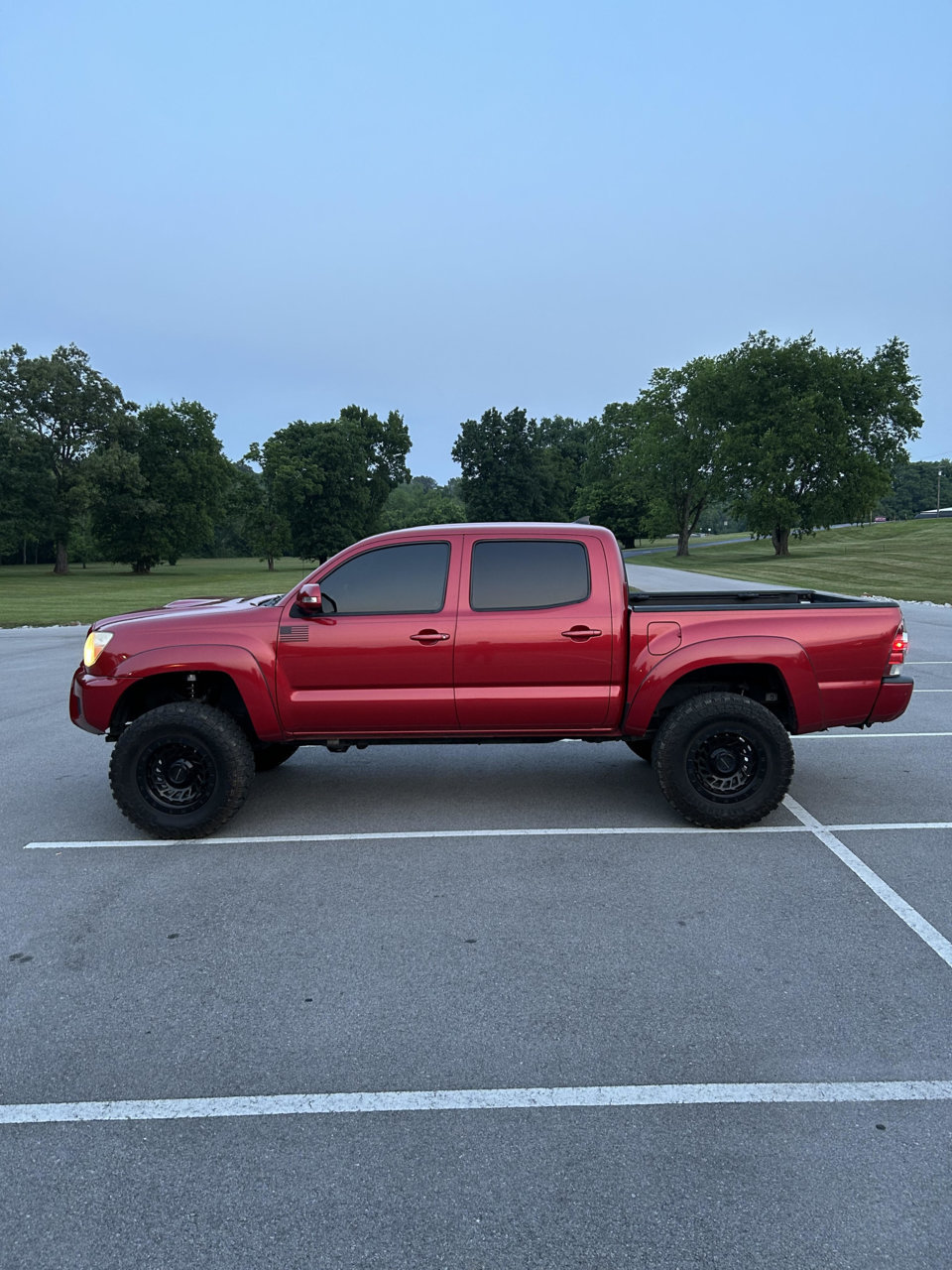

    Just got a new ready lift bilstein 6112 lift kit put on today as well as a body mount chop, and I absolutely love the performance of these new shocks. However, my front now sits about an inch higher than my rear, and i prefer a more slightly raked look. Would a 1.5 inch AAL get me where i want to be?

    I would wait at least a thousand miles and see if the front end settles a little bit for you

    good point, i shall wait a bit for sure.
