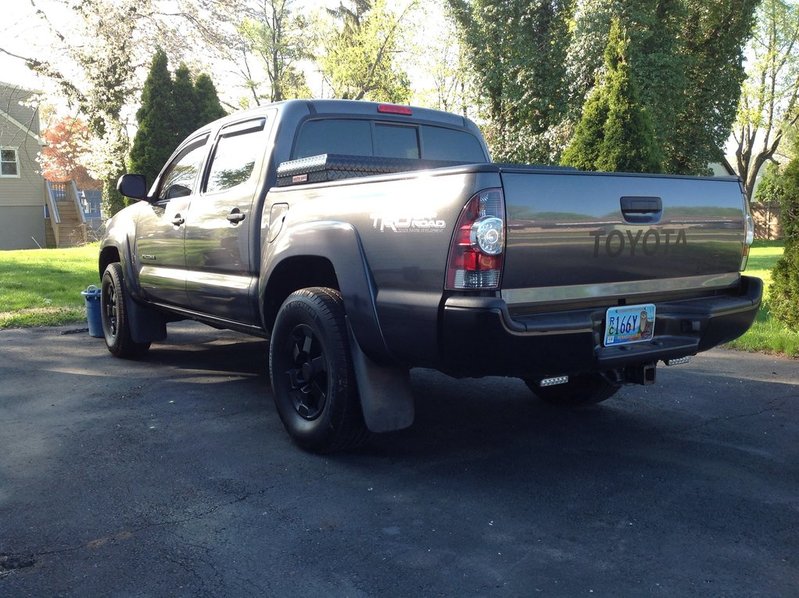

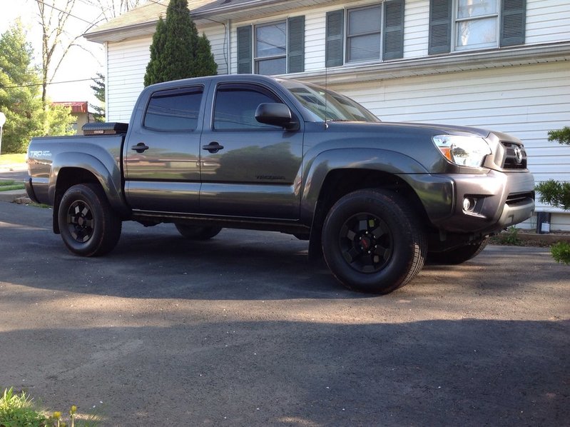

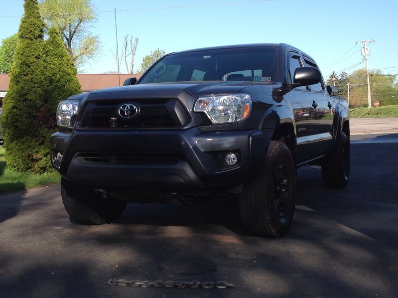

    To the OP - any more pics? I'm trying to decide if I want to keep mine at the 2nd notch, or drop to the 1st.

    image.jpg image.jpg image.jpg Think it sits nice on first notch

    I'd like to see pics on the 2nd notch.
