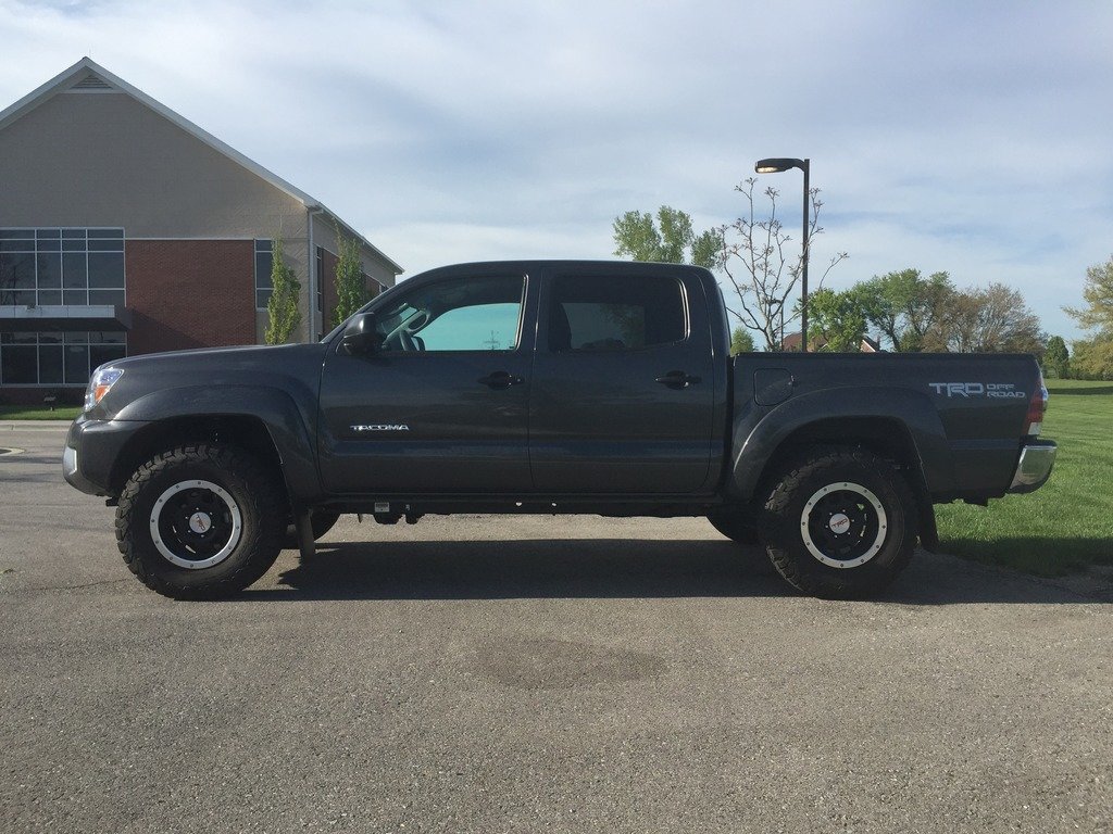

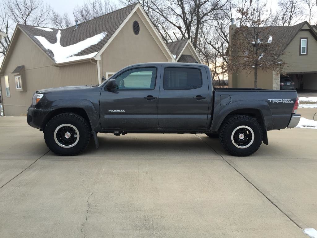

    The more I drive it, the more I think I'm going to leave it on the 2nd notch. The bro lean is minimal at best, and I'm already getting compliments on the truck from random people.
    Ask and ye shall receive. :D
    Before:
    and After: (2nd notch)
