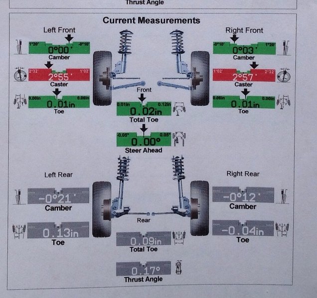

    How'd this ever shake out OP?
  3. Jun 23, 2015 at 1:54 AM
    #83
    markc6606
    markc6606 [OP] Well-Known Member
    Feb 17, 2010
    #31542
    309
    SoFlo
    '13 Off-Road
    It was an alignment issue. All is good now. Still liking the ride with these shocks. These numbers made ALL the difference.image.jpg
