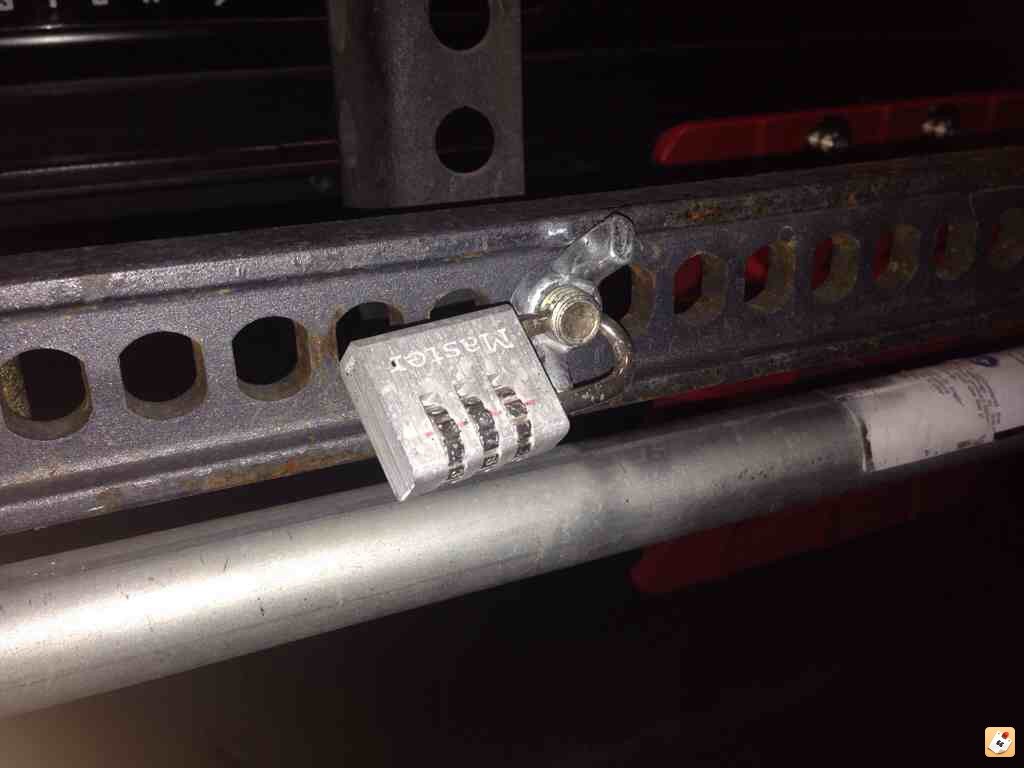

    On another note I need to find some bolts that have a hole in them so I can put a lock through them for the maxtrax's. Any ideas?

    Have the bolts come up thru the lid of the box use wing nuts to hold them down. Drill thru the end of the bolt to be able to put a lock on it. I'll post a pic of how I did mine for my HiLift

    Pic of hi lift lock on my truck.

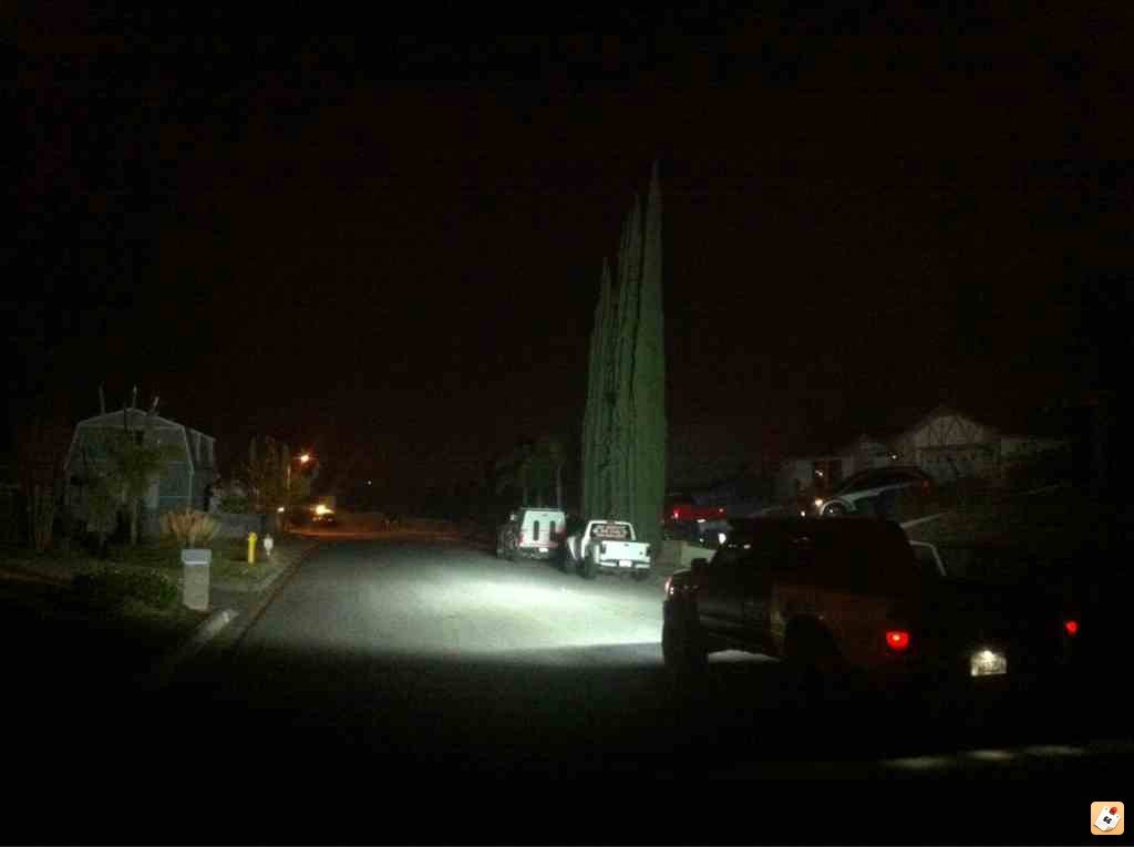

    50" Chinese led bar

    What about the threads on the bolt? Did the drilling mess them up?

    Hole should be fine with a coarse thread. I've used hardware like that before with a grease zerk on the end and holes throughout it.

    Here's what I did. First drill thru a nut your going to use that as a guide thru the bolt. Run a nut down the bolt first then run down the nut u drilled out to where u want the hole. Drill it. Now when you run the nuts off it will clean the threads up some. It would be good with a fine thread if u do my method.

    Sweet brotha thanks man ill try that out this week :thumbsup:
