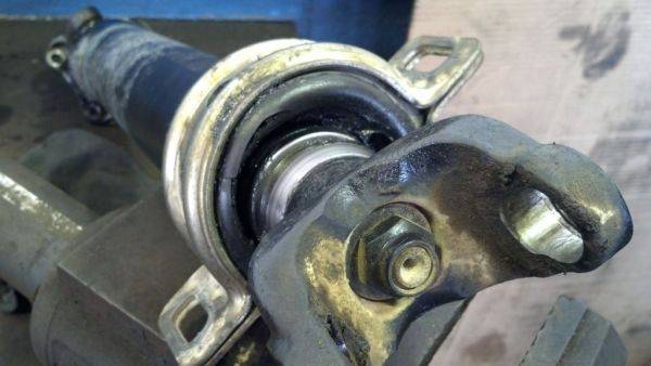

    Sure it's axle wrap?
    Could be just the carrier bearing all loosey goosey and wandering everywhere such as mine did prior to it totally failing and grenading on me :mad:

    There is no adjustment on that sucker ...
    Eventually the rubber doughnut thingy separates from the actual bearing. Nothing you can do. And since the ujoint needs to be removed to gain access to the flange nut might as replace the ujoint(s) since it's a part anyways

    As for the vibrations, there's a few things it can be. I know when I replaced all 3 of my U-joints, it made a huge difference and got rid of my vibrations. It could also be the carrier bearing starting to go out. It's a structural piece that keeps the driveshaft from bending at the u joints and flapping around so that would surely cause a vibe. Could also be the wheels as Rodger stated. Have you gotten them balanced recently, you never know if a wheelweight could have possibly come off.

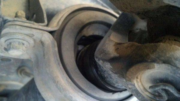

    Yeah i get them balanced nearly once a month in hopes of solving this. Ill inspect the CB to see if i can find any signs of wear. Anything in particular i should look for down there to know if it may need to be replaced?

    Tom, that rubber thingy seems alright on mine. No cracks or anything similar. Where'd you get u-joints and another CB?
