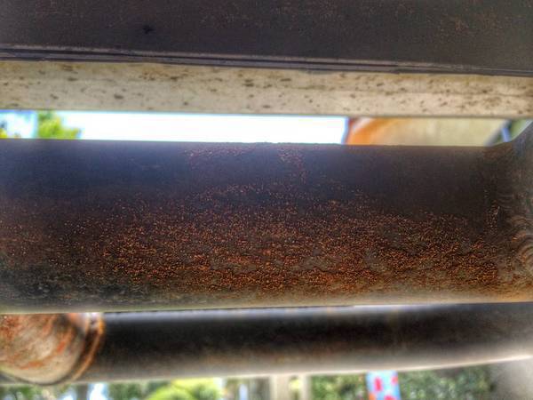

    3 days in Pismo and this is what salt water does.
    The sand just sticks to rust

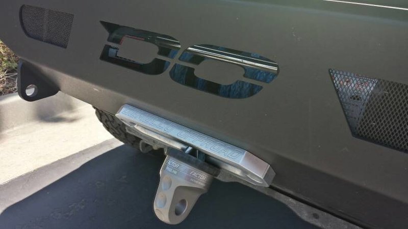

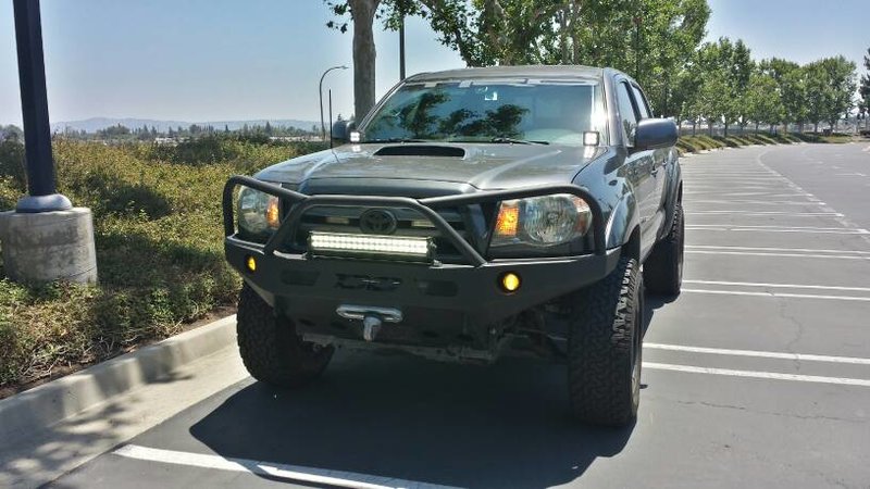

    Btw, the finished front end... still gotta replace the fairlead with a black one and repaint the led bar black. Also gonna install ny retros next week once i finish them up. Then will come the suspension isntall and lastly bigger tires. Have it all just gotta install it all lol
    uploadfromtaptalk1401135714366.jpguploadfromtaptalk1401135734249.jpguploadfromtaptalk1401135752753.jpg

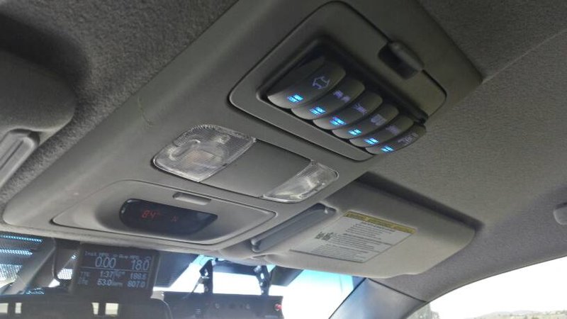

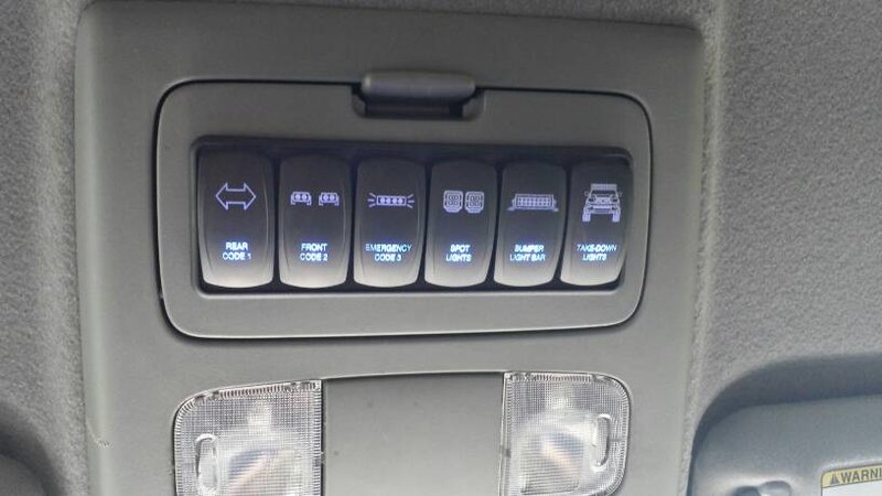

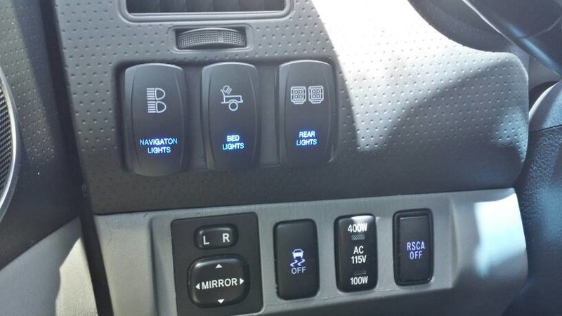

    And some more switches :)
    uploadfromtaptalk1401135867119.jpguploadfromtaptalk1401135883183.jpguploadfromtaptalk1401135898352.jpg

    But the 3 switches look good.

    So i know you just told me that you plan on replacing your OEM fog switch with a rocker like these. I learned somthing during install that I thought id share.... All of my switches i ordered have lower independent blue lights that come on with the dash lights and upper independent red leds that light only when the switch is on..... Well after install I noticed that the "navigation lights" switch that replaced the OEM fog switch would not light up red when the switch was on :confused: I thought I wired it backwards but come to find out that the oem switch is ground switched instead of 12v switch like normal. SOOO, you technically "can" rewire it all to work correctly, but I decided that since I drive with the fogs on all the time and dont want the red led on all day long and also this isnt a switch i can accidently leave on since it cuts off with the ignition, I decided to just leave it that way since it works better for me anyways.
    So long story short just keep in mind that unless you plan on a full rewire then just get a single "independent" led switch to match the dash. No need for 2 led switches for that one.

    yea I know...found that out with another truck. But good to post about it incase someone else doesn't
    I'll figure it out later lol

    Told you bro that place is crazy for rust on your truck pressure wash your truck like crazy!!!!!! Or grind it off and repaint it that's what I would do

    Looking good bro

    Im so :jellydance: lookin good :thumbsup:

    Yea. Didn't think it was going to be that bad. Just surface rust tho. I was under the truck washing yesterday, but can't get everything. Gonna do it again tonight.
